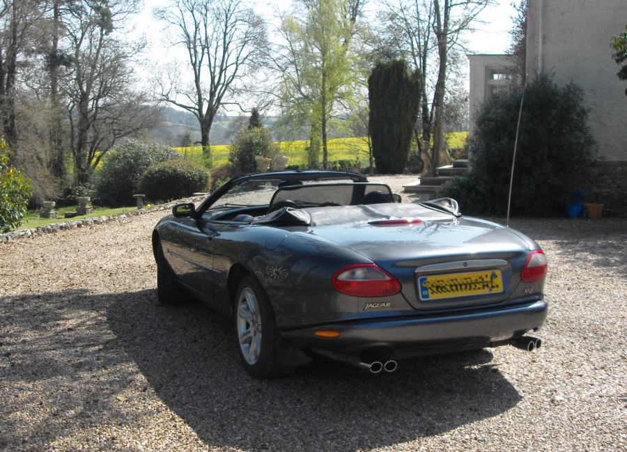

Re Paul's post ............
97 XKR/XK8 History question.-rear-pic.jpg
Jeff - You have a beautiful car - enjoy. Perhaps more so in the US, but even here in the UK, many owners with early (97/98/99) cars have taken great care, and gone to quite some expense, to "improve" the looks and/or specification of their cars. Mine - a 1997 car - has 'modified' exhausts, a 'modified' grille (several hundred pounds), the 'modified' rear boot plinth, and a few other small things to make it just a bit different and "unique". None of that is in the service history / maintenance record.
Any previous owner who has gone to the time / trouble / expense of doing what has been done to your car has probably treated it well so apart from checking tensioners, cooling system, hoses etc (just do a search) - you probably have a car which will keep its value, and give you many miles of great fun.
But ............. it's a 4.0 naturally aspirated XK8 not a supercharged XKR

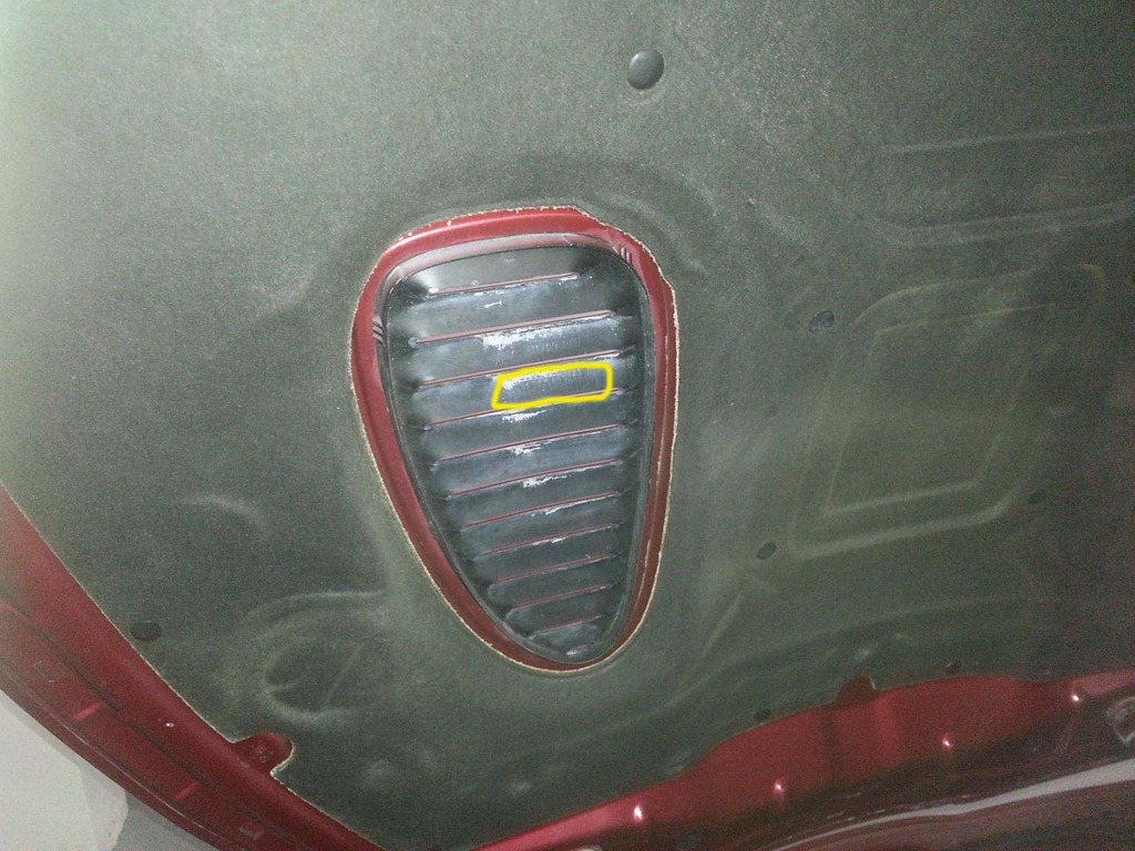

Here is an easy way to get some evidence of the manufacture date of the XKR grill, which could help settle what is going on here.
Look at the latest date marked in the manufacture date record on the underside of the grill on the hood.
I am not sure where to look. Here is the underside of the hood. Nothing there and the front grill? I know how to drive but I am not nearly as versed in other things. I guess I need more direction?
Here is mine:
The latest dot in the table indicates that my grill was manufactured in March, 2000.

You are going to need to get close to the area circled in yellow with a bright light to see the table and the embossed dots.

Look at the fourth vent from the top on the back I can see the date code is there. but can't read it. I agree with all of the others that the PO added these options after it left the factory In all of the books written about the XK-8 and XKR there is no mention of any prototypes such as yours. The prototypes that are mentioned Jaguar listed all of them. I'm not at home and I can't check right now but I think they list the vin #'s. The British market received these vehicles a year earlier than state side.
Here is the engraving....hopefully you can read it and tell me what it says. I'm feeling more and more like, as everyone has said, this car has had numerous modifications. That is certainly alright by me as the beauty of this car and the way it looks and rides was the reason I chose it over numerous others available. It appears the PO put a lot of love and money into this car to make it look as it does and I'm happy with that. THANK YOU EVERYONE for educating me. The frustrating thing is what the 2 dealers had told me.....that nothing had been changed. That obviously was the opinions of 2 who did not really even care. I have been a Cadillac enthusiast for many years and we

hard to see in the photo but the date code looks like an April 2000 to me.
