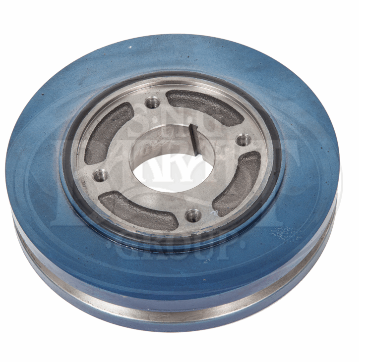

SNG and Martin Robey advise the correct damper is EAC4050 unfortunately it is no longer available anywhere. To make part identification more difficult none of the dampers ever had a part number on them. Here is a picture of the correct damper supplied by SNG. ( Richard Liggett identified the original damper correctly as C27295 however it was superseded by EAC4050 neither of which are available).
balancer1742×731 203 KB
Unfortunately it does not show the location of the timing marks relative to the keyway…

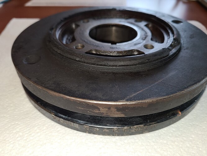

MIke Spoelker was kind enough to send me a damper that very closely resembles the SNG photo. You can see that the location of the keyway is directly opposite the timing marks.
IMG_37593024×4032 1.95 MB

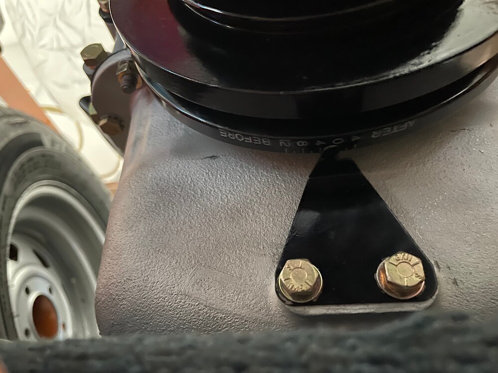

Meanwhile Paul Novak posted photos of the balancer he took off his 69 2+2 with AC.
Note that the damper looks similar to the SNG photo and the damper supplied by Mike and in his picture the keyway is also aligned right over the timing marks. Paul also shows it reads off the timing pointer mounted on the bottom of the sump.

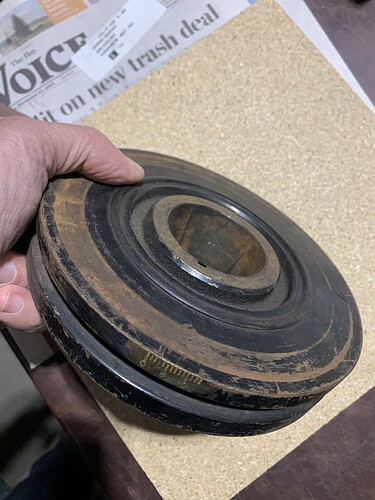

Denis Donohue also posted a picture of his late series 2 OTS, no AC car. His pointer is also at 6 on the sump. So this is now showing both AC and non AC cars with the same pointer location. (Note his engine # is 7R10633 vs mine# 7R9760-9 Lastly David Chiahotny mentioned his 1970 no AC car has the pointer also at 6 and believes it to be original as he purchased.
balancer 4999×750 157 KB
