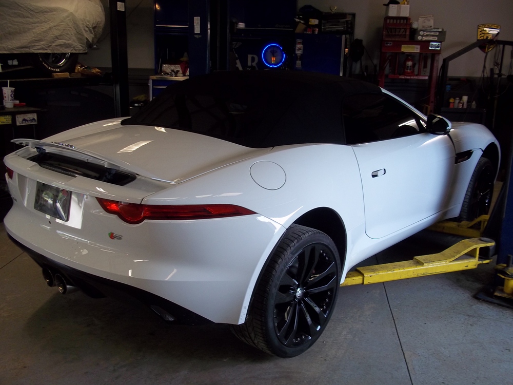

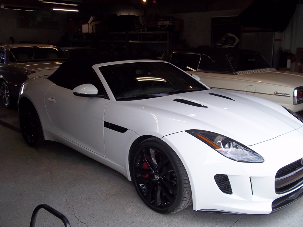

We just fitted our Stage 2 power package to this 2014 F-Type S 380bhp 3.0L. The owner did not want to dyno test the car (most do not), so the point of this thread is to show you what in involved in installing the lower pulley kit.
If anyone would like to talk with the car's owner, he is willing to talk on the phone. Just PM me.
-Package includes; Tuning, larger crankshaft pulley kit, K&N air filters (this customer did not want, so they were subtracted). Car on 93 octane.
Mike
