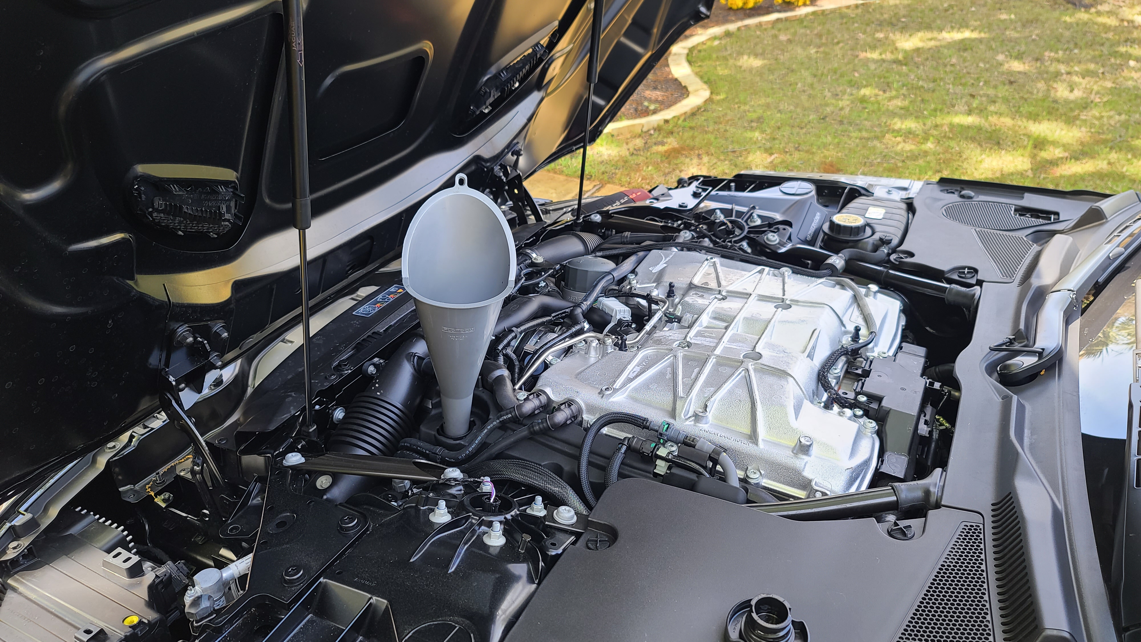

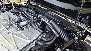

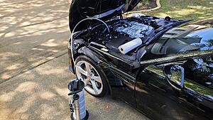

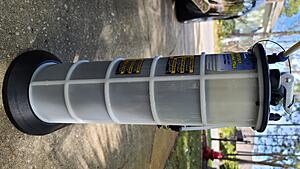

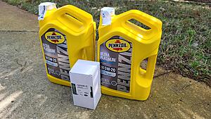

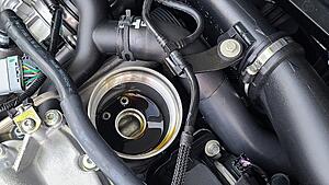

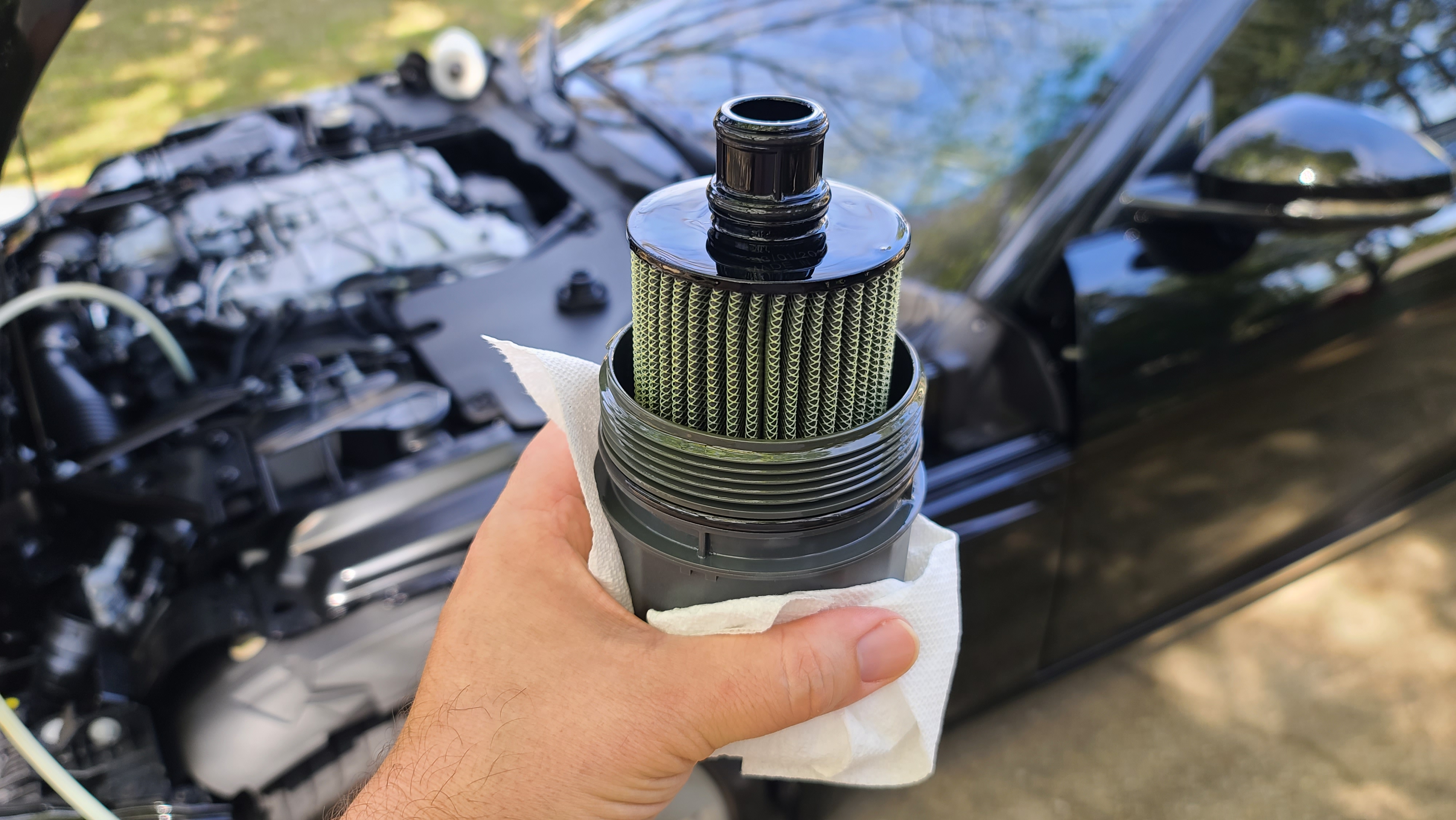

Hello,
Just wrapped up the 1st oil change on my '23. 1000 miles, two months after delivery, and about four months since the factory fill. It is a P450 and 7.5 Liters came out. Oil was darker than you would expect given the age and mileage. My cost was $85 for oil and filter. Here's some pics for those who may be interested in at-home oil changes:
Attached Thumbnails '23 F-Type - 1st Oil Change-20230304_114454.jpg   '23 F-Type - 1st Oil Change-20230304_114500.jpg   '23 F-Type - 1st Oil Change-20230304_114533.jpg   '23 F-Type - 1st Oil Change-20230304_114643.jpg   '23 F-Type - 1st Oil Change-20230304_114901.jpg

I see you used 5W-20 oil whereas the specced oil is 0W-20, if you have a serious engine or engine related problem you may have trouble with a warranty claim.
Yes, I know, lots of debate and millions of words written around "best" and "correct" weight engine oil for the AJ133SC among which there is a school of thought that 0W-20 is too thin especially in a hot climate (such as Florida) and 5W-20 would be marginally better, just sayin' about a potential warranty claim issue.

Thanks and I had debated going 0W20 vs 5W20. As you mentioned, where I live (Florida) and with the car always garaged it never sees temps below freezing, and really almost never is "cold started" below 50 deg F. I considered even going 10W30 for these warmer conditions but decided to wait until the warranty was up to run those slightly thicker weights.

Also just a reminder that oil does not meet Jaguar specs for the vehicle, regardless of viscosity. It may not matter if you change more often than necessary, but just making you aware.
At the risk of instigating another lengthy discussion on engine oil
Has anyone EVER had JLR analyze engine oil after an engine failure?
Our '14 says to use 5W-20 on the cap.
And, the Pennzoil Ultra meets the specs that were in effect at the time of the car's introduction.
Besides, our yearly oil change happens when the oil is only 2 - 4K miles old.
I'm sure that JLR hasn't changed any engine specs that significantly require the new specs they publish. Sure, if run to the 16,000 mile OCI that JLR recommend, you might need some enhanced wear capabilities.

I also did my own oil change at about 1250 miles on my 2021 F Type R. I didn't want to wait until a year was up to have the dealer do the first change for free under the warranty. I also used a Mityvac which was a pleasure after about 50 years of crawling around under my vehicles to do oil changes the traditional way.
I bought the specified Castrol Edge Professional EC5 0W-20 oil at the dealership and bought the filter online. The cost at that time was around $120 for the materials. I live in the Southern California mountains and the temperatures rarely drop below about 20 degrees F and I don't drive my Jag in those conditions anyway. However in the summer, temperatures can exceed 110 degrees F, especially if crossing the desert regions. But I'm sticking with what JLR says regarding the oil, at least while still under warranty.
One thing of note, I did have a Blackstone oil analysis done on a sample of that oil from the first change. They noted a high titanium content compared to averages and a much lower molybdenum content than averages. I was surprised by this, especially the moly reading. The Castrol Edge Professional EC5 formula is specially blended by Castrol for JLR. They must have a reason for their formula regarding the titanium and moly. The current (as of 2018) spec for the oil is STJLR.03.5006. I believe only a couple of oils will meet that specification.
Will your engine grenade if you don't use the specified oil ? Probably not. But I'll stick with what the JLR engineers say on my $120k car.

Thank you for the great photos! How messy is taking the filter off/out? Is the filter 'wrench' you used that 90mm 3/8 inch one from Amazon? any issues removing the filter?
calviroman (03-05-2023)
Old 03-05-2023, 12:06 PM
calviroman's Avatar
Join Date: Jun 2012
Location: Destin, Florida, USA
Posts: 75
Received 20 Likes on 12 Posts
The filter cap assembly is very easy to remove with the tool and a 3/8 ratchet. Here's the one I have, $9 on Amazon. You could also do it with a strap wrench or even an old school oil filter tool, though having this special tool is easier. The job is not messy at all, the filter cartridge clips onto the filter cap assembly and so just lifts up after you unthread the cap.
Amazon link: https://a.co/d/64PpvP8

A few tips for removing the filter:
- When removing the filter element cap, unscrew it 4 turns exactly at first. That will "break the seal" of the O ring enough that the oil will drain from the filter more completely and back down into the sump where the Mityvac will extract it. After a half hour or so, you can continue to remove the filter. If you unscrew it more than 4 turns at first, some oil will leak around the top and down the side of the housing. Ask me how I know.
- After removing the old filter, pour a few ounces of fresh oil down into the bottom of the filter housing before lubing the O ring on the new filter, snapping it into the filter cap and installing it. This is the equivalent of "pre-filling" a conventional spin on filter to help minimize dry starts after a oil & filter change.
- You should use a good quality torque wrench to reinstall the filter cap. Torque to 25 Nm or convert to 17.7 ft/lbs. I bought a digital readout torque wrench that measures in the range from 0-50 ft/lbs and the reading can be changed with the press of a button. If you are trying to get accurate low value torque measurements with a torque wrench that is designed to go up to or above 100 ft lbs for torqueing lug nuts for example, you won't get an accurate measurement at the lower ranges. It is also useful on other vehicles that have a conventional drain plug that should be torqued or installing spark plugs, etc.

The Mityvac 8mm 'tube' fits snugly over the 'straw' underneath the oil filler cap.
You kinda have to pull and twist the old filter to get it out. Look at the inside of the housing cap to check alignment for the tabs on the new filter.
