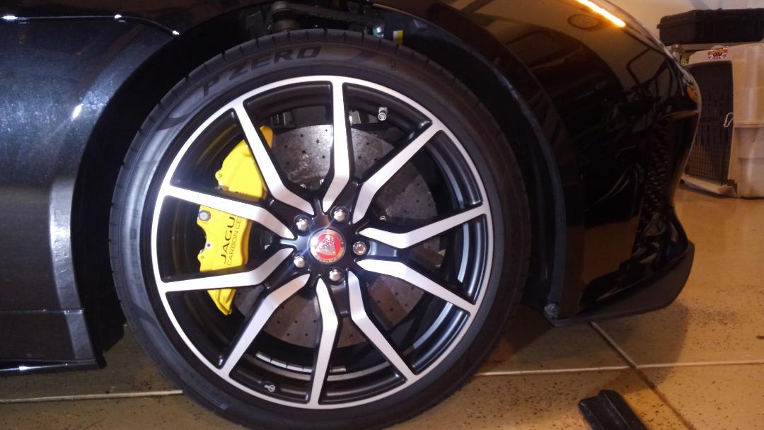

I have a 2017 SVR (305s and 265s stock).
I plan on ordering the Velocity AP springs.
I measured 14mm front and 18mm rear space.
Question: If I have 10mm hubcentric spacers made (Wheel Adapters, Wheel Spacers, Hub Rings, and much more! | Motorsport Tech), will there be enough thread left on the lugs to operate safely (I have heard 5.5-6 turns).
I would like to go with the maximum width spacer, not an adapter.
Thanks,

The rule of thumb I've heard is that the available thread should be at least one stud diameter. That allows about 6 mm-8mm of spacer.

[QUOTE=Unhingd;1783657]The rule of thumb I've heard is that the available thread should be at least one stud diameter. That allows about 6 mm-8mm of spacer.QUOTE]
Could I safely go with 10mm-12mm hubcentric spacers (not adapters), if I used extended thread "ET" lug nuts?
