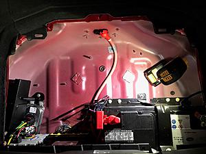

Default Here's where I'm going to connect mine...

Perfect. See how the positive can now fit through the cutout so you can close the plastic cover neatly.

Hoping someone can help. I opened the truck battery compartment and I could not find a similar layout to the previous posted responses (see photos). I have a new 2017 F-Type R with 700 miles on it. I read this forum and purchased a CTEK MUS 4.3 to get rid of the annoying "Battery Low - Start Engine Now" when I first get in the car. Any suggestions where to connect the wiring harness?

Appreciate the comments. Still confused how to connect the CTEK. The layout is different than the photos Foosh and amr42 posted. I don't see the box that contains the electrical bus bar to connect the positive. I looked on the owner info site, but didn't see any electrical schematics. Any suggestions where to look?

I hooked up mine similar to this but the positive wire i connected across the yellow wire. Is that fine?
Also, i noticed a couple sparks when i connected the positive terminal, and heard some clicking come from the trunk when i got the sparks. the car is charging fine now but i guess i'm just being paranoid and hoping for some reassurance that i didn't mess something up and that everything is fine.

Yes the yellow terminal will work but, the ring connector is a bit big for the yellow screw but perfect for the red as shown. Also, on the yellow, there is not enough slack to get the wire through the cut without the fuse getting in the way.
Should not be any sparks unless you shorted something and may have blown a fuse.

While you had the nut loose, you probably had an intermittent connection to whatever circuit is powered by the yellow wire, so minor sparks would be a possibility before it was tightened.

I assume this is a pigtail you're attaching, without the charger connected? If so, I wouldn't worry about it. It's been 4 years since I installed mine, so I don't recall if I got any sparks. But that bus bar is live, so sparks wouldn't surprise me.
