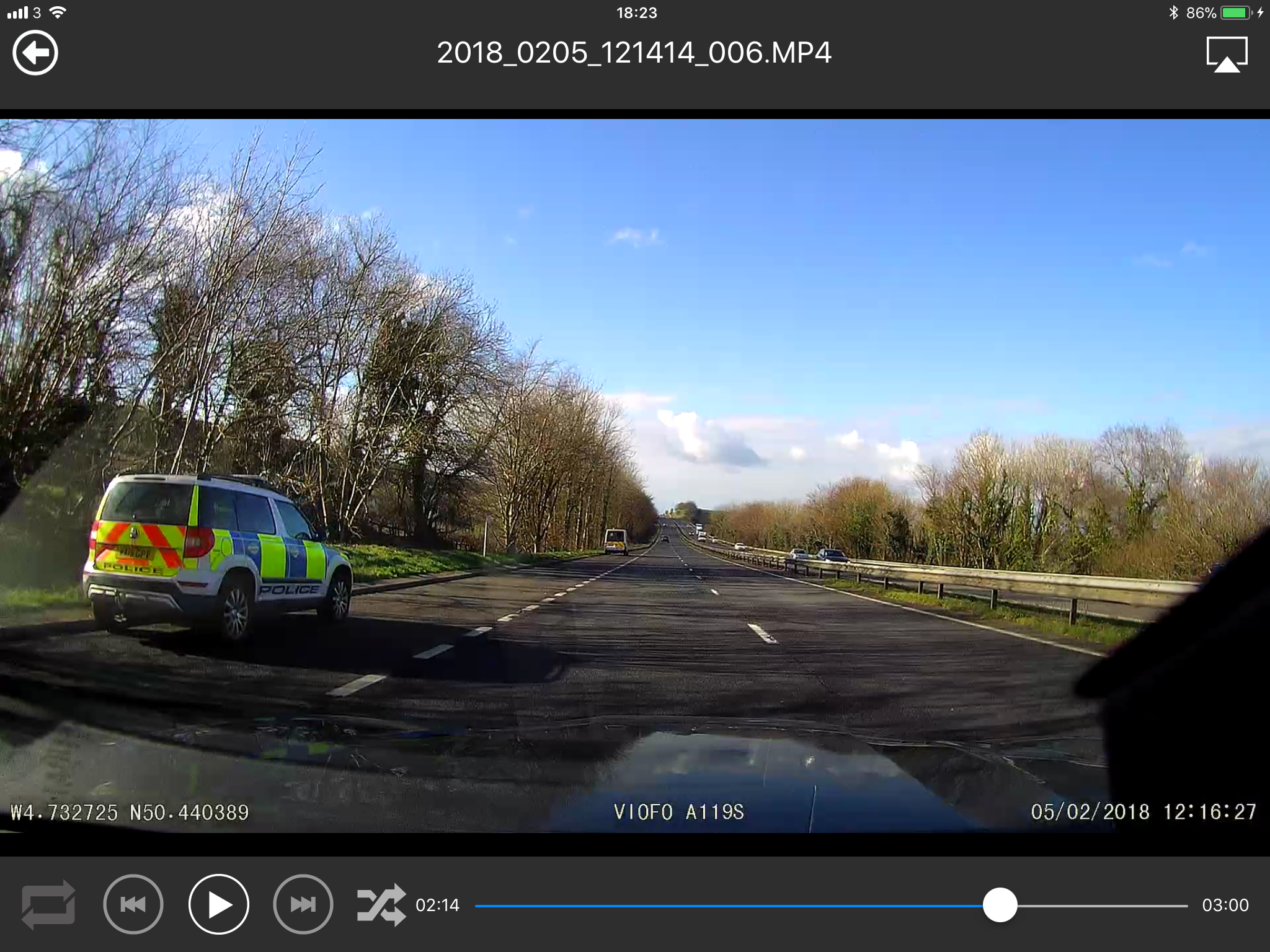

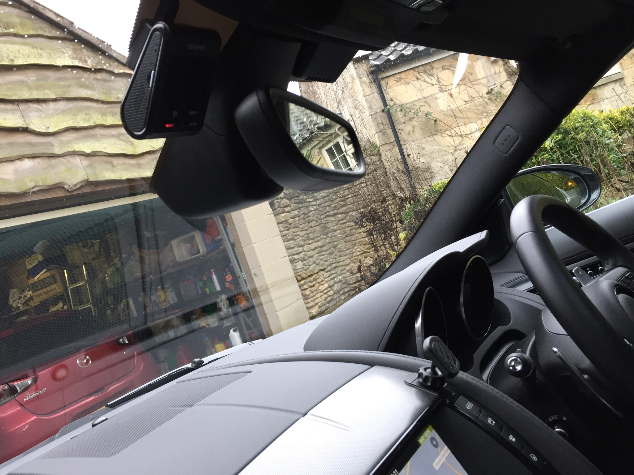

Just bought a Viofo 119S.
Basic dashcam but only $100 and has very good reports.
Fits very well with the F design, could almost be OEM !
Had it professionally installed.
Oh and thank you WAZE
Attached Thumbnails Best Dash Cams for F-Type-68221d84-e4b4-4223-bf46-996229e0c7bb.jpeg   Best Dash Cams for F-Type-4b186617-c01d-466c-964c-bb00d980ee57.jpeg   Best Dash Cams for F-Type-b8dde8ed-dce8-4704-b36d-89a34fdbacb3.png

You have to use the micro sd card but it’s not difficult. I bought a Lexar card and a Lexar micro sd to lightning connector plus downloaded the Lexar Mobile Manager app so I can view on my iPad/iPhone.
You can hide the speed data of you wish but read it on Dashcam Viewer or VLC for Windows or Apple.
Just to add that you can hide the speed data so that it’s not there when you just play back the card. When you use dashcam viewer the speed data and map can be viewed.
Lots of info on YouTube.

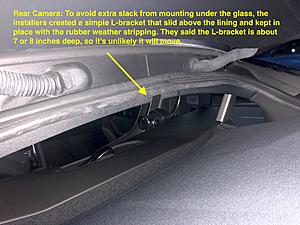

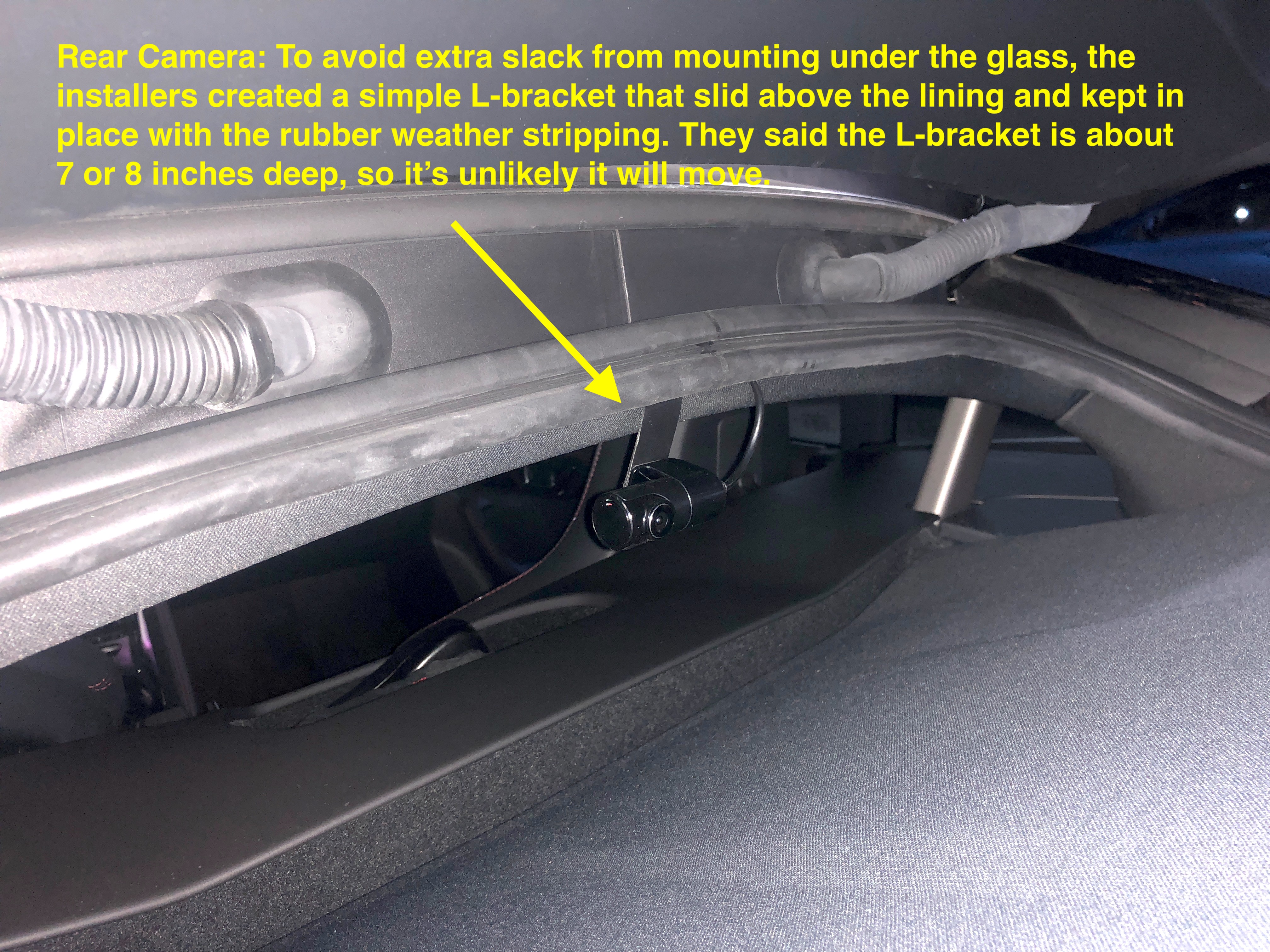

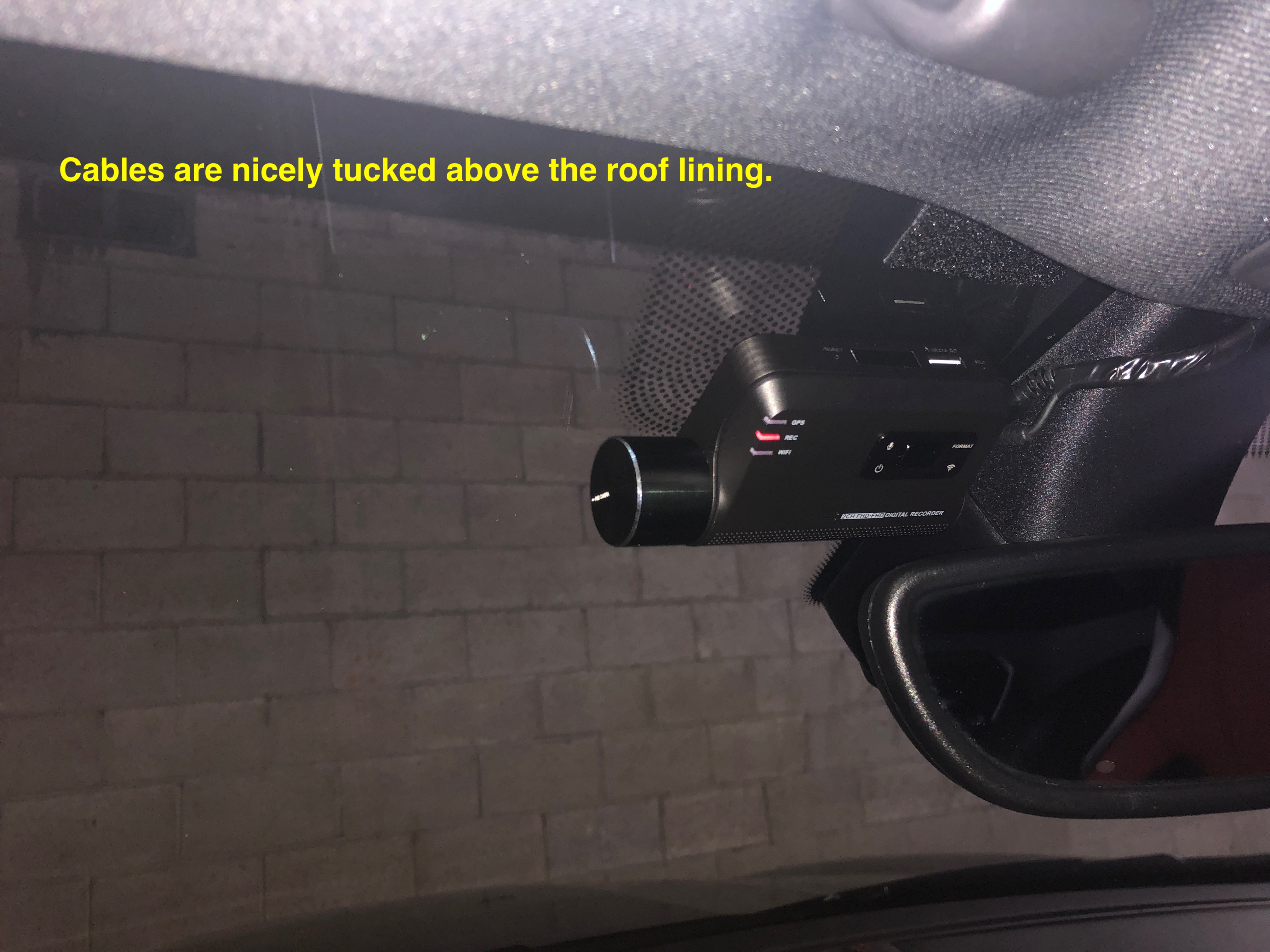

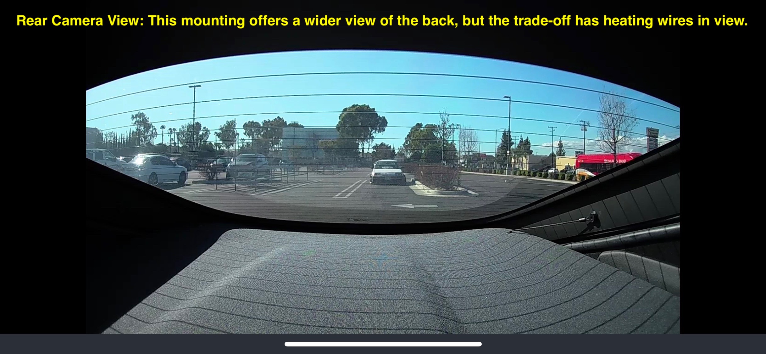

Default 😎 Sharing Dash Cam Installation Pics - Thinkware F800 Pro Dash Cam
Hi All --
Thought I would share some pics of the installation for my new Thinkware F800 Pro Dash Cam to help others considering the same. The F800 Pro is definitely one of the most expensive dash cams on the market (about $500 for front/rear camera package), but definitely the best, most full-featured, overall. My only critique is their file Cloud storage service and App, which is relatively new and a bit unintuitive. I'm hoping they'll improve this feature in the coming months.
After lots of online research, I opted to have a local car stereo shop handle installation for me (All Star Sound in Long Beach, CA). They quoted a very reasonable installation price and completed it in less then 90 minutes. They even figured out a more efficient way of mounting the Rear camera since there is so much "margin" space between the top edge of the hatchback glass window and the roof liner seam. Otherwise, this would leave extra cable slack that would hang down when the hatch was closed.
Meanwhile, all the cables are well hidden behind the moulding, etc. and it's hardwired for Accessory and Always-On (for parked video mode).
Hope this helps:
Attached Thumbnails Best Dash Cams for F-Type-00.jpg   Best Dash Cams for F-Type-000.jpg   Best Dash Cams for F-Type-1.jpg   Best Dash Cams for F-Type-2.jpg   Best Dash Cams for F-Type-2a.jpg
