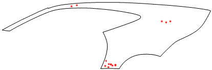

Direct from the Xpel website, this is the pattern for the left side rear quarter panel. This area of the F-Type is rarely filmed unless you are wrapping the entire vehicle...

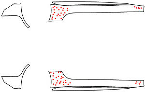

This is Xpel's pattern for the side Rockers, Sills below the Rockers, and the susceptible rear Fender area behind the rear wheel.
In addition to the typical Front Hood, Front Bumper, and Side View Mirror Covers, I have the Rockers, Sills, and partial Rear Fender done per the above pattern. There is an exposed film edge that cuts across the rear fender, but it does so in a manner that is barely visible unless you go out of your way to look for it.
As Unhingd stated, highly recommend this level of coverage at a minimum. Will prevent an abundance of road rash. I would however recommend you find an installer that cuts his own patterns from the roll, rather than order pre-cut patterns from Xpel, this is the trick for getting the edges wrapped wherever possible.

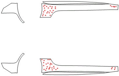

After a year and a half of nearly all sunny day driving, this is where most of my rash and chips are.
My dealer didn't wrap the full side rocker and it just gets shredded right in front of the rear wheel.
I've also caught a few rocks above the rear tire, in the beautiful curves of the rear haunches.
Lastly I got some big chips from a big stone above the passenger door. That is probably pretty rare as mine was caused by a blown fire hydrant that was spitting out concrete chunks.
Ok lastly lastly, the last group drive I was on, the roads had a lot of fine gravel and the car got showered. This time though I received a bunch of nicks in the panoroof. The car is pretty low so doesn't take much to get rocks up there and it is just glass. If I had to do it again, I would wrap the roof.
