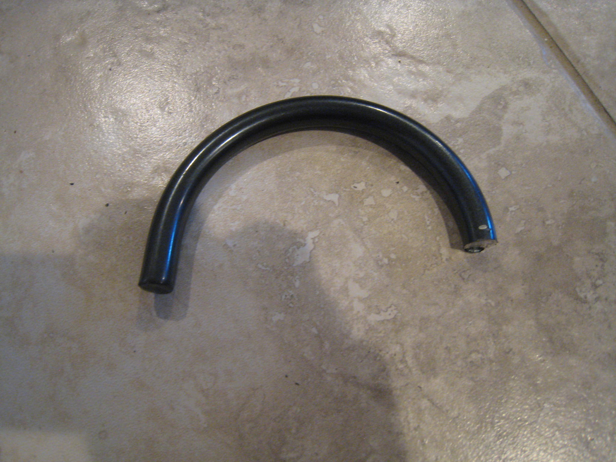

So here is where it gets interesting! Stuart at Velocity was kind enough to let me know that the F type springs can be cut. Yep, you can lop off as much as one full coil and they will still work. Figuring I had little to lose, I lopped off 1/2 a coil on each side, and shazam - the car sits about 1/2" lower, and looks so much better. Now I am NOT telling anyone to go grab a grinder and start whacking away at their springs. However, if you are experienced in mechanical things and find you need some fine tuning, you may want to consider this. I just wanted to let those folks know what was possible.

Sure, without pics it may as well not have happened.
Here is an after the spring was cut:
Attached Thumbnails "Customized" Lowering Springs - 2015 Rwd R Coupe-img_5412.jpg

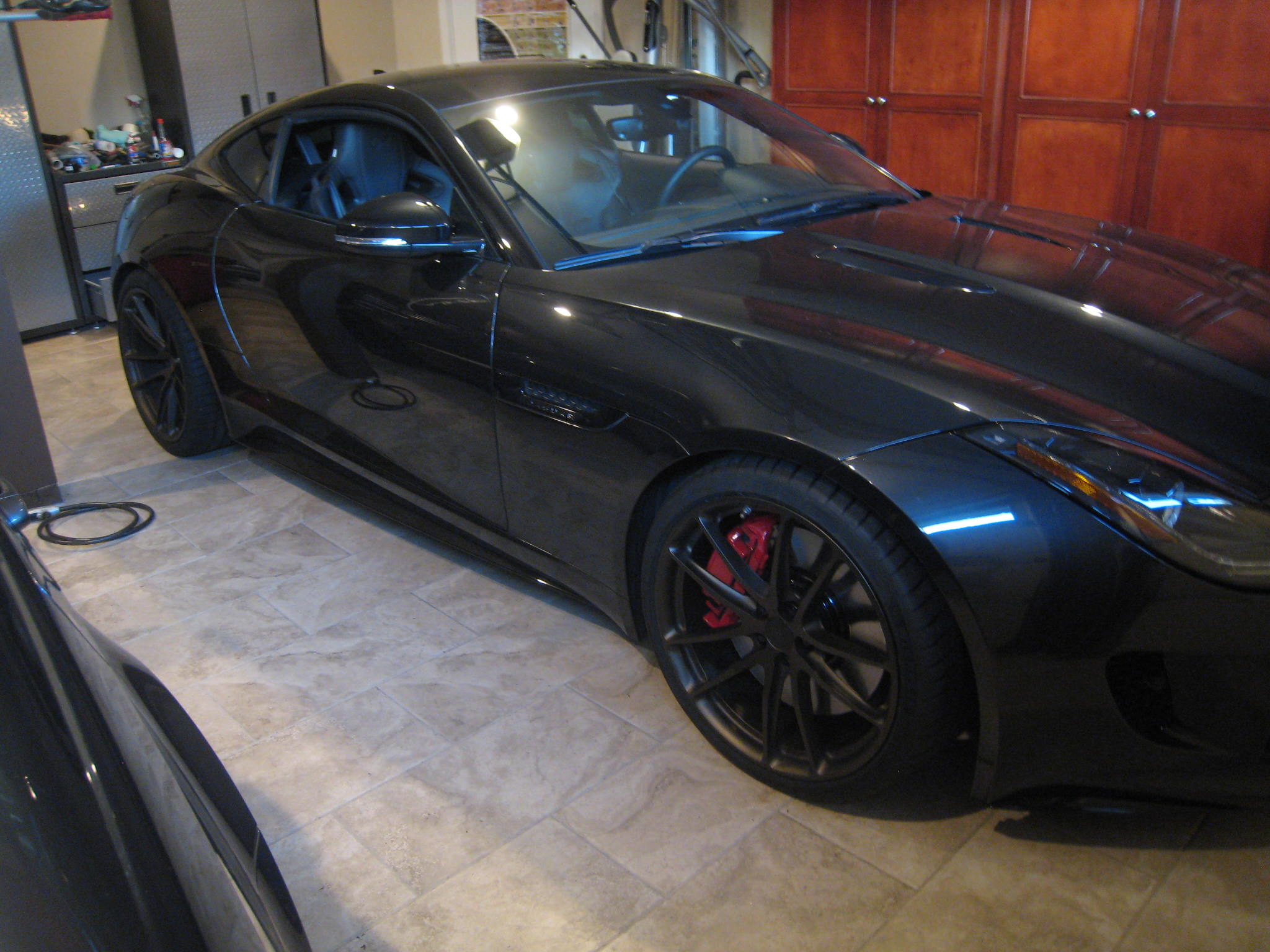

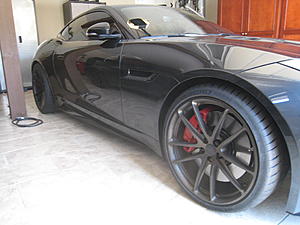

Ohhh. You mean the car....
Here are a couple before and after. Sorry, just in the garage, but you get the idea.
Attached Thumbnails "Customized" Lowering Springs - 2015 Rwd R Coupe-img_5406.jpg   "Customized" Lowering Springs - 2015 Rwd R Coupe-img_5416.jpg
Have you noticed a substantial incidence of scraping the front chin spoiler after lowering the front by 1/2"?
Doing this has obviously pitched the car forward a tad...
I think something was up with your VAP spring installation (early batch?, RWD vs AWD?). After the install the front was definitely had less gap than rear and your after cut looks like mine now without the cut. Unless mine are an anomaly.
Fronts VAP AP Lowering Springs - AWD
Rear VAP AP Lowering Springs - AWD
Both VAP AP Lowering Springs - AWD
Wow that looks reeaally low...

Received 241 Likes on 173 Posts
Might be a RWD problem. Stuart says the AWD model spring is 20 MM shorter which should equate to about that much drop. Your front looks really low.
Still, no matter which spring you are using, good to know you can "fine tune" if your particular application requires it.

Between switching from a 35 series to 30 series tire and the half inch additional drop on the springs, I'm .70" lower than I was, and I am just now hearing the disposable spoiler brush on some driveway ramps that would crush my M3 splitter.
I think the F type has surprising ground clearance stock, and as it sits now its still better clearance than most sports cars.
It didn't look THIS low until after adding the 10mm spacers to the front. But yes I have to be really careful driving over bumps and dips. I was in LA a couple weeks back and it was a nightmare. LA has massive dips at intersections and had to take many of them slow and diagonal and I am sure everyone was rolling their eyes.
It is great to know the Springs can be customized. I assume that wouldn't be the case for the OEMs?
Before the spacers, I guess it still looks pretty low. Hmm no idea. H&R must be crazy then
