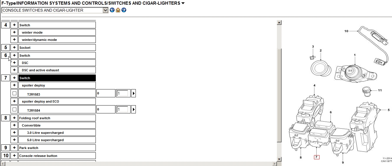

Originally Posted by owentb
I have a 2014 v6 convertible in south africa,
I don't even have the eco switch in my car - the spoiler button is just twice the size. Have to admit I was super chuffed to discover that when I got the car. Anyone else have this?
Now that's interesting...
Yes there is a switch assembly without the ECO button.
I wonder if having the button simply missing (i.e. not plugged in) will disable the stop-start...
Attachment 144419
I wouldn't think that would be the case. These switches are momentary contact switches, not latching or single throw, so the actual on-off switching is done elsewhere. I believe the console switch merely triggers the actual switching relay with an electric pulse.
