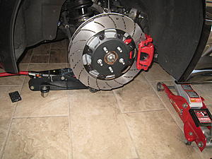

Competed passenger side rear, weighed caliper, got 10 lbs, 6 oz. Feel that is pretty accurate, as it matched the driver side pretty closely and on the passenger side the brake line seemed to interfere with the scale even less.
Decided black bolts look better, brushed on a couple coats of rust oleum oil based BBQ paint rated for 1200 degrees. We'll see...

For those of you like me that suffer from OCD, I must warn you of a matter of grave concern.
As awesome as the rotors look now, if you are going for the blacked look (excepting the swept area of the rotor) painting the bolts is not enough. You will want to paint the splash/heat shield behind the rotor, because, alas as I pulled my car out of the garage, I realized to my horror that the silver shield is visible through the openings in the rotor, and it ruins the black out look. @#X$! Now I have to remove the rotors and paint the darn shield behind. Should have looked at my photos, the flash illuminates the shield and makes it show, but I wasn't paying attention to that.
Just a bit of advice from someone that worries too much about the details....

Definitely a First Word only problem, for those who have two piece brake rotors. With anything else the splash shields are completely hidden by the rotors.
Suggestion - use two maybe three coats from a rattle can of gloss black caliper paint, should work well and be fairly easy to do as long as you mask off the area behind and thoroughly clean and prep the splash shields beforehand (they are aloooooominum).
If you are really picky you could take the splash shields right off and paint them up on your workbench, but the problem is two of the three fixing points are rivets which would need to be drilled out and then refixed somehow. I did this when I upgraded the rear brakes from 326 mm to 376 mm and I used some 10 mm nuts and bolts to hold two of the fixing points, but I don't know if this would work for the front splash shields (it's a question of access to the rear). I wouldn't bother and I would just leave them in place and use a rattle can.

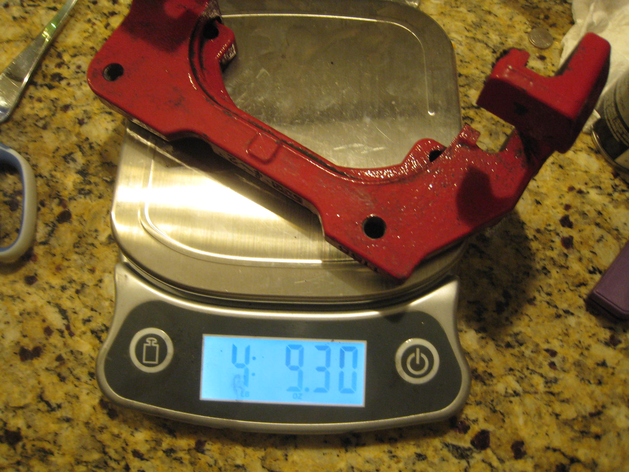

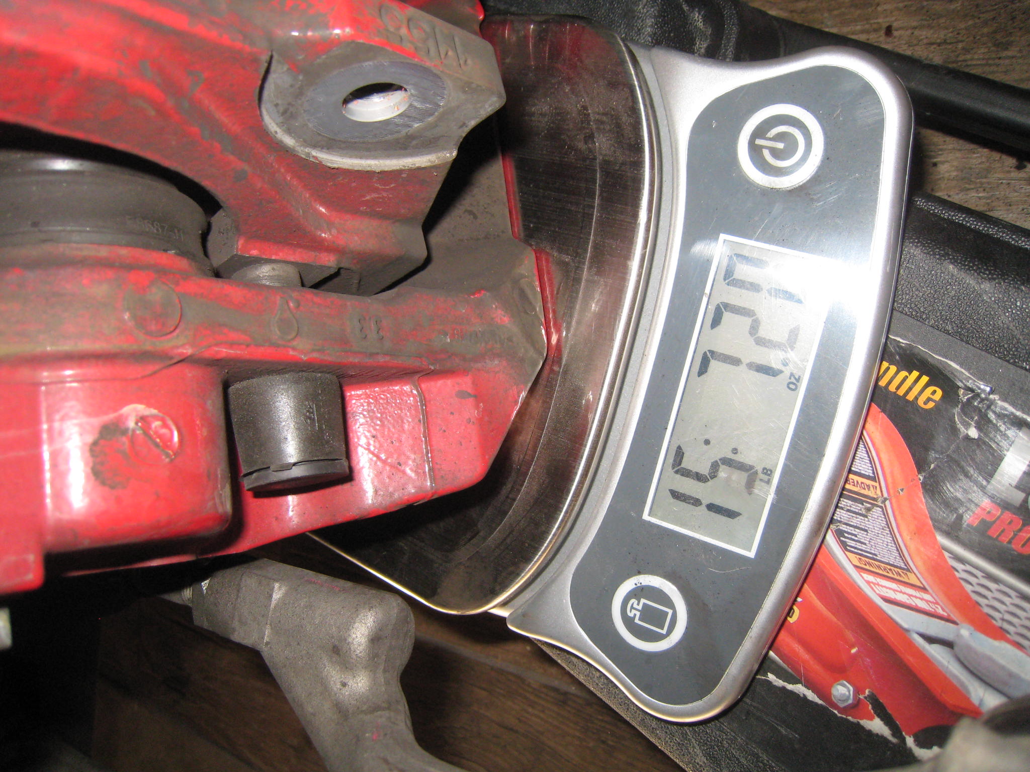

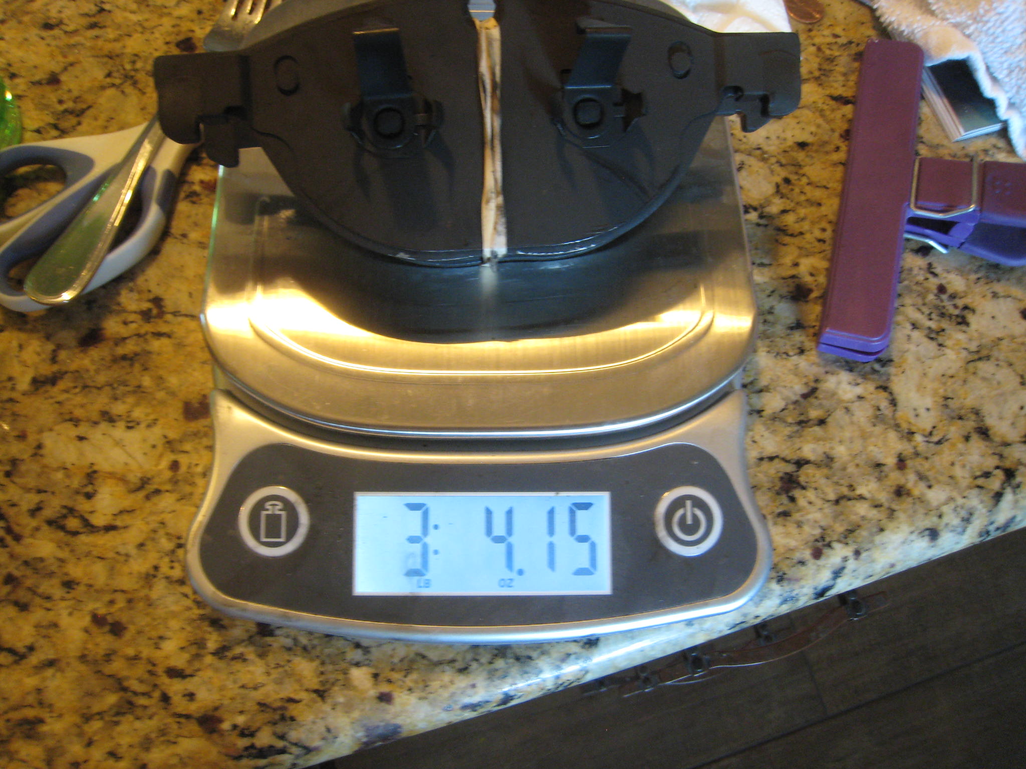

Started the fronts today, and its quite a project. At least half my time is spent removing brake dust so I can see all the parts. Couldn't get anywhere without pulling the caliper pins, but once I did that so much easier to get in and clean.
Despite all the talk about the front caliper weight, I don't think they are that heavy. Using my scale, fully assembled I got like 18.5 pounds, which sounds like a lot, HOWEVER, the pads weigh 3 lbs 4 oz, the mounting bracket weights 4 lbs 9 oz, so the caliper alone is only about 11lbs. According to the web, Brembo 6 piston calipers weigh 7-8 lbs. So I don't think I'd upgrade for weight reasons alone, not a good cost/weight savings ratio.
I wonder if the mounting bracket could be made of Aluminum?

I think both the bracket and the caliper are aloooooominum alloy.

You may be right, I'm no metals expert, but the bracket seems much heavier than it looks like it would be, whereas (once the pads and bracket are removed) the caliper itself feels light for its size.

Agree, I'm pretty sure the caliper itself is aluminum/alloy, it is the mounting bracket that is disproportionately heavy and screams cast iron. But I imagine it's cost prohibitive to get one made of another material, so it may not matter.
These stock front rotors were crazy heavy, I'll see what these lighter rotors (in conjunction with my forged wheels) do to make the front suspension come to life before worrying about chasing the last few pounds in the caliper and/or bracket.
