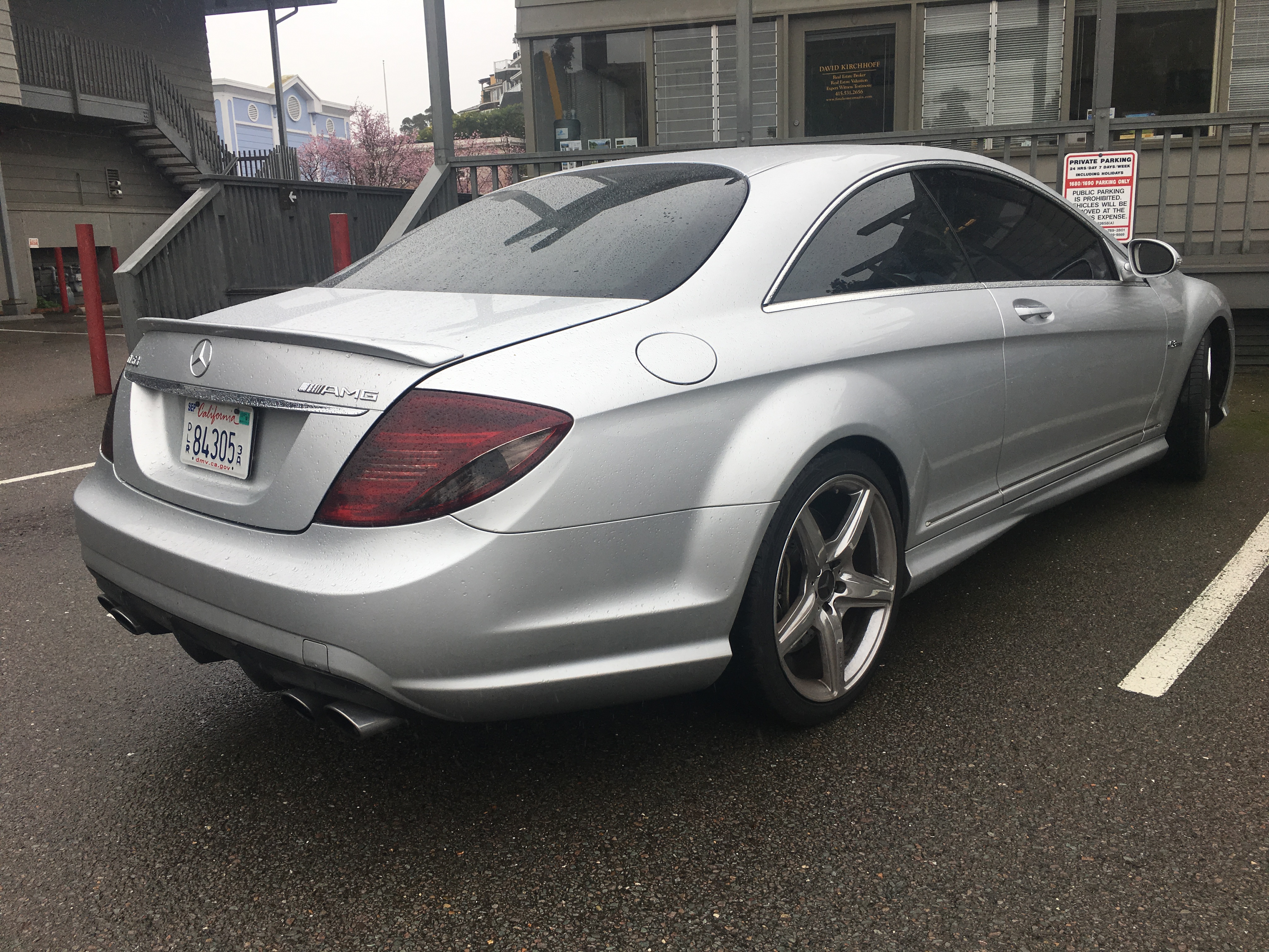

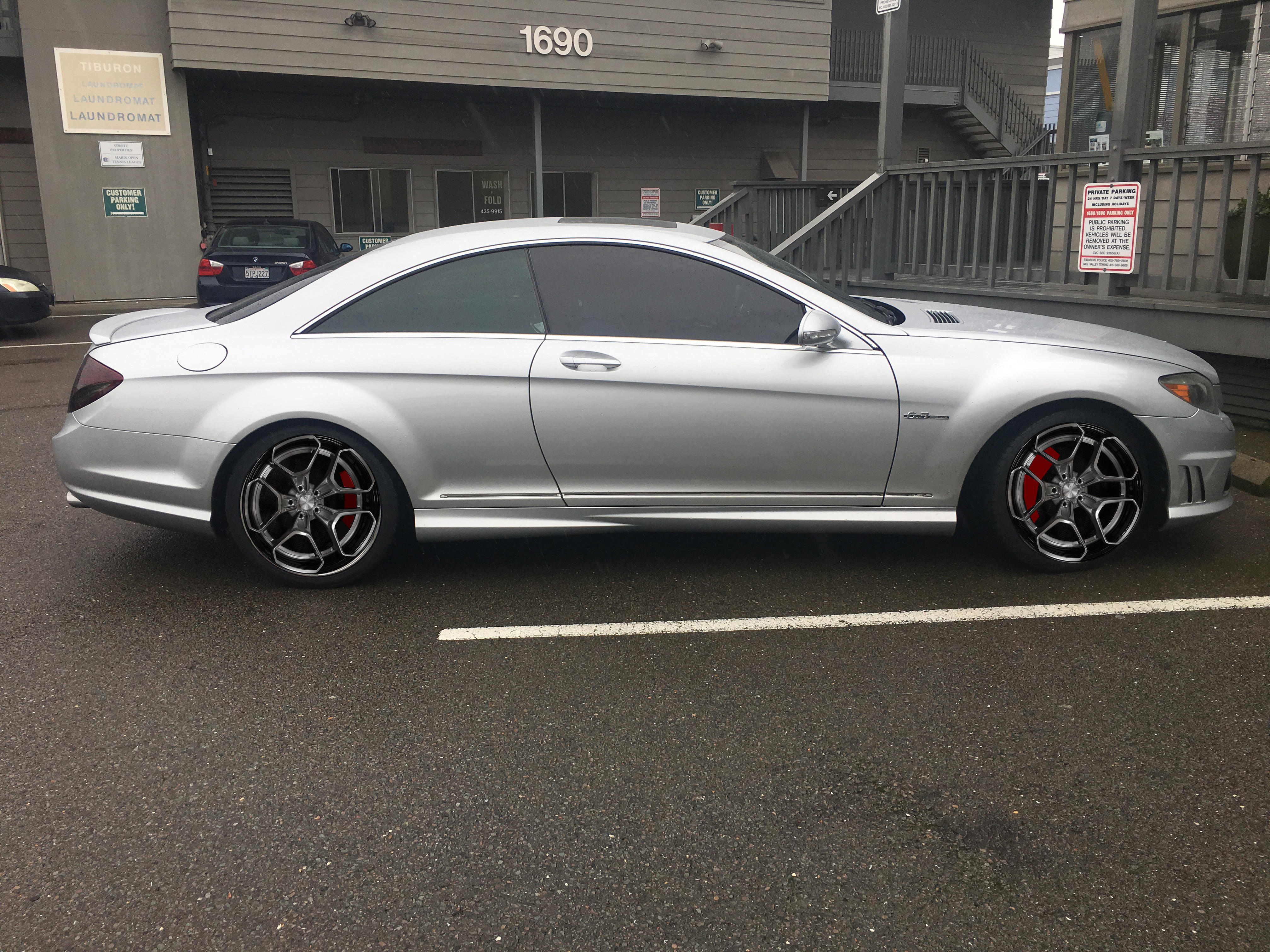

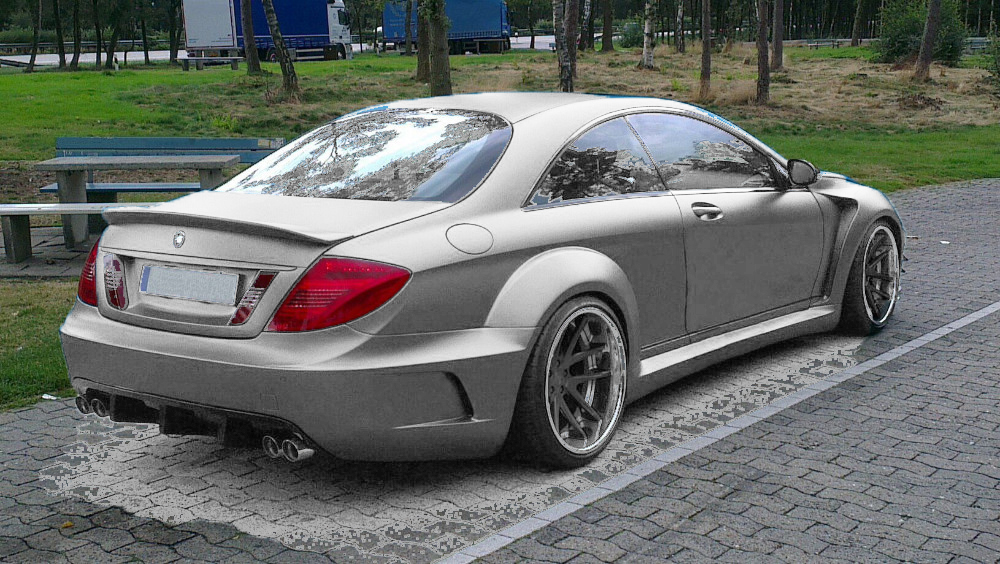

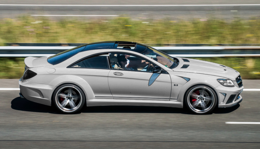

I am working on a Benzo CL63 wide body car.
One of my big issues has been to get wheels fitted. There are simply no standard wide (11.5-12") rear wheels for Mercedes which are needed for my build to fill up the fender flares without spending $7G for some one off custom 3-piece wheels.
Then Lenny came to mind from this previous GB. I am going to have him build me some (5x112 Benz) > (5x120 BMW) adapters! This will allow me to use X6 OEM wheels which are staggered 10.5, 11.5" widths (http://www.ebay.com/itm/SET-OF-FOUR-...-/201840168249) for $850!. Also the offset for MB AMG wheels are like 44, 48 and the offset for X6 wheels are 20. This, along with the width of the adapter itself will bring out my wheel to where it needs to be to give me flush fitment. This solution should save me $6k! if all goes well. And to sweeten the pot even more, I can now get rid of my oem lug bolt silliness and move to lug nuts which makes life super simple moving forward.
So happy!
Here is a before and after.
