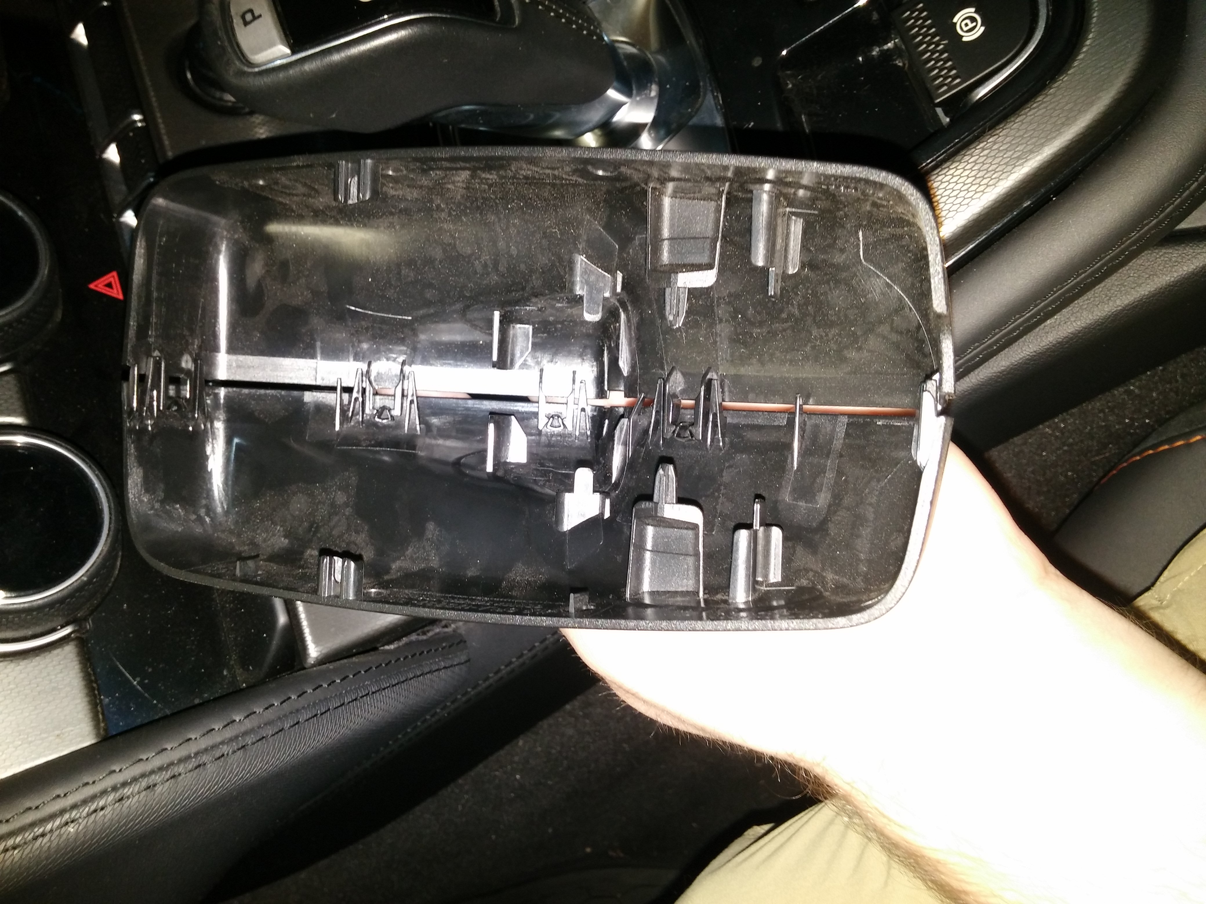

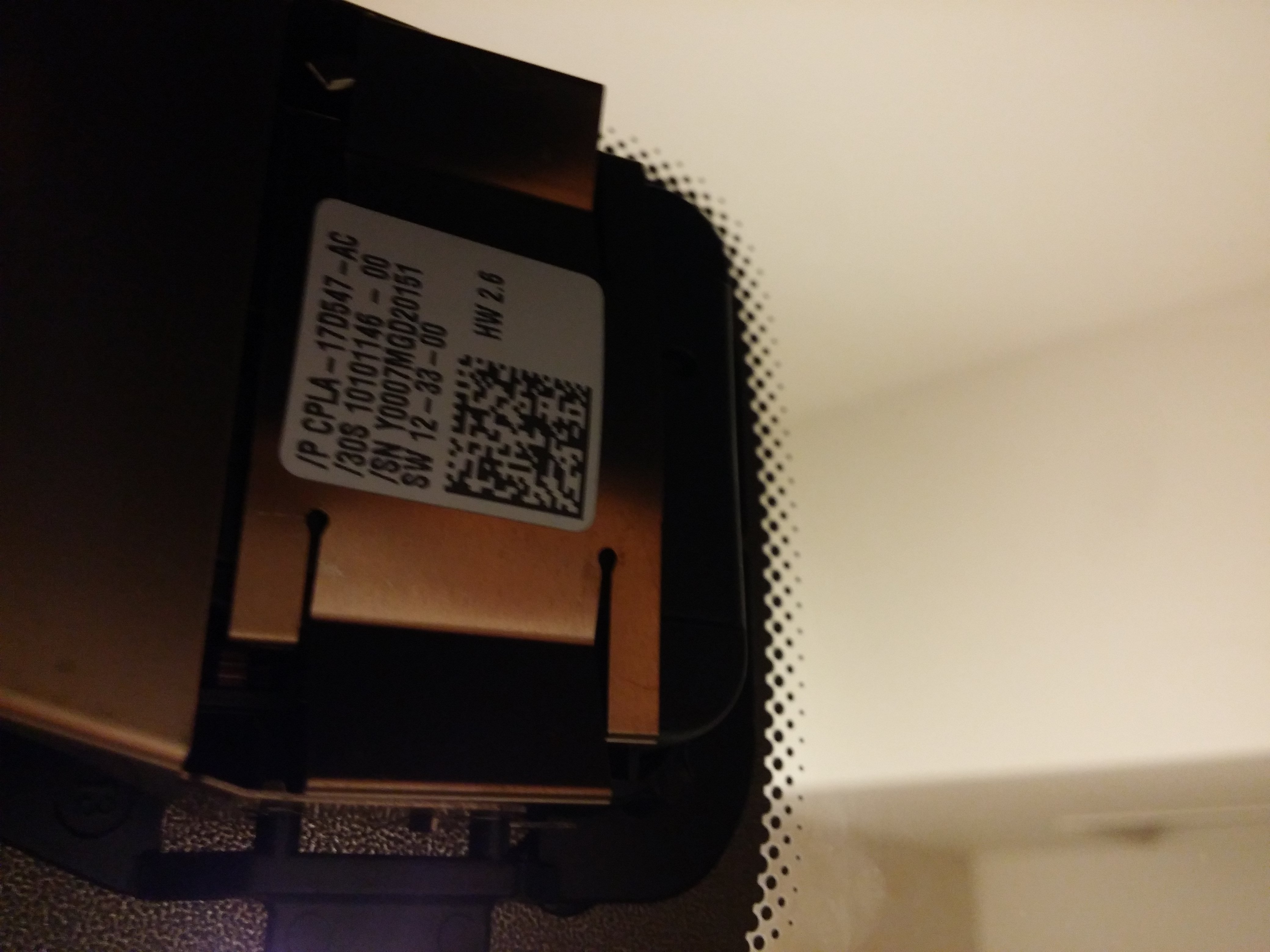

Update:
I managed to remove the plastic housing. I used a plastic "spudger" that I had for cell phone repairs, and used that to pry along the bottom of the plastic housing. It popped off easier than expected, and after it was off I was able to separate the left and right halves.

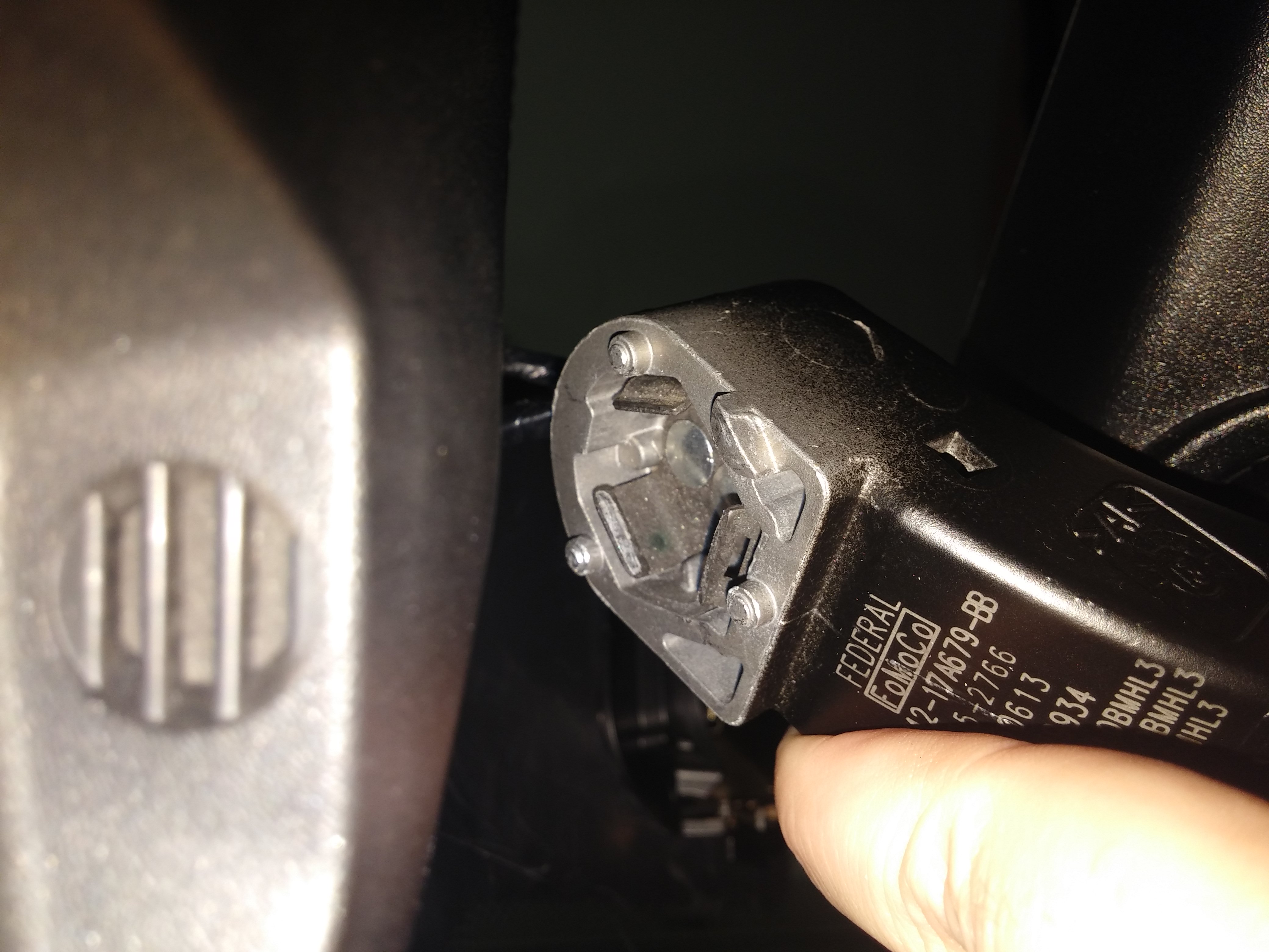

I never intended to pop the entire mirror off. How can I put it back on? The mounting system is really weird.

I think it's kind of a cam-lock mechanism.
twisting the mirror around the studbolt rotational axis (part glued to the wind sreen) will lock / unlock the unit . Unfortunately not more information available in workshop manual.

Thank you, I got it on, and got my radar detector wired up.

From memory, you have to rotate the mirror assemble about 90 degrees. Then, the hexagonal bolt thing will fit over, and then can be rotated back to normal position. The hexagonal bolt thing is not actually symmetrical, it turns out, but is wider in one direction than the other.

Fantastic! Managed to get it back on straight away. Amazing how one's mind just assumes a hex head is symmetrical - it's obvious when you look at it closely. Many many thanks - you have saved my sanity
