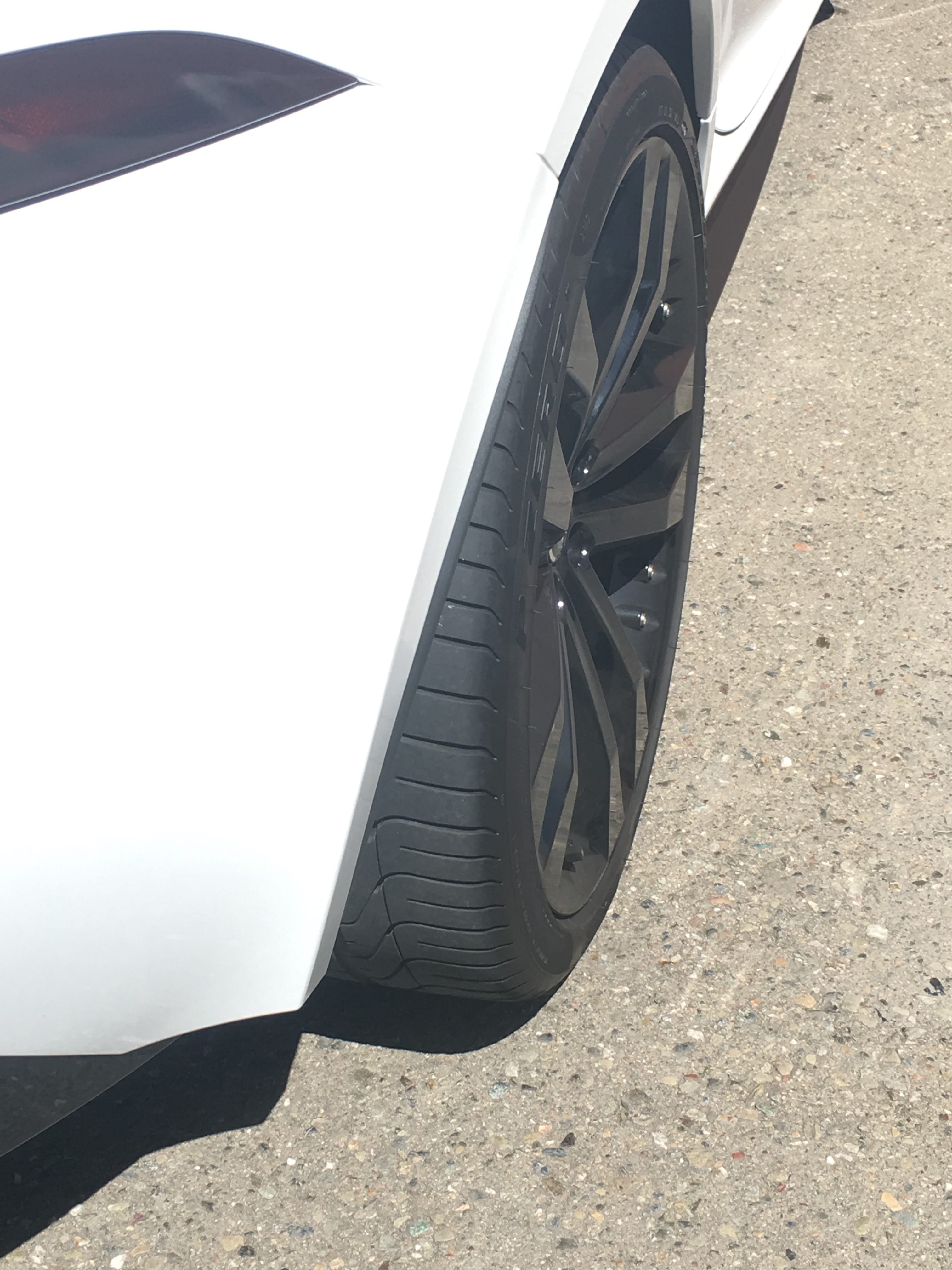

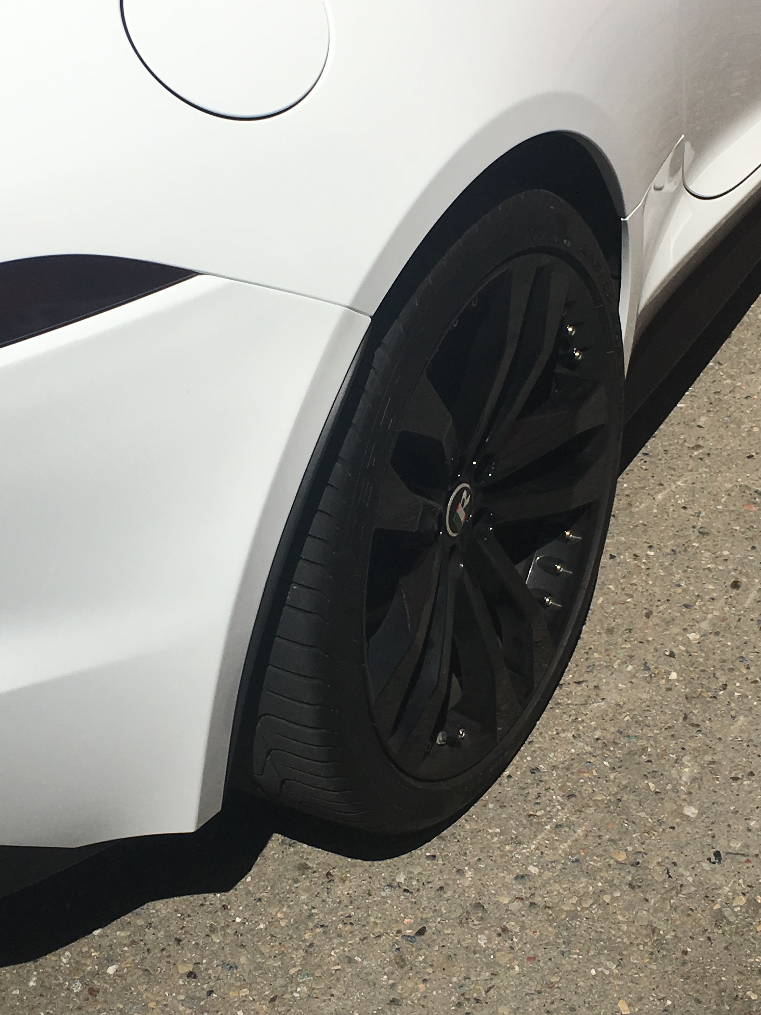

So out of all the F's is his the only one with adapters?
15mm/20mm right? The stance looks perfect but funny so does my 10mm....
Do you see a difference?

Polaris, the search tool is your friend... Lots of pics in this link:
https://www.jaguarforums.com/forum/f...r-pics-127628/
I have a curious question, the answer to which is really none of my business, but I'm gonna ask anyway... you purchased a rather expensive, precision engineered sport car... yet it seems that in the vast majority of your purchase considerations, you are quite vocal about shaving a nickel here and a dime there off the price of accessories. You've even just recently started a thread looking for a contact for discount parts... You purchased cheap wheel spacers off of Ebay of all places, and created a dangerous condition on your vehicle. When presented with a safer alternative, your first question is: "will they still honor that price". As I recall, not too long ago you were concerned about the expense of a phone mount that sells for $20. I could dig up other examples if you like, but to my question: why did buy such a nice, expensive sports car if you are going to continually comment about prices and pinch pennies as you accessorize?
I'm pretty sure I'm not the only one on these forums that finds this practice/line of reasoning rather disturbing...

Having seen Unhinged vehicle from behind for several hundred miles on the trip his spacers are definitely a wider stance than the 10mm ones. It is amazing the difference in aggressiveness from stock. My wife even commented how amazing it looks. Seriously considering that mod to mine. He also lowered the car which completed the look.
