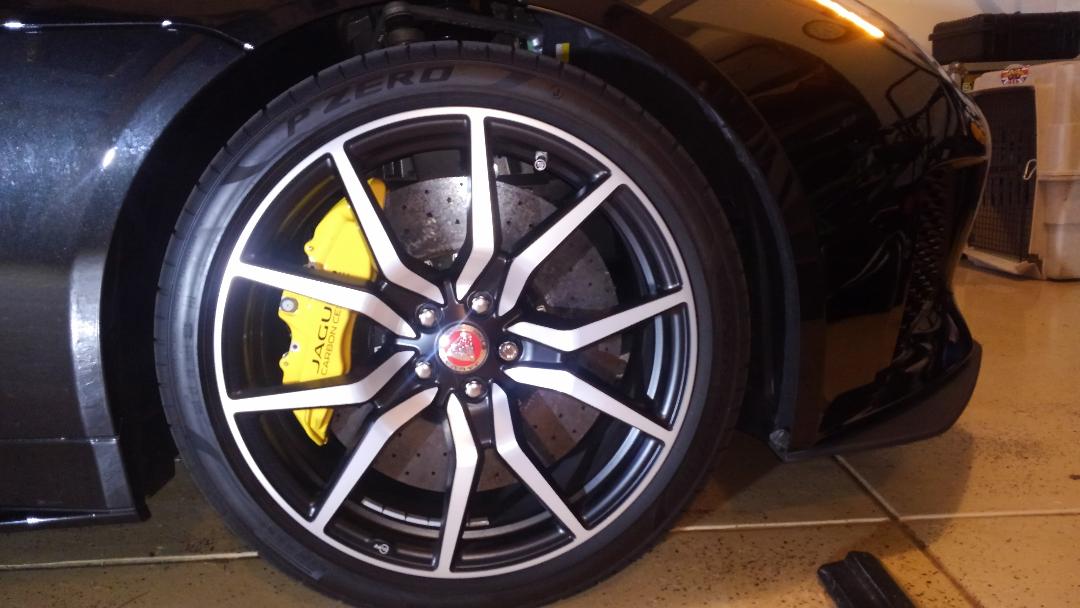

My plan is to add 10mm hub & wheel centric spacers (not adapters) and use extended thread (ET) lug nuts as pictured (black). The issue I have come across is the stock lug nuts (silver) have built in flat washers that engage the wheel. What are my options regarding the lug nuts?

By my calculation, the lug nut should have at least 4mm more shoulder than stock to safely accommodate a 10mm spacer.

More engagement than stock is certainly fine as long as you aren't bottoming out on the rotor. That's the only thing to check. You can probably paint pen the threads to check for this.

10mm spacer, stock nut= 4.75 turns torqued.
10mm spacer, new nuts=almost 6 turns torqued.

Ahhhh I see. Certainly not bottoming out on the assembly then. I'd definitely like to see more than 6 turns, but that's probably safe. The torque on these studs isn't extreme, so you wouldn't see any issue there. The extra engagement would be key for shock loading on the stud and that's not something you can really calculate or quantify without knowing a lot more about the materials at hands than we do.

At 6 turns he doesn't quit have enough thread contact for full strength. Eight turns is the safe bet.
