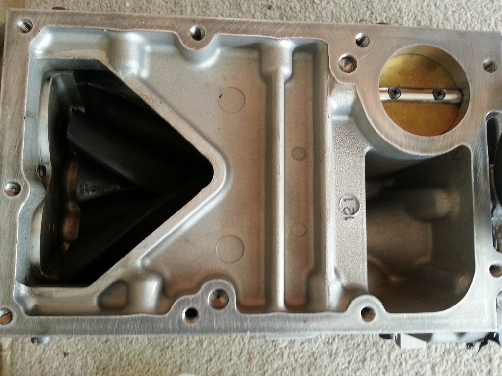

Originally Posted by 15FTypeR
I assume the S/C needs to come apart? Have only just started to wonder what is involved. How involved is this I wonder...
I think we already don't have the "air leakage ports" they are talking about. At least not in the same place:

Yep, that web page about closing the ports is for the M series Eaton SC, and the F-Type runs the later TVS R series which is quite different.

Outlet port of the TVS does not have those two slots in it.
This is the R1900 off the 5.0L, presumably the R1320 off the 3.0L is similar.

Yep, no holes in the TVS units. That's because the bypass was integrated into the compressor housing versus being remote(M units have, TVS units don't), it allows the manufacture to toggle the bypass and avoid sound if desired. But the addition of the plastic intake tube and silencer cambers also aid in reducing the charger noise. I've played with the bypass valve to help net more noise but with the plastic tube still fitted, doesn't increase a whole lot.
