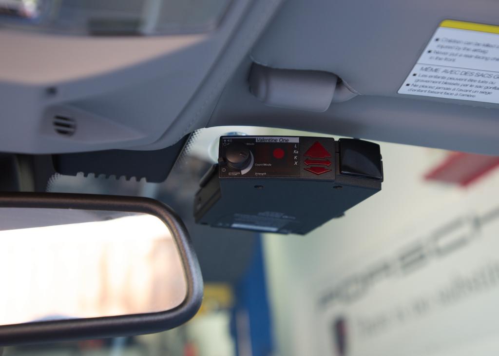

Seems there is a lot of interest in radar detectors and installs so I thought I would share my F Type install.
I have used Valentine 1's for many years, have one in every vehicle and personally feel they offer the best detection as well as situational awareness with quadrant arrows. Set up properly and with good analyzation skills I don't think it can be beat. That does not mean you will have a quite interior. Actually it won't be. But there are some things you can do to minimize the chaff.
First off is the use of Savvy. A Valentine One product that allows you to get power for the unit through the OBD port. Through the port the V1 also gets speed data. With that information the Savvy can be set to forward aural alerts to the V1 at a speed greater than what you have set. (Visual alerts are always forwarded) So for me, I have it at set at 45MPH. I am not too concerned with radar speeding tickets below that speed and can avoid all the noise as I pass or enter shopping center parking lots. I still keep an eye on the display and look for changes to signal types as well as alert numbers that are different than I typically see.
Savvy | Valentine One | Radar Detectors
I mounted it for easy speed changing access near the OBD and use an OBD 90 degree splitter. (This keeps the Savvy from hanging down low into the foot area and frees up an OBD for my Bluetooth OBD performance reader.
Aliexpress.com : Buy High quality 16 pin OBD2 OBDII Splitter Extension Cable 90 Degree elm327 Diagnostic Cable 50cm Male to Dual Female from Reliable elm327 obd2 suppliers on Phoebe Pang's store)
Second. Although the beeps are fairly good for differentiating Ka band from K band I can't hear them very well with the top down or if I am playing music very loudly. So I had the V1 Remote signal type LEDs changed from all Red to different colors so with a simple glance out of my preferential vision I can discern Signal type, azimuth, number or threats and signal strength.

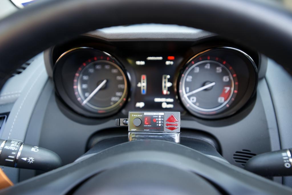

Full Color Defense
Blue: Laser- I actually have this band off because of all the alerts I receive from other cars' automated cruise controls.
Red: Ka- LEOs
Yellow: K- could be an LEO or building door openers, etc.
Green: X- I have this off also. No X-band where I am at.
I keep the V1 just to the right of the mirror. I do not want it obstructing my vision in any way so that's a great place. Since I use the V1 remote for visual alerts I don't need to worry about others behind me seeing the alerts since they are not displayed here.
I like the alerts to be where only I can see them and within my peripheral view. I also want the remote to be easily within reach so if I want to push the mute button I can. The location I have is the same for all my vehicles which helps keep things consistent.
The last shot is a wider shot look at the same angle as I drive. No gauges are covered up and the remote is front and center where I believe it should be.
This my setup and it works for me. Others have different detectors and mounting positions and it all gets down to what works for you and what you are comfortable with.

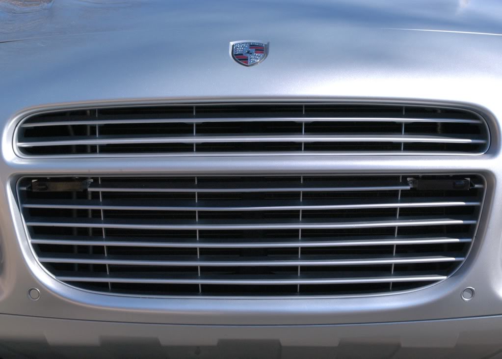

Like on my Cayenne TTS
