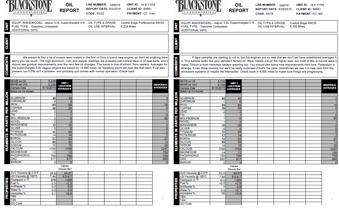

Recently had my oil changed on my 2016 F-Type Base with 5228 miles and sent an oil sample into Blackstone Labs to get tested. I also owned a 2015 F-Type Base which I also had a sample tested with 6700 miles. Granted there is a 1472 mile difference between the two, but I was still very pleased at the consistent readings between the two cars despite being built one year apart. Potentially could be a sign of consistent engine manufacturing by JLR. Click below to view. 2016 on the left and 2015 on the right.

The samples are consistent ...
... but the wear metals are high.
As Blackstone notes, this is the original fill and thus the wear
metals are accounted for by the fact that it is a new engine.
As the samples are consistent in this area, it suggests that
an early oil change as previously suggested by manufacturers
when the owner paid for oil changes would have been helpful.

Agreed. 16k miles is waaaay too long for break in materials to be in the oil.
