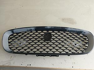

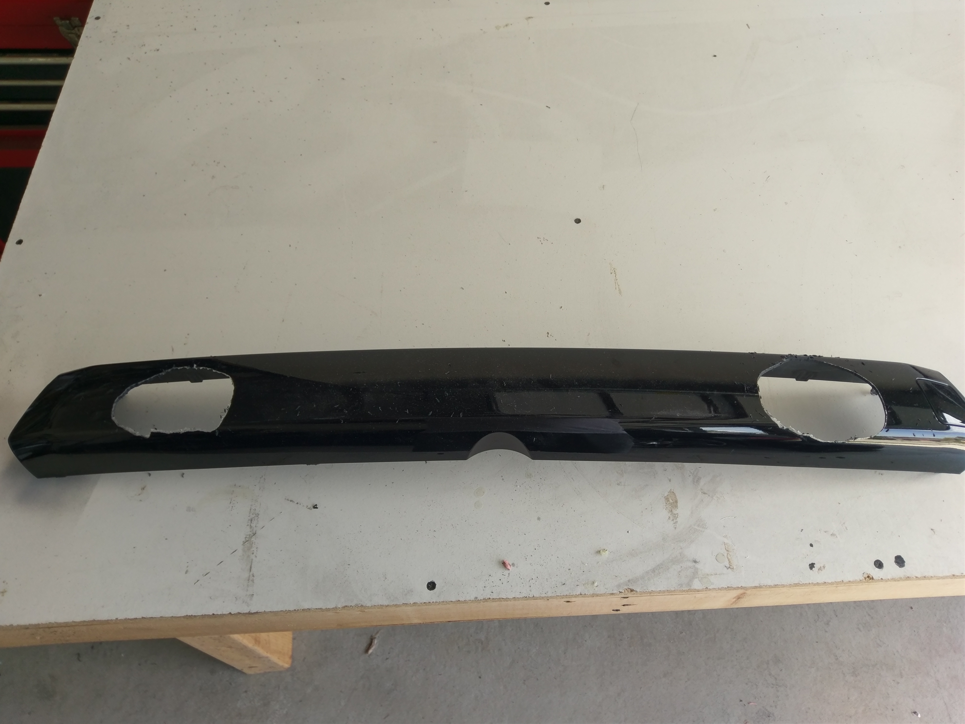

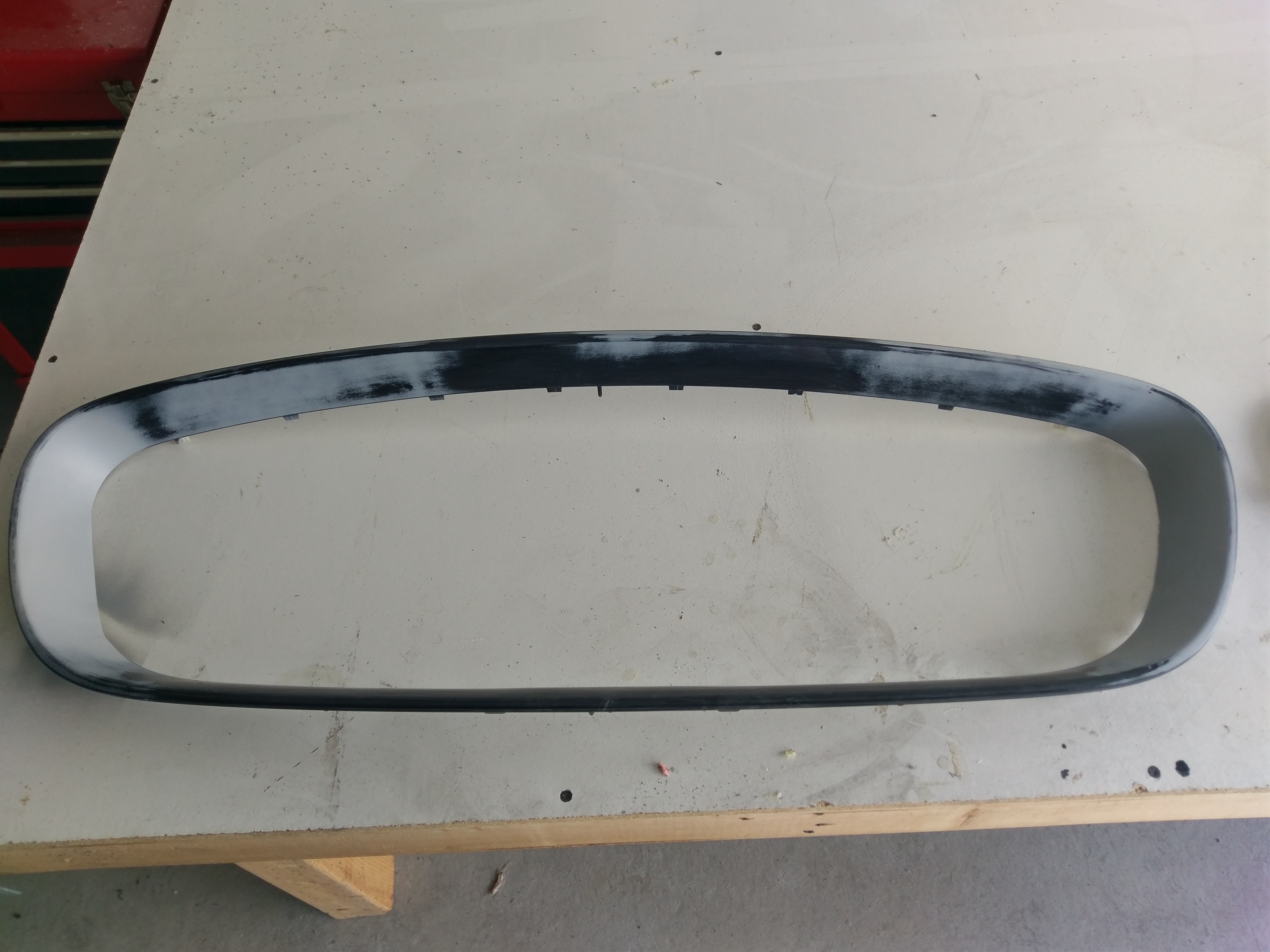

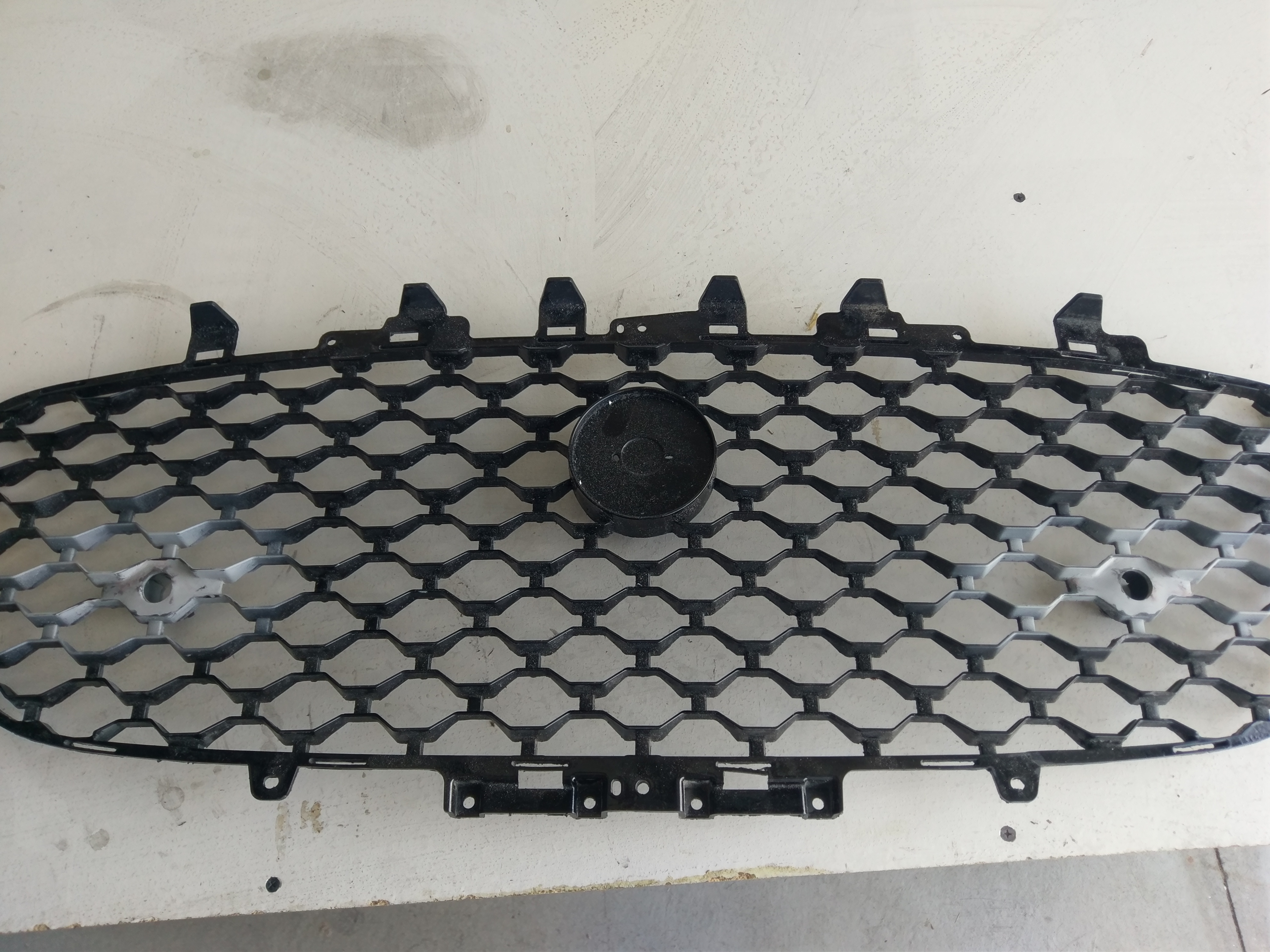

After seeing the P7 I ended up ordering the Paramount Performance "Project Predator" grill. Let me start by saying, DO NOT ORDER THIS GRILL! Unless, you have lots of free time on your hands. The quality is absolutely horrible! The surround comes VERY deformed, flimsy like rubber and has most of the clips broken off. The grill has tons of flashing and rough spots. BUT! You can make something out of it as the grill has the same mounting tabs as the factory surround. I started by tossing the surround in the trash. Then spent several hours filing and sanding the grill to an acceptable level. Cut out the factory sensor mounts and epoxied them into the grill. For the surround, I filled in the cutouts in the factory surround like "xdave". I'm not a body shop guy but I think it came out ok. Just waiting on the paint to arrive. Have about 10 hours into this so far not counting the removal of the front end.
Paramount grill - $569
epoxy and misc -$60
Paint and prep supplies - $90
Having a P7ish grill -PRICELESS!

There was a thread recently about the internal cross bar which will be exposed when you do this where posters discussed whether it was a good idea to paint or wrap it before putting the bumperless grill on. If you havent seen it, it would be worth a look.
My crossbar was painted body color (black) but I resprayed it matte black so it won't be as noticeable. You will see it through the grill but even on the P7 car you can.

IF! You have way more time than money... This maybe your option for a P7ish grill. I'm OK with the results but a body shop guy would probably cringe. Still could buff out a bit more orange peel. Had some issues with false park sensors activation. Ended up re-epoxied the sensor holders angled up a bit more. Happy with the outcome.

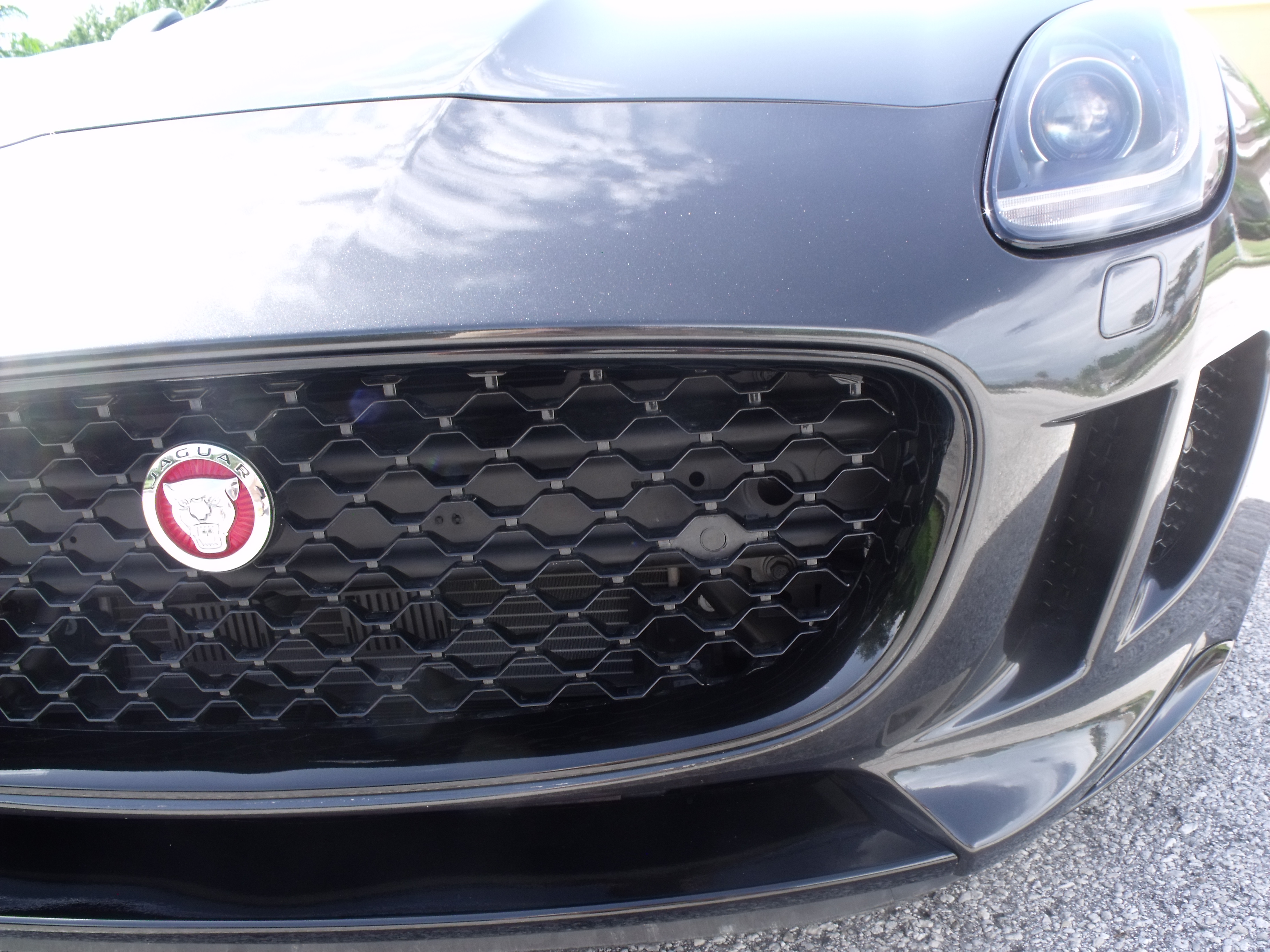

Looks great. I notice your sensors are positioned a bit lower than mine. When I had mine done, I went by Rospco's directions to keep them as close to the original vertical position as possible. He said the horizontal position wasn't that critical but for some reason the vertical was. I have had no issues with sensors working properly.

The honeycombs of the PP Grill are slightly larger than those of the P7.
I have also mounted the sensors slightly higher than you. From the middle one honeycomb
down and five honeycombs to the side.
My sensors work without problems. Also my car is deeper.
