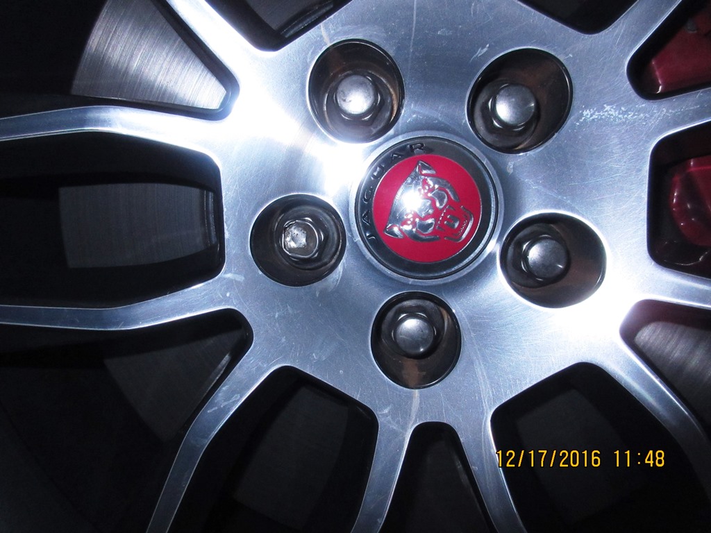

During my new tire installation today I was told one of the wheel bolts is damaged. I also noted significant corrosion on these poorly designed bolts. Has anyone replaced theirs? What size are our bolts? I know Gorilla and Mcgard are respected brands. I searched and couldn't find much. Any help is appreciated.

Sorry these are lug nuts not bolts, I'm a previous M3 owner. I don't think mine are McGard. The lug nut got stuck in the socket and had to be punched out. As you can see these lug nuts have some sort of cheap chrome cover.

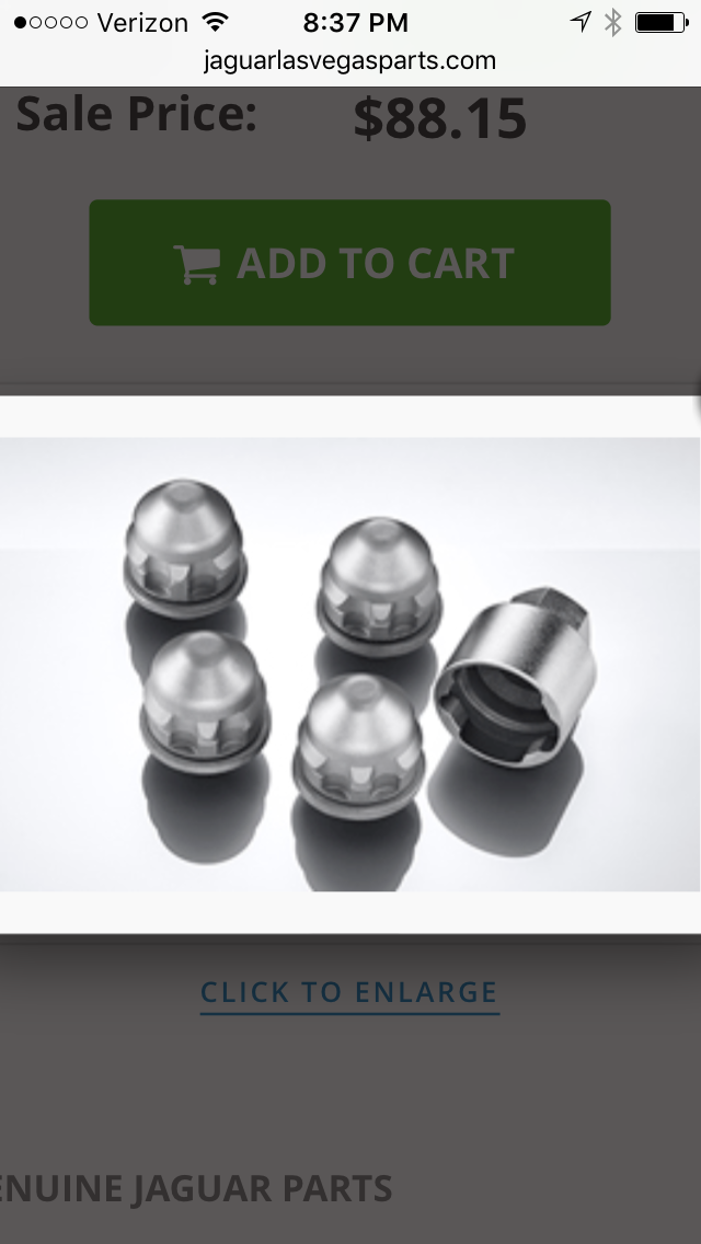

Default My lock nuts
They are hardly distinguishable from the IEM lug nuts.

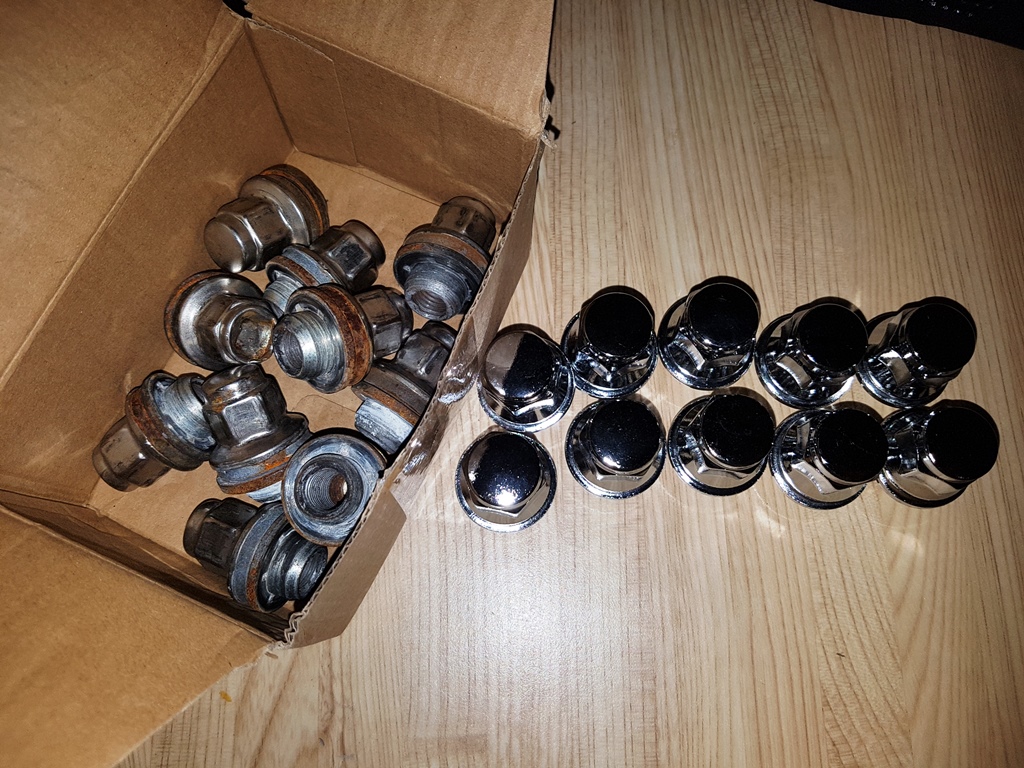

Out with the old in with the new. I would highly recommend those of you who drive on salted roads to change this **** poor design out.
