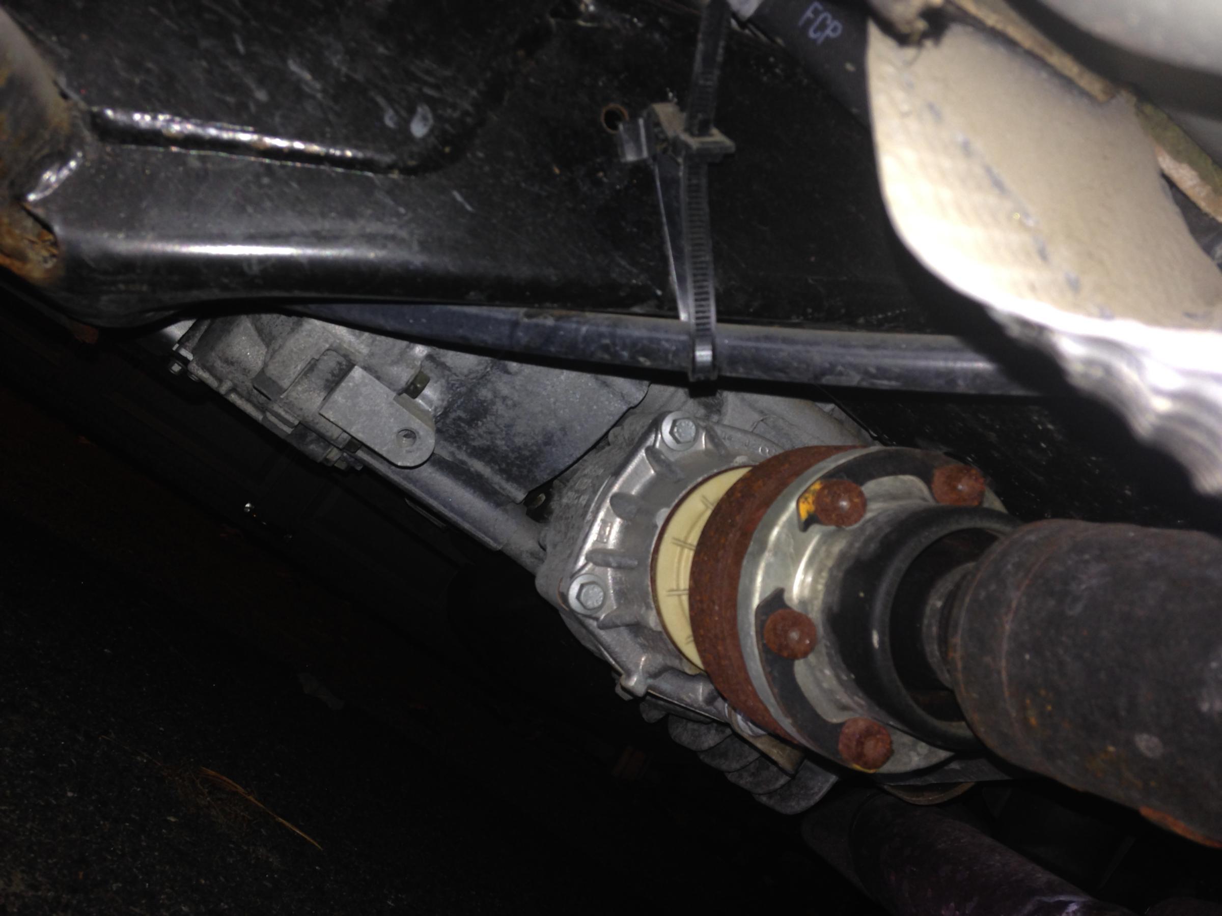

These are pictures of an XJ but it's the same type of diff from GKN, you can see the transmission end has one of the flex discs, but the diff end is a different arrangement.
https://www.jaguarforums.com/forum/x...97/#post960840
You can also see the old design diff & propshaft which came out of the car, they had the big rubber doughnut type flex disc on them. The GKN diffs are different, there's some further explanation about the new design in that thread.
What you'd see at the F-Type diff is this;
But without the rust, I hope...
There's no jurid / flex disc there anymore.

Maybe some automotive engineers on this forum can chime in, but my understanding that 1 less flex disks replaced by anti-dump valve (aka Volvo valve) would make it a lot less reliable long-term.
No matter how good you are, you will mess up rev matching now and then and end up dumping torque into differential. With 1 less disks, there is a lot less protection from that.

You actually have three systems mitigating shock during a shift:
1. The Clutch Delay Valve that you mentioned,
2. the dual mass flywheel on the F-Type. (springs to isolate the input side of the flywheel from the output side), and
3. the remaining flex disc at the front of the prop shaft.
