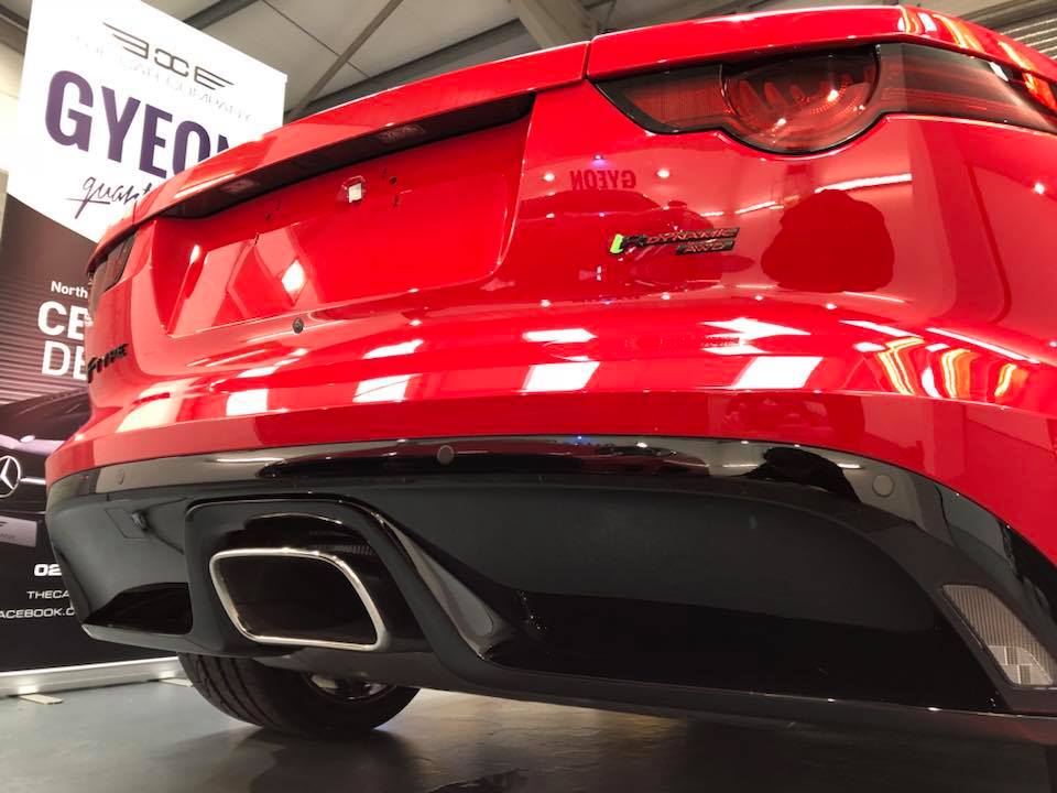

So thought of getting a fabrication done, but with a bit of research i see that the V6 has a near identical back box in construction to the 4 pot. The V6 has 2 active valves though, where as the 2.0 has one. You will see this from the pictures below.
Fitting a V6 box would make no difference, but then i came across the VelocityAP exhaust which is a fit for the V6, with no modification. The active valves are not used.
That got me thinking , what if i fit this Velocity rear box would i have an increased sound, this is the question, should i go for it or not, any comments welcome.

That looks like a different diffuser than the V6 has.

I'm sure you'll have them pipes sparkling soon, not sure what year your car is, but the 2 pictures i provided is the rear diffuser on the late 17/18 year cars, mine been the 2.0 and the other the V6, seems they have utilized the rear diffuser for each cars. Yours looks a different diffuser but the outlet part would still be the same as they are still using the same exhaust as on the 2018 V6, can't see them changing that. The only difference i see is the moulding on the part around the pipes seems to go round the top of the pipes rather than straight up like yours if you can get that.

The picture of the V6 diffuser is too dark to see whether it's the same as that on the I4.

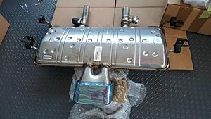

Ok this is same diffuser as mine , better pics, this is on the 400, same opening, so i would say same opening size as older diffusers, only different moulding round the pipes

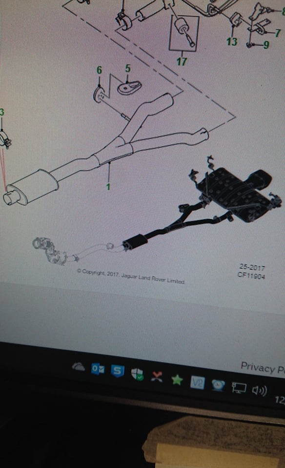

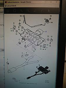

this is the set up of the 2.0 exhaust, The exhaust pipe as you can see branches into a Y, the sleeve connecting the centre pipe and rear box is 2.5" on the pipe with no valve, the other pipe with the valve is a bit bigger, like 2 and 3/4 or 3". I would say the both pipes are the bigger size like on the V6.
Made a short video, don't think i'll be heading to hollywood soon though, just meant to say at the end i would be changing the rectangular tip to twin tips like the V6

From all the data I can see, 99% the existing VelocityAP V6 Exhaust will fit the 2.0T. I would probably suggest the Supersport, as being a turbo engine the exhaust note will be more muffled than the V6.
