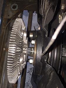

My fan clutch needs to be replaced but I can't figure out how to remove the nuts from the spindles holding it into the pulley housing as the spindle end is too long. See photo. Any ideas?

I think you have to take off the fan and torquatrol together and swap over on the workbench. However I'm only guessing based on the XJ6 I once had where I had to replace this part..

Loosen all of them, back it out a bit, and then you can get them all out. This is on my '94 XJS 4.0, but same idea.

Padre,that solved the problem! Never thought to pull the semi-loosened clutch unit forward to get the final spin of the nuts. Very much appreciate the suggestions from everyone on this forum.
