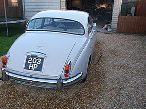

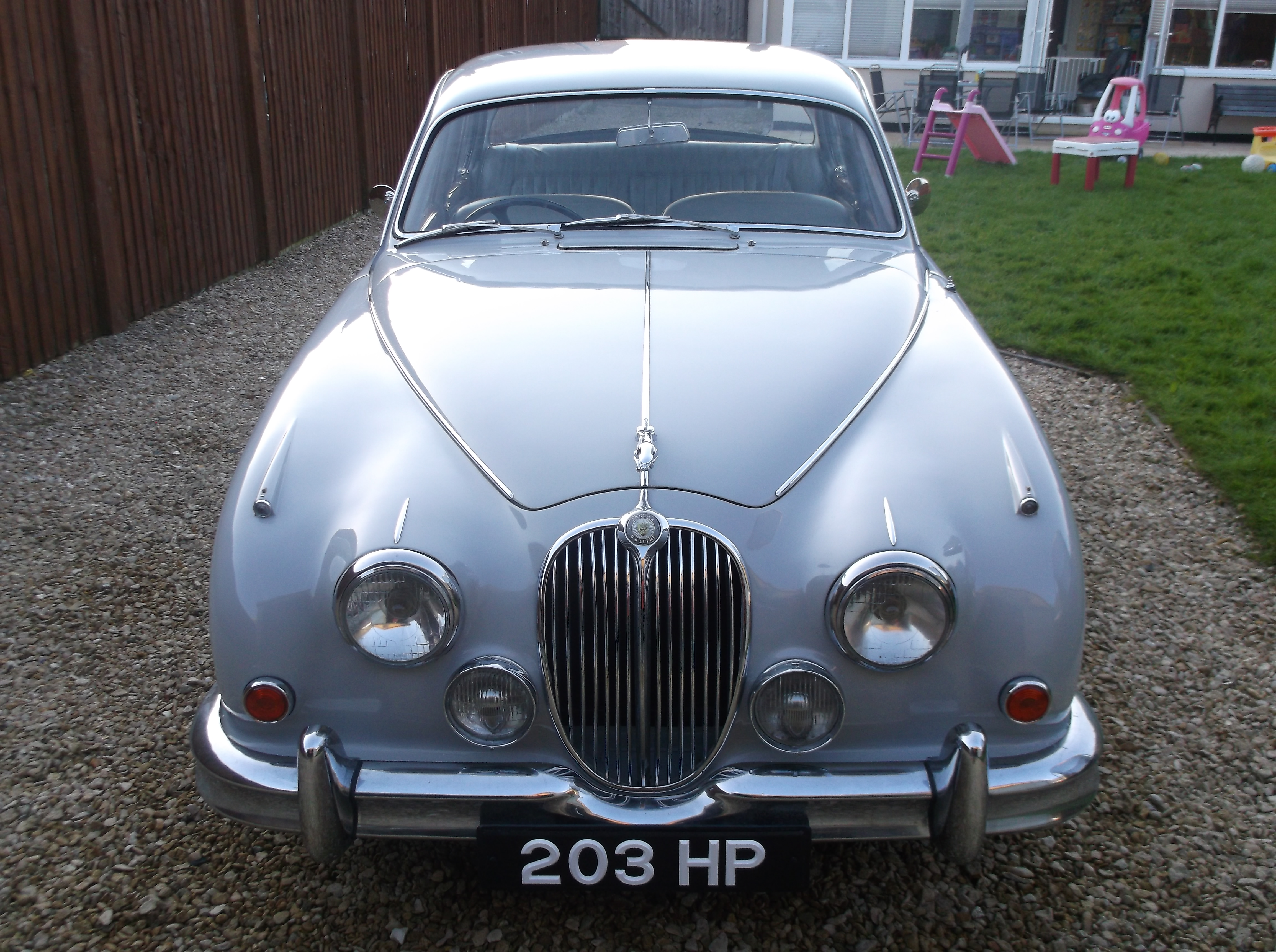

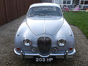

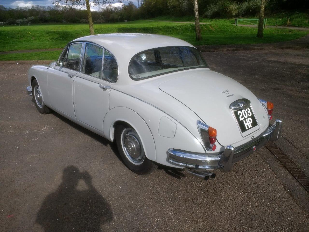

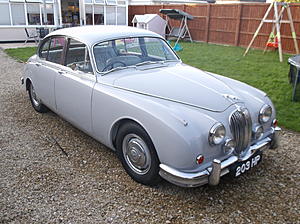

I didn't manage to get any good photos of it but took a few in the garden late this afternoon when I got back.
Attached Thumbnails 1959 MK2 3.8 Restoration-dscf5616.jpg   1959 MK2 3.8 Restoration-dscf5617.jpg   1959 MK2 3.8 Restoration-dscf5618.jpg   1959 MK2 3.8 Restoration-dscf5619.jpg   1959 MK2 3.8 Restoration-dscf5620.jpg
1959 MK2 3.8 Restoration-dscf5621.jpg   1959 MK2 3.8 Restoration-dscf5622.jpg   1959 MK2 3.8 Restoration-dscf5623.jpg   1959 MK2 3.8 Restoration-dscf5606.jpg   1959 MK2 3.8 Restoration-dscf5614.jpg
The following 4 users liked this post by Homersimpson:
blot3.8 (04-22-2018), csbush (04-22-2018), michaelh (04-27-2018), wearlej (04-22-2018)

Very very nice

Wow, You must be seriously chuffed with that, I would be! And to think it could have ended up being banger raced, Excellent job.

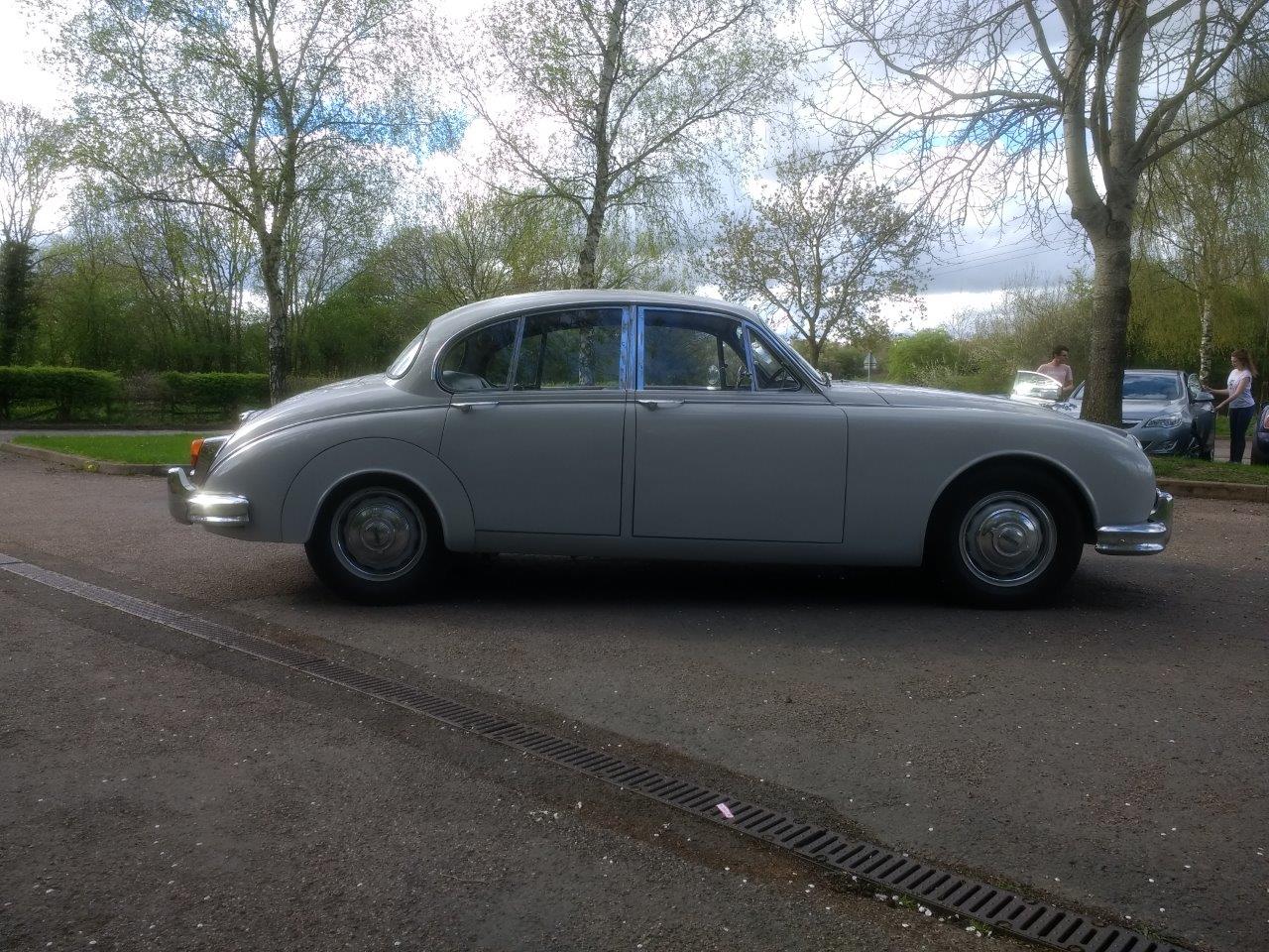

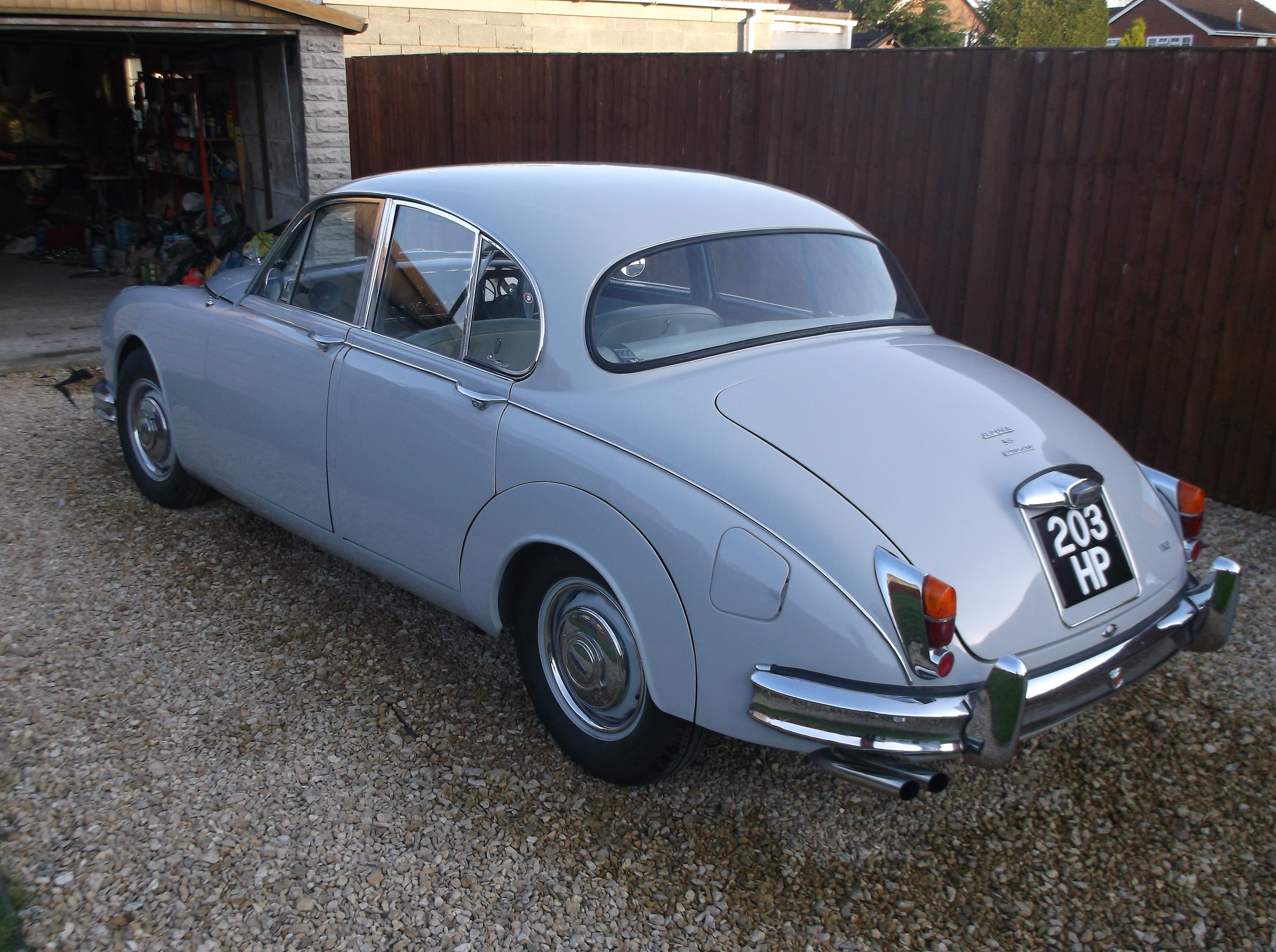

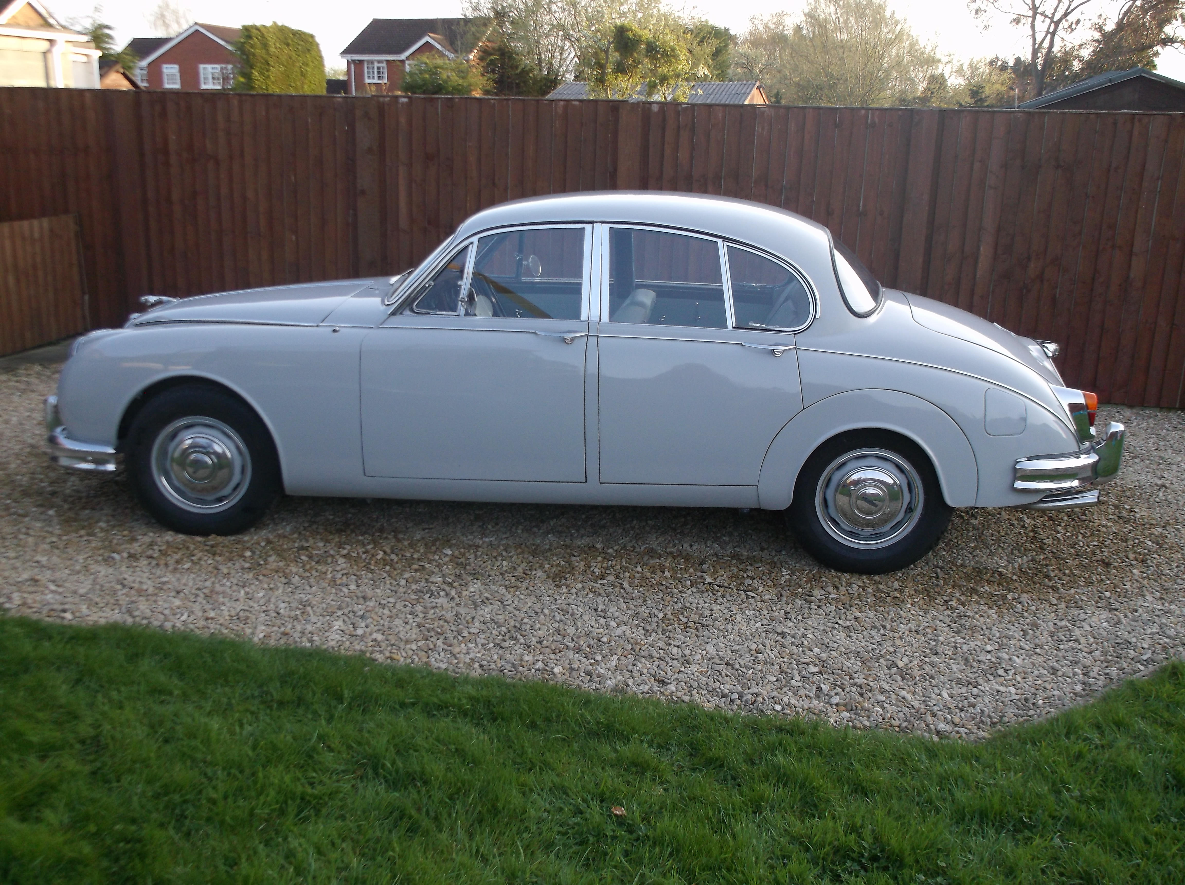

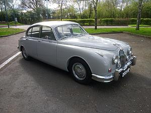

I've taken a few more pictures today in better light (and a slightly better location).
Attached Thumbnails 1959 MK2 3.8 Restoration-img_20180422_163938637_hdr.jpg   1959 MK2 3.8 Restoration-img_20180422_163951257_hdr.jpg   1959 MK2 3.8 Restoration-img_20180422_164007327.jpg   1959 MK2 3.8 Restoration-img_20180422_164030231.jpg   1959 MK2 3.8 Restoration-img_20180422_164042158.jpg
1959 MK2 3.8 Restoration-img_20180422_164053338.jpg   1959 MK2 3.8 Restoration-img_20180422_164108995.jpg   1959 MK2 3.8 Restoration-img_20180422_164125379.jpg   1959 MK2 3.8 Restoration-img_20180422_164519310.jpg   1959 MK2 3.8 Restoration-img_20180422_164627738_hdr.jpg
blot3.8 (04-28-2018)

Car looking fantastic
