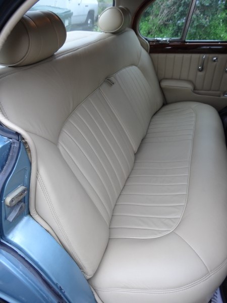

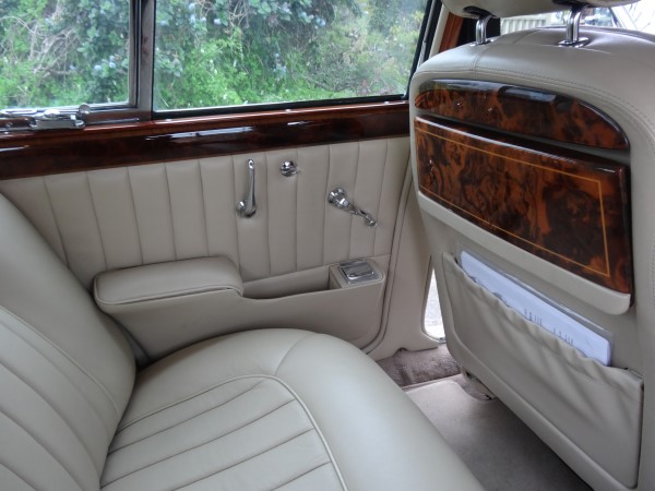

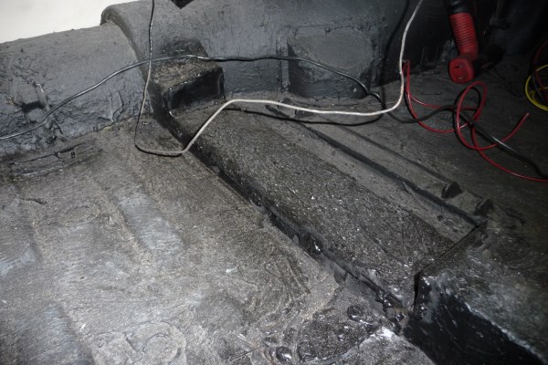

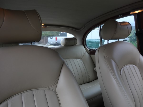

I used a Vadan Plas as I wanted the wooden picnic trays to give it that cool look. You do need some minor metal mods on the mounting but not that hard nor expensive if you have a shop do it either.
Definitely the stock seats are very uncomfortable and my car being so fast it would be a dangerous ride without modern seats.
Attached Thumbnails Alternative front seats for S type?-dsc04773.jpg   Alternative front seats for S type?-dsc04763.jpg   Alternative front seats for S type?-dsc04760.jpg   Alternative front seats for S type?-p1100201.jpg

My seats were made from around 2001 to 2003 XJ V8 Vaden Plas The back seats are 1 foot longer but you can have an upholstery shop section it to enable it to fit.
