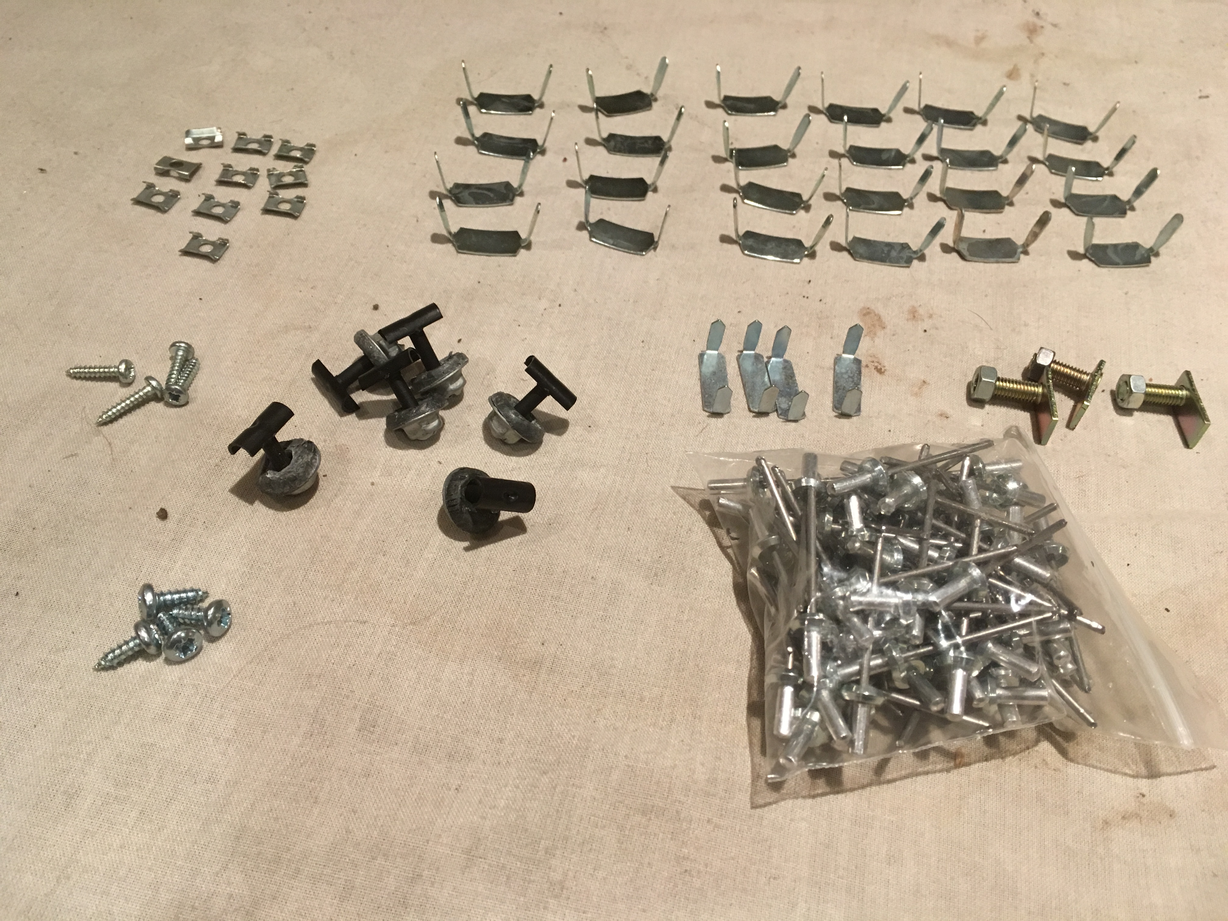

Ok, I have been through the kit and SNG website, and tried comparing this all to the kit, so here's my best try :-
Center ish 6 plastic clips with threading nuts (BD20887)are for the number plate chrome
4 staples center right are also for the number plate trim lower section (BD10809)
Threaded clips with nuts, (BD9848) 2 are for the lower front door trims and the third for the lower center bonnet trim below the Mascot
Top left these are for the bonnet center trim, (BD9851) but do not know what they fix with (I assume rivets), they are correct as far as part no goes and match the picture in the parts manual, but the fixing of them is not showing on either SNG or the parts manual !
Top right are for the bonnet side trims BD11546
The rivet clips are for everything else.
Oddly SNG list a clip SBS7777 which supersedes BD28982 for the scuttle panel trim, but do not include this in the kit !
The parts catalogue lists the rivet clip as BD26706/1 and BD26706/2 for different trims, but I do not know what the difference is, and SNG supply the BD2706/1 in place of the /2 rivet.
The parts catalogue lists clip BD11719, which is for different places on the trims and lists a pop rivet for fastening the clip. This clip looks identical to the bonnet clip in the parts catalogue, but has a different part no so maybe wider or thinner.
I will call SNG and see what they say about the fixings for the bonnet clips, the missing SBS7777 clips, and what on earth the self tapping screws in the kit are for !!

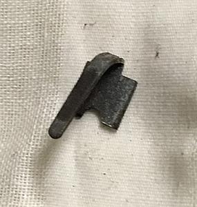

Those clips that you said were for the bonnet center trim match what I found in a parts baggie today marked center bonnet clips. They don’t attach with rivets- you push them onto the slit in the hood at a slight angle, and twist them to straighten them. Then the center chrome piece pushes down on them and they hold each other in place.
Old center clips
Of course now that I know the correct way to install it, I am not sure my new kit has the correct clips, so i may try the ones I fabricated and see if they work. If not, I now know where to get the correct clips,

The bonnet trim clips you have above are not the same as the ones in the SNG kit, yours have one piece bent down and two smaller tangs facing up, the longer downward tang must sit in the bonnet slot and the two smaller tangs grip the trim.
The ones from SNG only have tangs facing one way !
If the one longer tang goes into the bonnet slots, are the slots slightly off center as the tangs are on one side and would put the trim to one side of the slots ?

The center hood trim clips have two tangs on the bottom facing in different directions. You set it over the slot on the hood and twist is straight, then clip the trim piece on from the top. Here is a picture of one I have.
Trim clip
According to the very helpful post from BSM, that clip should be part number BD 9851.
Most of the clips I removed were rusted to the point the tangs were gone, and the top part was compressed to the point it did not hold the trim well. I may try and get a couple of new ones or refuse the old ones to attach the end of the trim closest to the windshield as my modified side clips did not hold the trim as tight there as I would like. A small piece of double sided trim tape would also be an option. Otherwise, i am pretty much done with the hood, and can set it aside for now.

The part No BD9851 is the same as my post, but the trim clips you have with the 2 tangs are different again ! SNG have supplied yet another clip, looks similar to the parts catalogue picture but no idea how they fix, the ones that came off my car were different again !!!
Can you post a picture of the kit you were supplied Chuck, or is it the same as SNG ?
