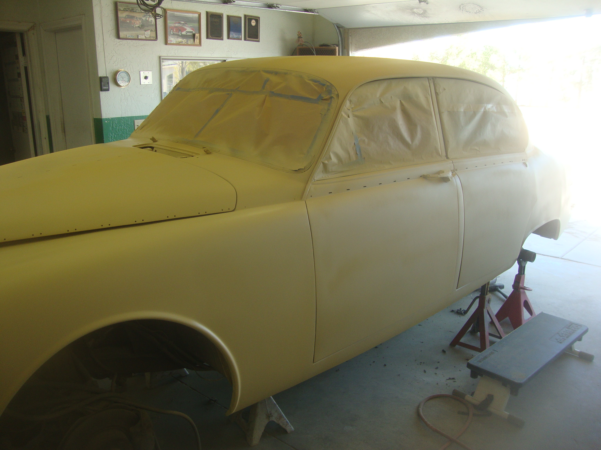

Everything in my garage has a thin coat of yellow upon it
Bodies looking pretty good though. This guy is good and is quickly dealing with major problem areas. I came home last night to discover a nice right rear flank where there were big ripples. Turns out he'd mixed some of my lovely glasurit high build primer and shot a bunch of the right side. In the flourescent lights it looked identical but today in the sun I can see where he primed. Very pleased so far....:icon_arrow:
Kennard's back this morning assaulting some of the problem areas. The guy is amazing. We're thinking we'll be buying paint next weekend. I'm leaning toward either my old standby Centari for an ordinary job but I have enough Glasurit products left over to justify that expense. I've got a week to stew on it but I'm thinking Glasso just now. A bit scary, he's been shooting the Glasso yellow high build primer without hardener. It seems OK so far but I broke out the Glasurit manual and showed him the half gallon of hardener....
