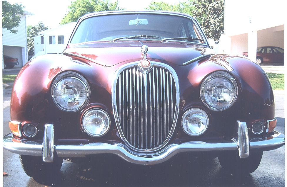

185/R/15 and instead of 70 I prefer the 65, a little wider footprint, so 185/65/R/15 is my choice, at least for my S type.
