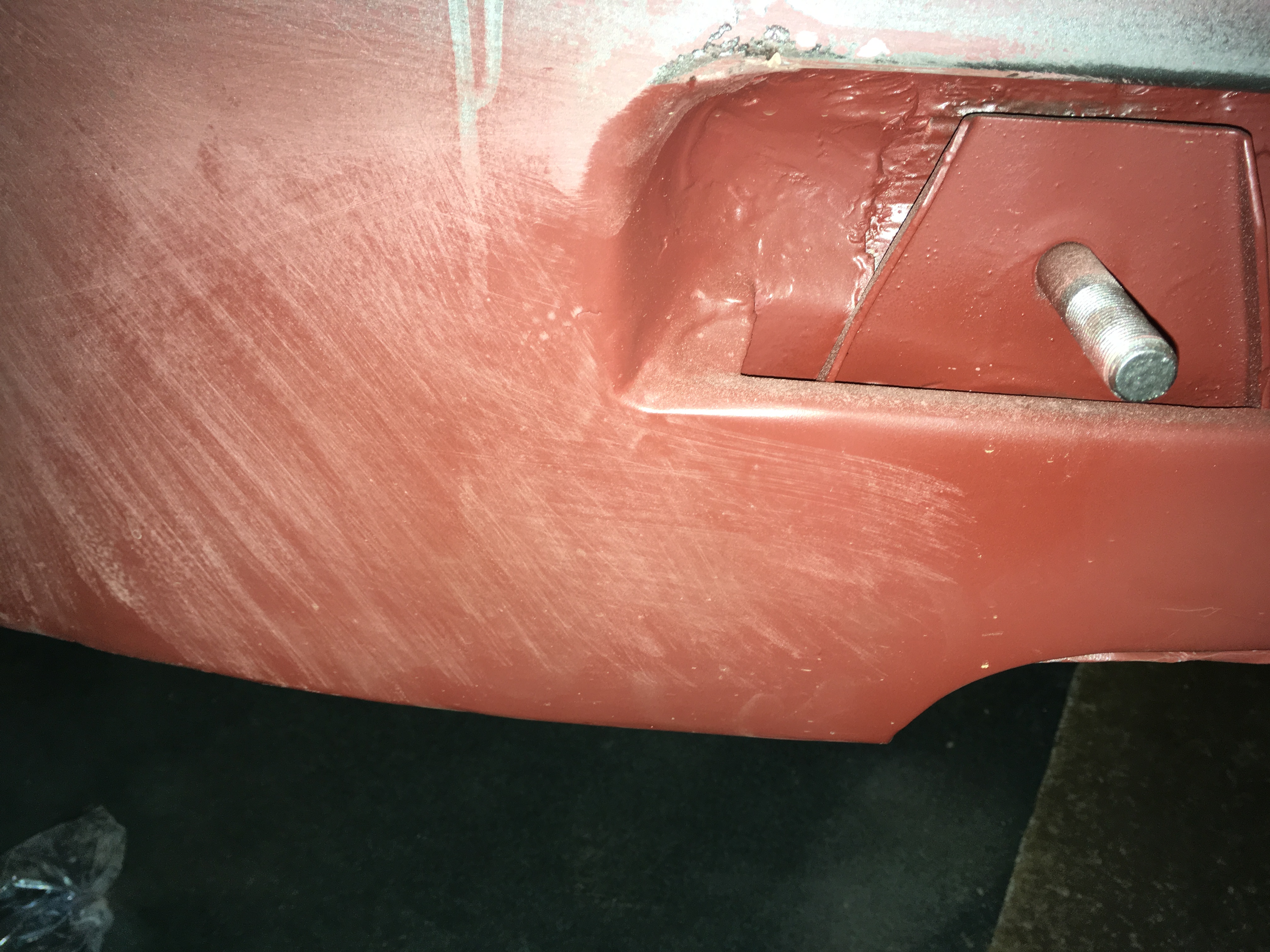

starting body work on my shell
came with this one panel that was torn off and Taco'd
My body guy got it semi un-taco'd to see where and how it fits on the car.
it appears to be covering the bumper attachment bolts when lined up with its previous installed position.
does anyone have thoughts on this? is this a stock panel or is it something that was added later?

yes holding it a bit high in the picture, but lining up the welds and spot weld marks, it aligns on the bottom

That's the rear valence from the thin bumpered 240 /340 / daimler 250, is that correct for your car, it's not the same as Clive's' Mk2 if that's the case.
I can post pics of the 340 version, and yes it does cover the bumper mounting brackets as the bumper mounts are different on the 340 etc. That is stock for those cars and not an afterthought, they are riveted on and welded to the rear wings by the Tonneau panels.
Is this the Daimler shell you mentioned in another thread ?

yes, this would be daimler. and that explains it.

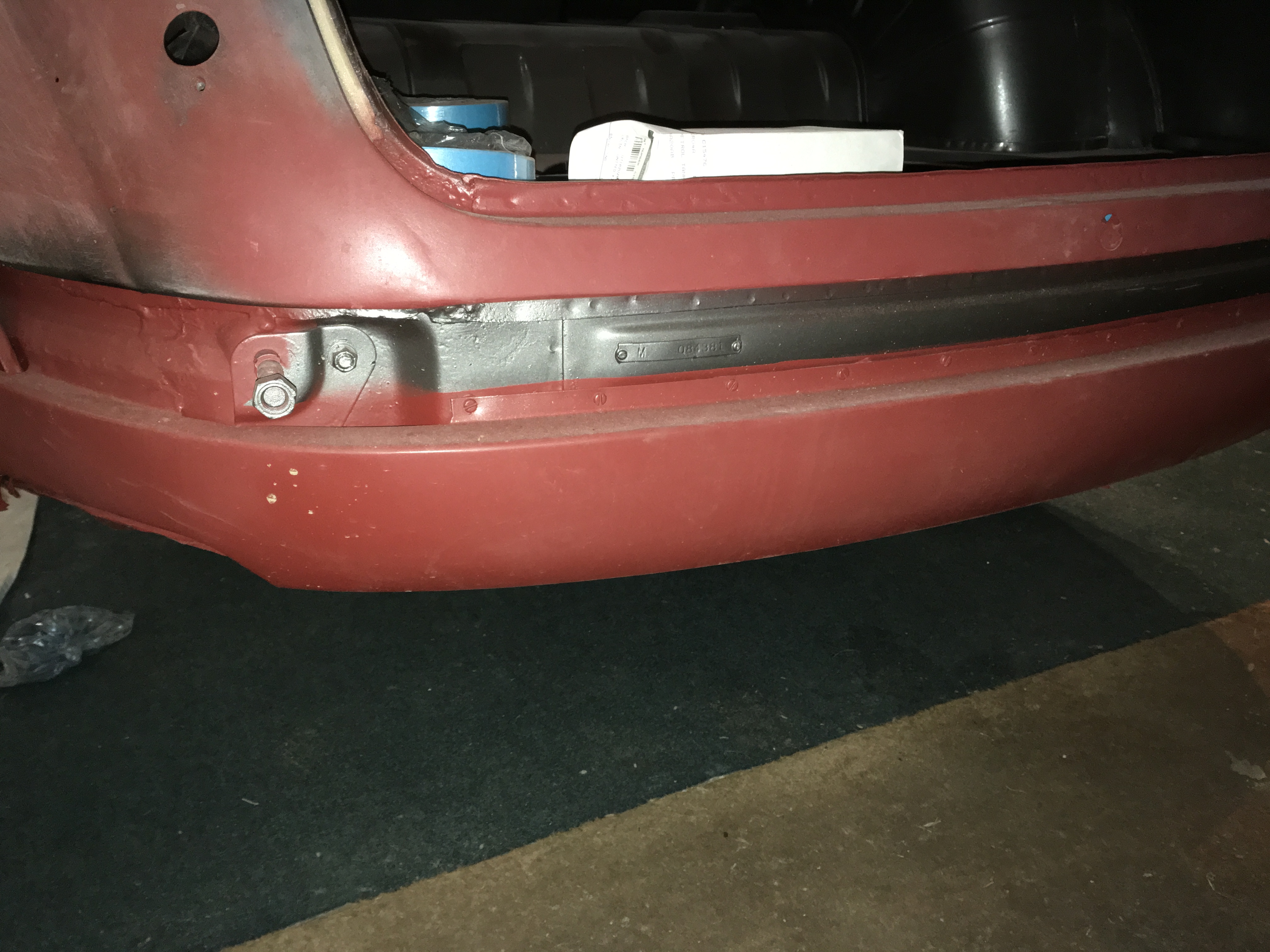

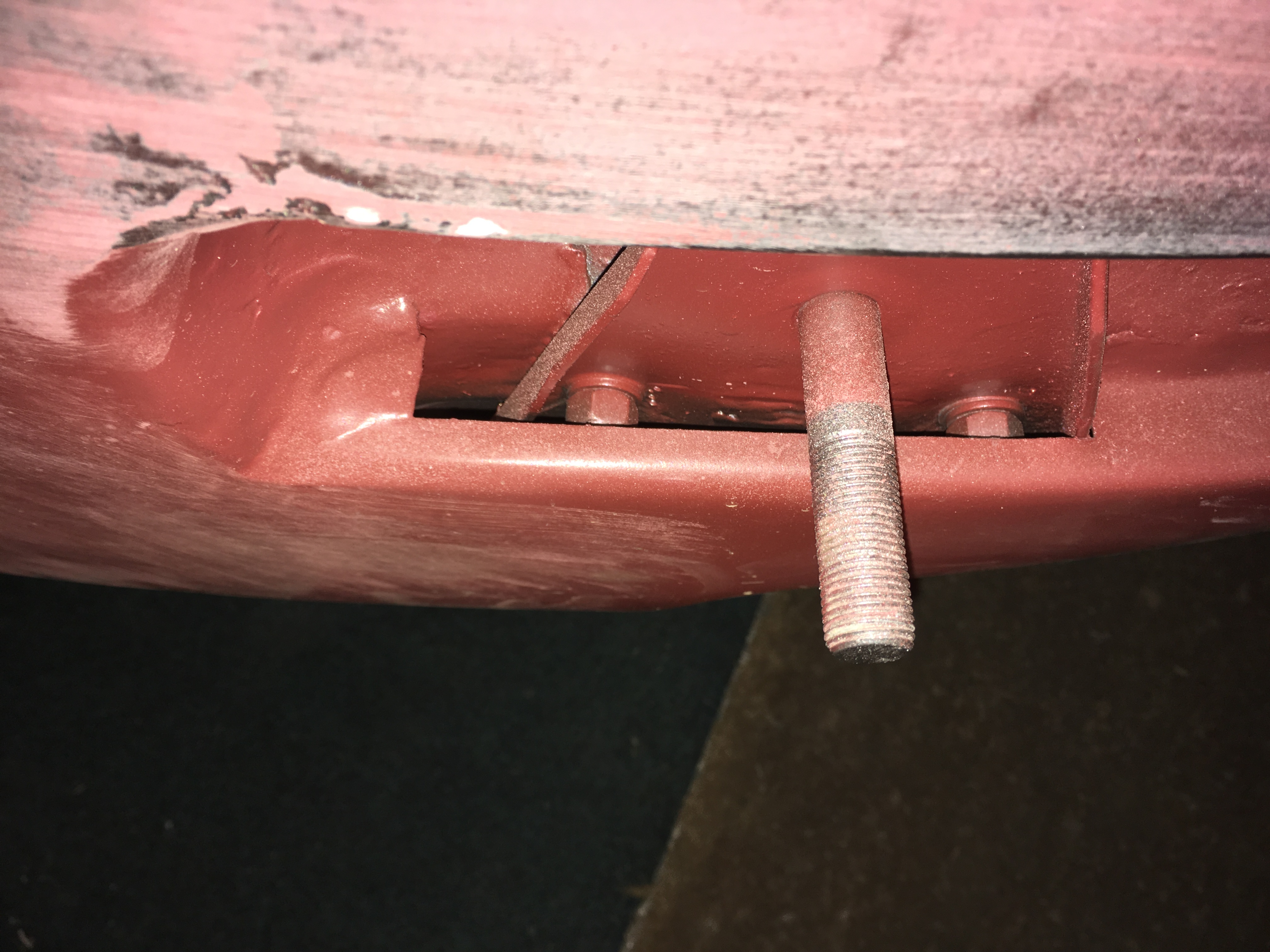

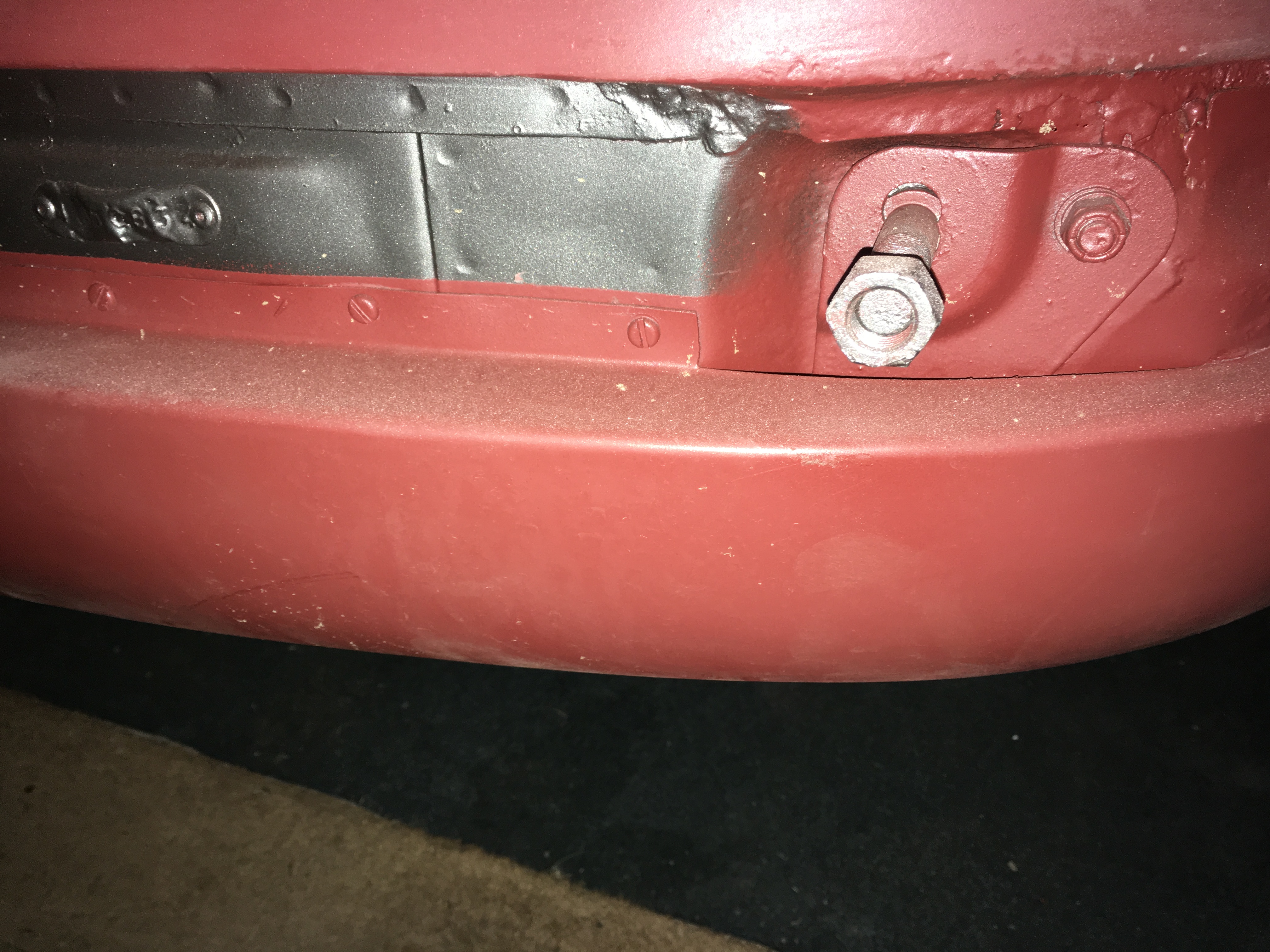

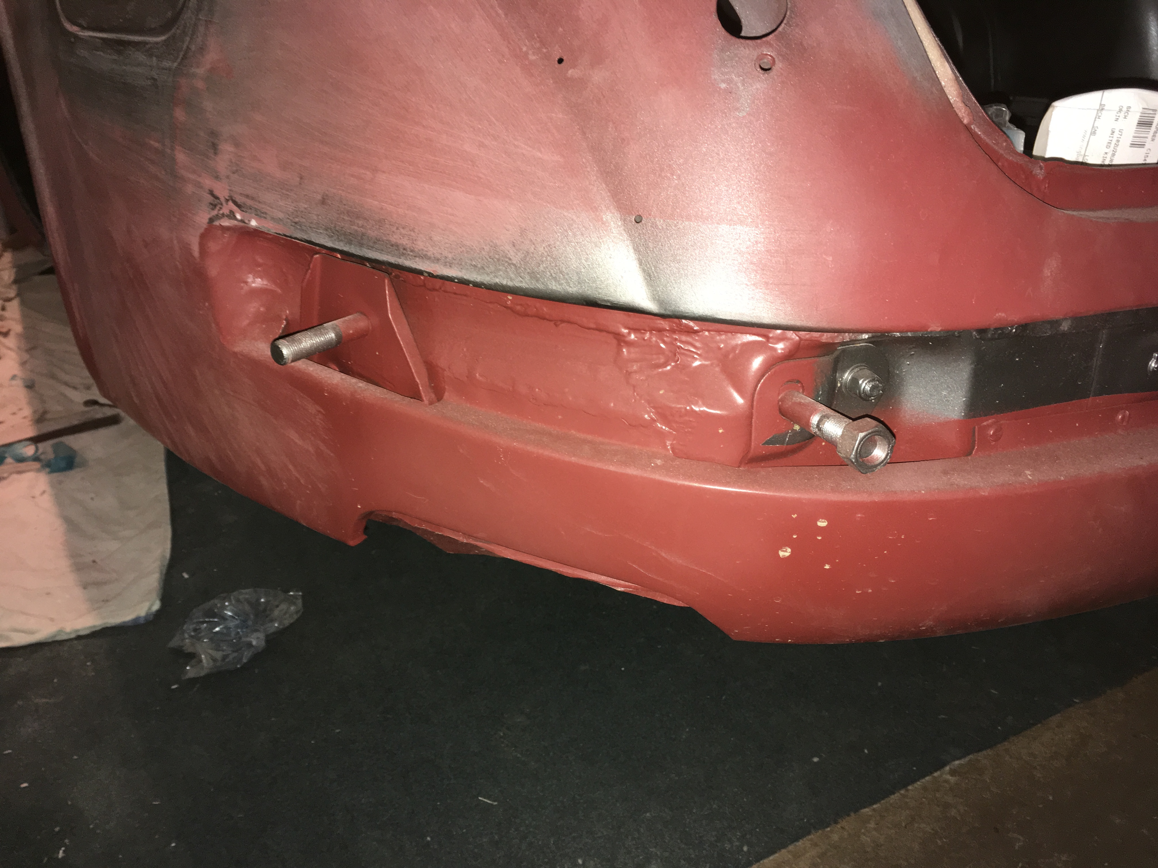

You would see the cut outs below the bumper.
Sorry forgot to post pics, here they are.
If I haven't covered it all let me know.
The section at the rear was riveted, by I used stainless self taping screws instead and the sides by the tonneau are welded in.
Attached Thumbnails Rear Bumper Panel?-img_2469.jpg   Rear Bumper Panel?-img_2465.jpg   Rear Bumper Panel?-img_2470.jpg   Rear Bumper Panel?-img_2472.jpg   Rear Bumper Panel?-img_2473.jpg

Maybe you have different bumper brackets, the panel covers the fixings but the bumper would not cover them if you look at the pics, the fixings are below the panel, and these would definitely be below the bumper on mine.
If they weren't there would be no point having the wider valence for the Daimler and 240/340 cars.
