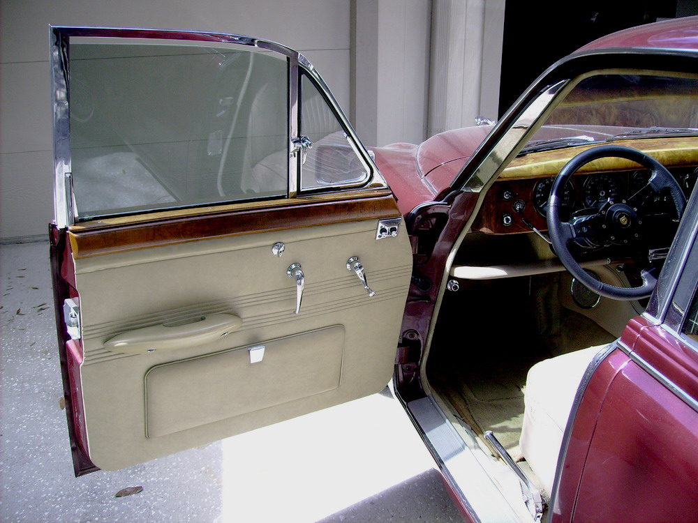

will this picture be of help?
Attached Thumbnails Type S doors to adapt to install in Jaguar 340-mirror-switch-s-type.jpg

Hi José,
This car looks nicer as a niew one..Congratulations.
What i need is a picture of the front and rear catches located on the pillar's.
With if possible the measurements of the exact position of them.
Thanks for your help

Phillipo,
yes, the car is almost like new, it is a treasure. The driver's seat leather is worn, the headliner is collapsed, but it is a wonderful unrestored example.
I understand now. You need pictures of the Door JAMBS, also known as the "B" and "C" pillars.
If someone else does not get them first, I will get pictures next week, I am away from the car this week.
