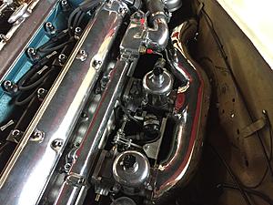

Design and fabricate a "cold air box" which I prefer to more accurately refer to as an "outside ambient air delivery pipe to the carbs." I know that I am biased but I think Mike's concept and Brandon Tyree's execution were spot on. I am quite happy with what they did. See this link for more information: Cold Air Box ? Valve Chatter

![](https://cimg7.ibsrv.net/gimg/www.jaguarforums.com-vbulletin/2000x1504/img_0571_ddfd0bf42e70834aef50fc0ca10550197bdc3ddd.jpg)

The vinyl certainly looks better than the insulation material, but I am planning on a sheet metal cover similar to the heater. One positive byproduct of the carb air pipe is that it takes up much less space at the rear carb than the air cleaner did. It should give me a little more room for the evaporator cover. Thanks for keeping me in mind!
Lin
