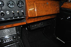

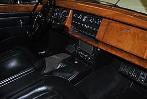

This is what the wood looked like originally. When these photos were taken this 1966 3.8 had only 17,000 original miles on the odometer.

looks fine to me.
