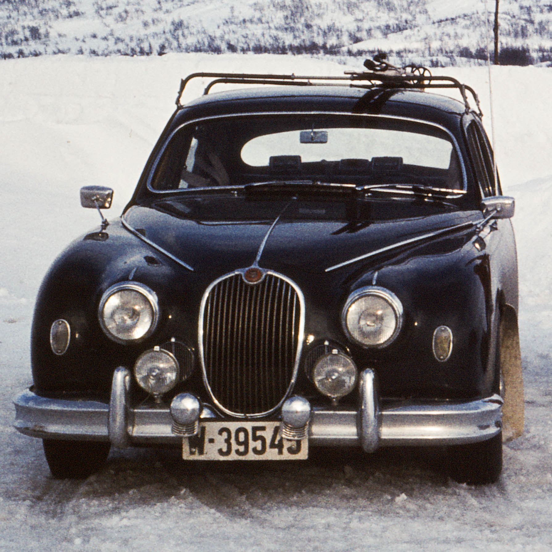

In the first picture, it looks like there is a front wing sitting behind the car (hopefully it fits a Mk1). Where can I get the missing parts like the top of the engine, grille and windshields?
The seller asks 19.000 NOK the equivalent of 3.200 USD. If I'm buying the project, I'll do as much as I'm able to myself.
Showstoppers would be if it is impossible or way to expensive to get hold of parts. I'd love to hear from anyone that have experience from restauration or searching for parts to old Jaguars.

yes I can see the spare wing, but $3,200. USD is a lot of money for a wreck like that. I do understand sentimental value but only to a degree.

The Mark 1 is not a car that people go after much, the Mark 2 was a much better car, frankly, that's why Jaguar developed the Mark 2 out of the Mark 1. Of course it has a certain period charm.
The price is very optimistic in my opinion. If it is of sentimental value to you then go for it, but don't expect a cheap or easy job. The mechanical parts are virtually all the same as the Mark 2 with a few subtle differences. You can, of course, upgrade a lot of it to the better Mark 2 spec. AFAIK, the cars didn't have the disc brakes and road tests of the time complained about the brakes in subtle terms, (no British road testers of the 50s ever complained much about British cars). The interior trim is different, the doors are completely different.
In the end, it will be cheaper just to buy a complete and restored Mark 1.
![Default](/forum/images/icons/icon1.gif)
The asking price is immaterial. The cost of restoration will be so high that paying 19 NOK, 190 NOK or 19.000 NOK is insignificant compared with how much you will have to spend.
What can't be seen of the floor and sills will be in considerably worse condition that the exterior panels that can be seen. Chrome, trim and glass are difficult to source and very expensive.
Unless you are a phenomenally wealthy individual and can afford to drop the equivalent cost of buying a house into this project then don't even consider starting.
if it was me in your situation, I would offer in the range of $600.00 USD as is, where is, telling the seller "in the condition it is, it is not worth more than salvage price", and be prepared to walk away from it, or haul it away if the seller agrees.
I really doubt the seller is going to get near $3,200. from any buyer.
as Mitchell and GGG said, it will cost you a lot of hard work and lots of money to get it to the condition it was when your father had it.

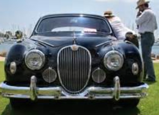

By the way, the car in the picture must be one of the later MK-1 with the wider MK-2 grille, the original MK-1 grille was narrow. so chances are you can fit a MK-2 grille just fine.

look at both pictures below:
the early MK-1 grille (picture on left) had less vanes, they were thicker and more separated from each other, and the entire grille was narrower;
the later MK-1 grille (picture on right) had more vanes, they were slimmer and closer together, and the "egg" shape of the grille was wider.
I don't know when this change took place but it must have been near the debut of the MK-2. So you might be able to fit a MK-2 grille, at least that's what it looks like in the picture of your dad's car.

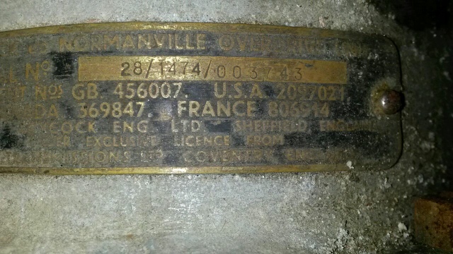

I've found the transmission serial number. Is it possible to look up the vehicle identification number from the transmission number?
If I'm lucky it can somehow be matched with this number: 39—41471
I have no idea what that number is, but it was written on the old transfer of ownership papers from 1975. It might be vehicle number, engine number, or the phone number of the new owner (!!?!)
Here is a picture of the placard on the transmission.
there should be a placard somewhere, with all the numbers, (VIN, Engine, and Transmission numbers), have you checked on the driver's Door or door jamb?
you might contact the JDHT (Jaguar Daimler Heritage Trust) to see if they can tell you where the placard should be. Also check their ARCHIVES/CHASSIS NUMBERS page, Click on the link below:
On the Mk 2, the car number was stamped on the cross member in front of the top of the radiator, near where the bonnet latch lock is located. Maybe the Mk "1" was the same? If this car still even has this piece of sheet-metal. The storage location for this car looks like a garage in today's Homs, Syria.
On your grille question, the narrow, fewer rib grille was only used on the initial 2.4 litre production up until 1957. For all the 3.4 litre models and the later 2.4s, the 16-rib grille (like on your father's car) was used thereafter. The Mk 2 grille is very different in details, with a thicker central rib carrying an escutcheon at the top with the model badge, and with 7 ribs on either side of the central rib.
On your magic number, if you ignore the leading 3, "941471" would be a proper chassis number for a 2.4 LHD Mark "1" -- but that is a stretch since it would have to be an car earlier than 1958.
