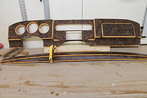

I needed some light duty work and ended up reveneering the dash pieces. This time the bookmatch on the dash top is centered (I knew if I didn't fix that it would bug me every time I drove the beast). This veneer was more highly figured than the last batch so we redid everything for consistency. Just a little patchwork and finish sanding on the crossbanding and we'll be ready to shoot. Can someone tell me how the ends of the gauge and glovebox panels are finished? I'm assuming the outer ends are burl and the inner ends are crossbanding.
Chuck and Jon, I ended up purchasing a Devilbiss Tekna Pro Lite, which came with a nice digital regulator. I think I've asked before but would it help to purchase a lamp for curing the clear? I see some portable units that are 2 and 3 feet long - thinking if this was the difference between minutes vs days for cure time between coats it would be worth the investment. Thanks.

If I understand your question right, Jaguar didn't worry about those areas because in the normal setup, the gauges covered the edges up and the glove box edges were not touched at all. AFAIK...
However in your case, you may do what RR/Bentley did.
They coloured the finish and simply painted over the lamination edges. The edges have to be sanded very smooth, allowing them to fill with finish once you start building layers.
I used Blend-All powders when I did my 51 MK6 Bentley.
Medium Brown Walnut matched the original, but I never liked that colour, it was too light, so used Extra Dark Walnut.
The darker colour matched the over-all pallet of the veneer and gave a nicer contrast to the banding.
The powder can simply be added to a small amount of finish and brushed on before the first spray.
I used a good quality sable hair brush for water colours bought at an artist supply store _ cost about 35 bucks.

Now that I read your post Jon, I think I understand what Doug is talking about.
My car is not burl in those places, just simple walnut straight grain veneer, no figuring.
I think your car is so heavily modified Doug, does it really matter ?
Why not just go with burl ?

I looked at mine again, you are right Jeff, much plainer, but as you say, just go burl if you have some for sure.
