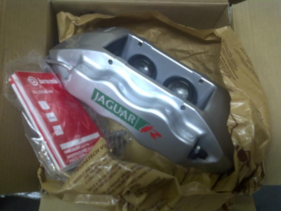

Hey guys,
Im having a little trouble figuring out if the front Brembo Calipers can be rebuilt. I am in the process of getting parts together in order to upgrade my front brakes.
My issue is that I cannot seem to find any vendor that will give me a straight answer to the following:
1. Is there a rebuild kit (pistons, seals, dust boots) for the Brembo calipers?
2. Are the remanufactured calipers available via rockauto, centric etc.. the excact same as OEMs? That is, if I order a remanufactured caliper, will it be identical to the Brembo calipers?
The reason I ask this is because one of the calipers I sourced from a fellow forum member needs to be rebuilt. The other is brand new.
I tried calling many different places and since none of them have online pictures available, they could not tell me what the replacements look like.
Thanks,
Gabriel
Below is a photo of the calipers:

Old 11-24-2011, 05:34 AM
barney100golf's Avatar
Join Date: Sep 2011
Location: England
Posts: 110
Received 19 Likes on 16 Posts
Have you tried here Replacement Rotors, Pads, Hardware although they recon that in street use the seals should last for life

Old 11-24-2011, 09:17 AM
gabrielduenas's Avatar
Join Date: Jun 2011
Location: Houston
Posts: 104
Received 16 Likes on 12 Posts
Originally Posted by JagV8
Have you tried Brembo?
I did. They couldn't help. Couldn't even get the bolts from them
Old 11-24-2011, 09:22 AM
Join Date: Jun 2011
Location: Houston
Posts: 104
I was saving this option for last.
I contacted them. Unfortunately I have to extract each piston and provide measurements.
I am reluctant to do this on my own.

Old 11-24-2011, 05:33 PM
clubairth1's Avatar
Join Date: May 2009
Location: home
Posts: 9,471
Received 2,448 Likes on 1,922 Posts
Is there any reason you are not using the Jaguar parts?
They shown a "Piston Service Kit" Which sounds like what you need. Try part #C2C24011 for the 2003-2005 STR front with Brembos.
I like Dan at Nalley Jaguar. Very helpful to forum members!
Old 11-25-2011, 11:29 AM
Join Date: Jun 2011
Location: Houston
Posts: 104
Just talked to nalley, very nice people.
The part number referenced is actually the dust boots and seals only.
Old 11-25-2011, 05:17 PM
clubairth1's Avatar
Join Date: May 2009
Location: home
Posts: 9,471
Good to know. Thanks. Maybe you can find just the piston somewhere and then have a full rebuild kit?
Does the piston need to be replaced? Is it scored? I have seen some corroded ones too.
Old 11-27-2011, 12:47 AM
crocodile62's Avatar
Join Date: Aug 2009
Location: Swizerland
Posts: 82
Received 8 Likes on 6 Posts
Brembo calipers used on r types are the same used on AMG, they are prone to failure on intensive use due to the aluminum pistons.
On race cars is standard to change them with iron ones
All the parts you need, except iron pistons that have to be custom built are Brembo.
You can buy them from Brembo dealer without any problem
Old 11-27-2011, 09:28 AM
Join Date: Jun 2011
Location: Houston
Posts: 104
Yep two of the pistons are in really bad shape
Old 02-29-2012, 10:18 AM
Join Date: Jun 2011
Location: Houston
Posts: 104
Just an update:
I found a vendor that offers a rebuild service. I plan to send one of the calipers to be rebuilt. Looking to do this within the next couple of months.
