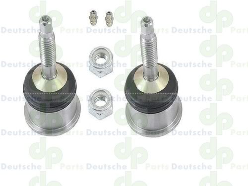

Ok guys so the second order of ball joints was also incorrect. Vendor was very polite and I am getting a refund on the parts.
I decided to bite the bullet and decided to buy the complete assembly from Welsh enterprises for $195 each. So for anyone looking to replace these on your vehicle:
Please verify the last 6 digits of your VIN, If the number is after M45255, the complete arm must be purchased, you CANNOT buy the ball joints separately.
Ball joints purchased that did not fit, 14 and 16mm up to M45255:

The guy who had them pressed lists his car as a 2000 so probably falls into the before M45255 category.
