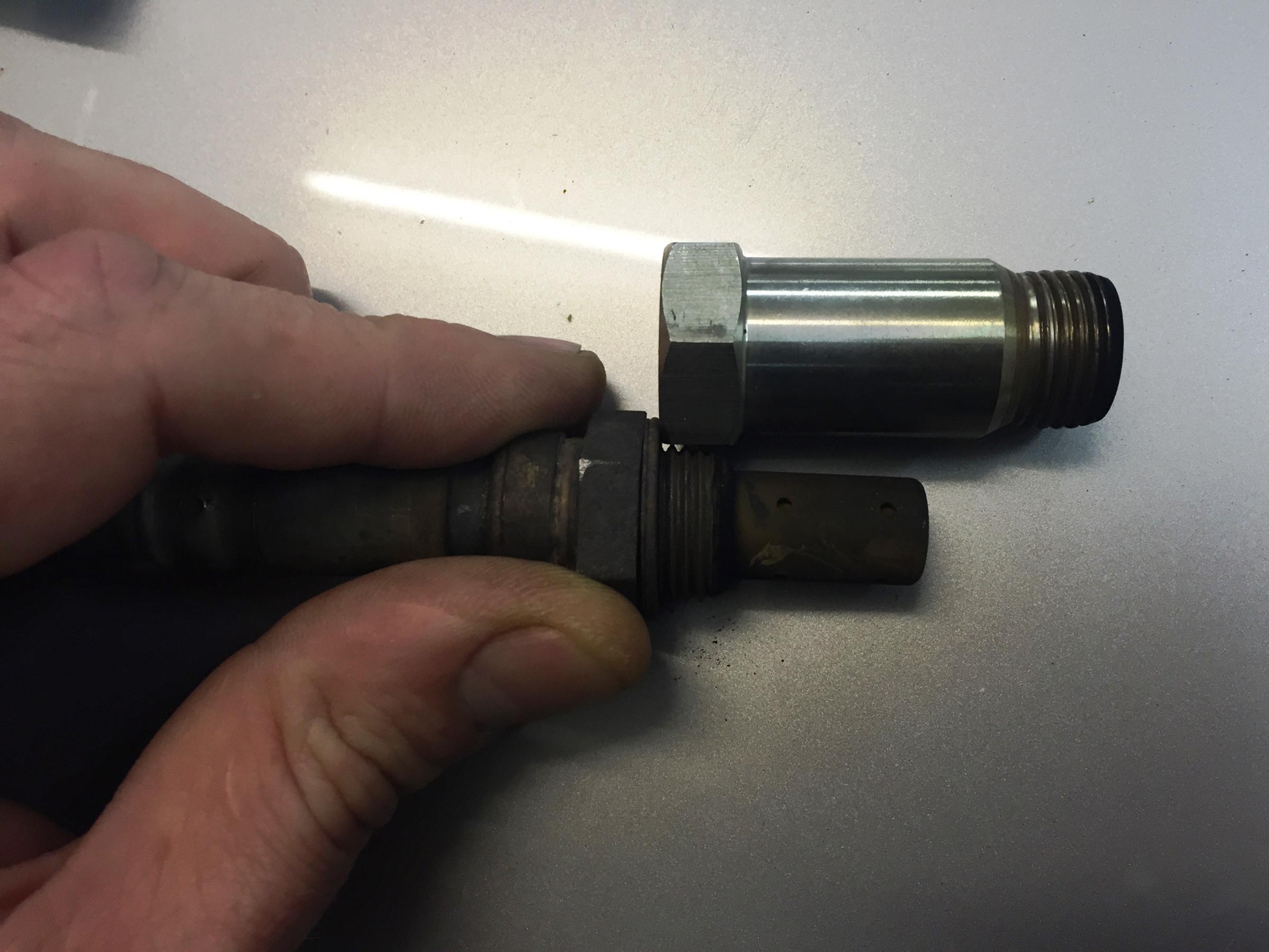

My '05 STR has 78k miles on the clock. I have 4 new Denso sensors, 2 new 200-cell cats and 2 plain extenders (see pic) standing by, just waiting for the MIL.
My question - how much change to normal fuelling can I expect to see once I have fitted all the above?

Well you saw the difference to the highway fuel consumption on the XJ.
I can't tell you exactly how much difference.
But for sure it's not going to be "right" with the downstream sensors being fooled by extenders or minicats.

Wow, that difference is about 2 mpg UK!
So the erroneous low-oxygen signal from the sensors by the the minicats causes the ECU to unnecessarily increase the richness of the fuel mixture, reduce the mileage and mess up the fuel trims. I get that.
What puzzles me is why you would use a minicat in the first place. A sensor in the downstream airflow from a 200-cell cat would signal too much oxygen. As it is removed further away from the main airstream (with an extender) there will be less airflow across the sensor, and it would eventually signal too little oxygen. Somewhere in between is a position where the sensor signal would be the voltage expected by the ECU if OEM cats were in use. Any way this position could be determined, maybe to the nearest 1/4"?
Maybe it's not possible. Maybe I have got the theory wrong. Can you put me straight, Cambo?
All of the extenders will cause a slow reaction of the O2S to the mixture change. It will hurt all of the transient conditions and it may lean a mixture in a cruising conditions (this will affect a milage, increasing a fuel consumption). Transition from a cruising to a power enrichmet will be affected too, it may cause a detonation (in a hot weather). Also, in some situations a EGT may rise too high, causing a damage to a cat converters and/or exhaust valves/seats.
The best way to fit a custom cats or to remove a cats is to flash a proper tune and leave secondary O2S in place.
