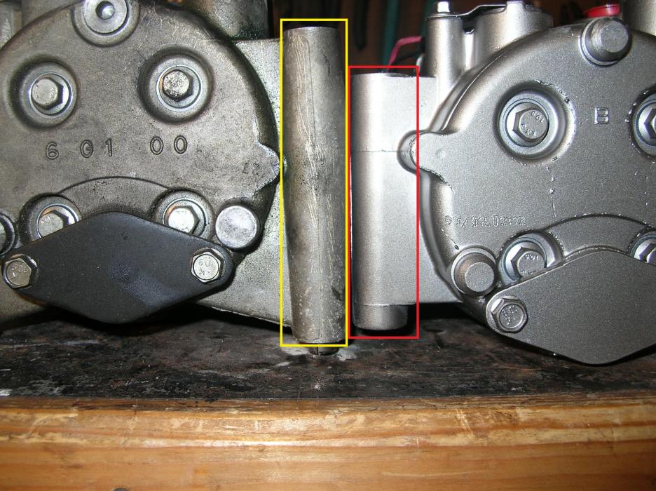

Thanks guys heres the new scoop.
The remanufactured compressor is wrong part, although it is listed as a 2005 Jaguar S Stype replacement AND Lincoln LS. I could make it work but for $165.00 (2nd day air included), we will wait for a replacement. I could use 1/2" spacers to make the reman work.
The good news is that it took longer to drop the belly pan than it did to drop the compressor. I spent 1/2 hour from jacking up the car to having compressor on work bench!
Ok I see I did not explain the difference in the 2 compressors below. In the yellow rectangle the bolt guides are about 4" long for the 3.0 litre engines. The red rectangle is for the V8 engines with the bolt guides at 3 1/2" long.
Attached Thumbnails AC low side line at 73 lbs. preasure-ac-compressor-comparison.jpg
