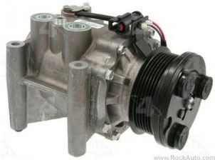

My on-line research late yesterday confirms that our S-Type 3.0 uses the same compressor as the Lincoln LS. Omega (omega-usa.com) has a large presence in the automotive compressor distribution market - they offer the same compressor for both the S-Type and the Lincoln LS. The problem may lie in convincing an A/C shop to install a part that they don't source (and mark up) themself. They certainly won't warranty it....
My serpentine belt seems to have proper tension on it and appears to be in good condition. I've installed replacement serpentine belts myself on my Ram and on my wife's previous Lexus SUV in recent years, and I'm accustomed to a "give" of perhaps one-half inch when pressing down on the belt with my thumb. I assume that's proper for the S-Type as well. If it is not, speak up please....
Standing over the engine bay with the hood open and the engine idling, I do not hear any unusual sounds eminating from the compressor. But that component is down at the very bottom of the engine bay. It may sound quite a bit different with the car up on ramps with the undertray removed and me lying on the ground listening to it through my mechanic's stethoscope. I will do this today before making any final decisions on how to proceed....
The compressor's clutch is engaging when the A/C system is turned on. Keep in mind that the system cools the cabin, just not very strongly or efficiently....
Yes, I've thought about the compressor potentially being damaged by the jolt that occured when the car was front-ended last August. The A/C was running at impact. It continued to function as I drove the car home after the police finished their accident investigation. Could that jolt have taken this long to finally cause the compressor to begin to fail? Was the A/C system improperly evacuated and recharged during accident repairs after the condenser was replaced, and that improper charge has now caused the failure of the compressor? Who knows? I thought there is a pressure relief valve in the system to prevent overcharging from causing compressor damage, but perhaps I'm wrong about that....
So George, how do you obtain definitive proof that the compressor is indeed failing? If it is in the early stages of failure as described, it is possible that we cannot hear it yet....

This is where a good relationship with an independent mechanic comes in handy. Granted I'm spoiled in having a shop in the family, so I have access to whatever parts I want at cost, but beyond that. Any reasonable mechanic should be willing to install whatever parts you specify. That being the case, you may even think about a DIY repair here. Having the system evacuated, then recharged when you are done...
As far as I know there is no pressure relief valve - Remember the EPA ****'s have made it illegal to release even non HFC refrigerant into the atmosphere. What there is is a pressure shutoff valve, if pressures spike, such as would be the case in the condition of an overcharge, it will shut the A/C compressor down before it bursts a line. I really want to know idle and 2500 rpm high and low side pressures here. I think there still might be some sort of undercharge issue. I just cant see a perfectly quiet, working compressor somehow losing some of it's efficiency. The clutch may be an issue as well, THAT could cause an underdriving of the compressor. Jon, once again, In all my experience I have never seen a compressor failure manifest itself in the matter you are describing. It either working while sounding like there are marbles in it, or not working / ceased.
Do yourself a favor - when the compressor is engaged, look at the clutch plate -compressor side - is is spinning at the same rate as the pulley? Hint a couple of dots of paint and a timing light work wonders here. If not that may be the issue. I wonder if the clutch is available separately?
I really don't know about belt tension specifics on the S-type, I assume from your post that the A/C compressor is on the serpentine belt, and relies on the clutch to engage / disengage it?
Definitive proof of the compressor failure - once you are CERTAIN that it's driven at the proper speed, is a proper low side pressure - (think of this as the input), combined with a weak or low high side pressure. An elevated low side pressure will show some sort of internal leak in the compressor - basically at rest (compressor off) low side and high side equalize.
Honestly Jon, and I know you don't want to hear this dirty little secret... I'd add a bit of freon to the system. I bet you it cools the car down. Since the compressor can do a semi decent job of cooling at speed, all you need to do is raise the input pressure to get the output pressure to the right place. You wont hurt anything.. There are failsafes built into the system to stop it from dangerous pressures. (and they are on the high side). Sure it will strain the compressor a bit more but if it's on it's way to compressor heaven, then so be it, I can almost bet you will buy yourself time.
The key here is get the car on the gauges. I think autozone / advanced auto or whatever flavor of parts store may even rent them.
Take low and high side readings at idle with A/C on max, and with the engine at speed.

I just checked, the clutch is available in 3 parts.
The coil (engages / disengages the clutch). - Motorcraft - YB595
The hub - Motorcraft YB594 - Possibly superceeded by YB3124
And the pulley - Motorcraft YB592
Taking a look at the Compressor with clutch installed... What you want to do is mark the belt relative to the pulley. If there is belt slippage, the marks will come out of sync. You're not going to really be able to determine the input shaft speed v/s pulley speed. I don't THINK.

Now, before you go dropping $1200 on the Jag Branded Compressor and install etc, lets see if we can get this thing diagnosed 100% correctly. I would seriously talk to the shop about Lincoln parts as well... I have NO doubts that a new compressor, complete with new clutch will solve the issue. And the $35 (at least motorcraft branded) reciever / dryer makes sense anytime you open the A/C lines to outside air.
My questions are:
Is the belt tension proper, and is the clutch ok? - The clutch IS externally replaceable. And are we 1000% sure the car has the proper charge. Only the gauges will really tell us.
Mark the belt and pulley. See if the belt slips.
Check the pressures high and low.
As far as this somehow being related to the accident - my only suspicions there would be if the dryer held moisture that couldn't be boiled out with a vaccum and it wasn't replaced when the condenser was. (but this would manifest itself earlier) - If the condenser was in fact compromised, and you ran the A/C post impact you certainly put some outside air in the system - or at least exposed the system to outside air. - You were probably leaking refrigerant mostly though. (Unless the condenser was damaged in a way that did not create a leak in the system).
The other thing would be potential misalignment of the pulley, or slight tweaking of the clutch hub if something got pushed far enough back to touch the A/C comp. The other thing here may be a tweaked or partially kinked hard line restricting flow.
George

Where are you finding the Lincoln LS compressor and clutch assembly for $254 and the Lincoln LS receiver/dryer for $35? And what are the Motorcraft part numbers for these components? That may be worth chasing down myself, if the shop is willing to let me supply my own parts (and I'm sure that's a big "if" - most shops around here won't do that). I'll gladly pay them for their A/C expertise, equipment, and labor if I can supply my own parts. I think that's a very fair compromise from a total cost standpoint....
Remember, you're spoiled rotten by your brother's shop so your perspective is quite different from mine. The rest of us can only wish we had that kind of arrangement....
