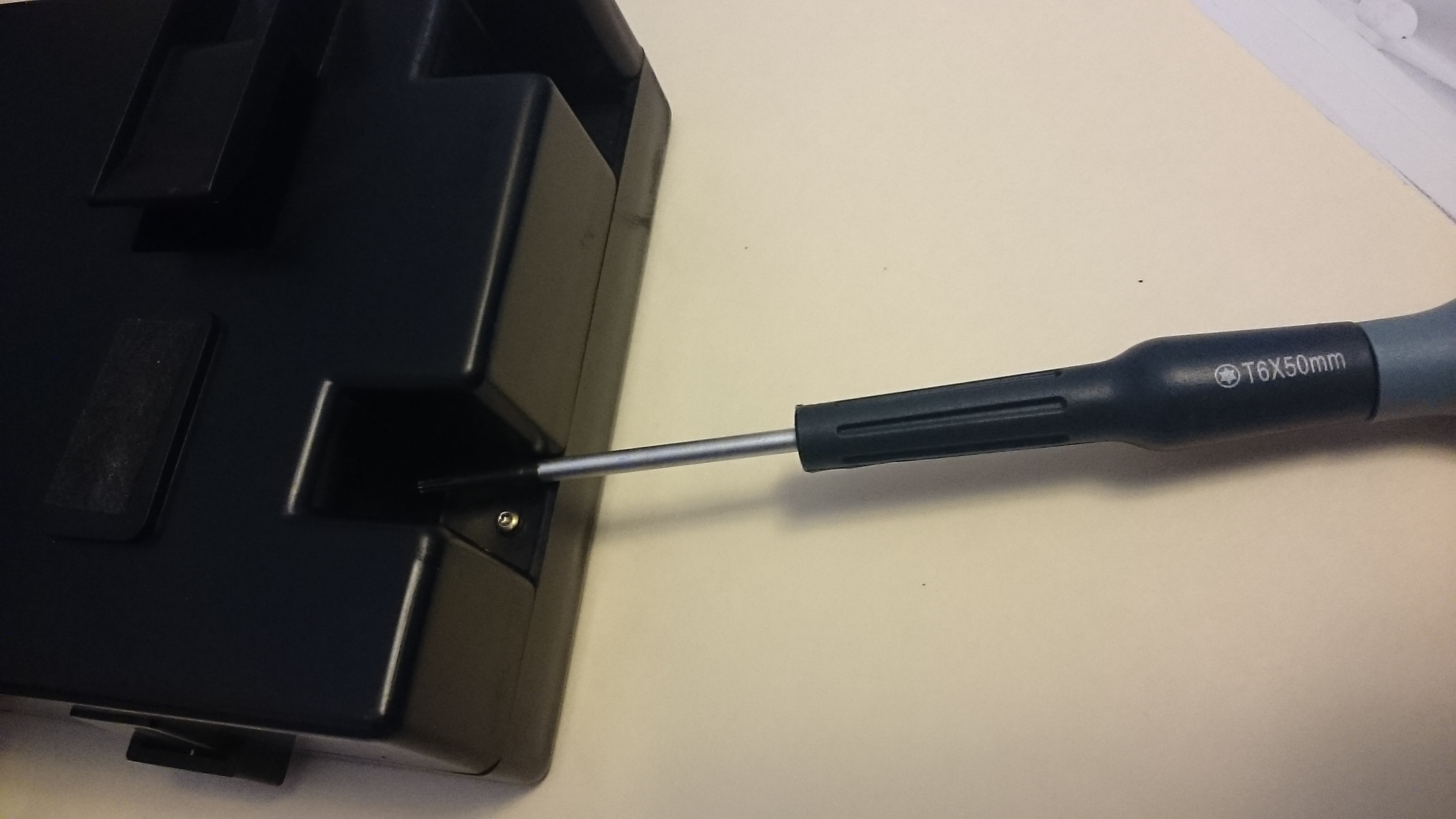

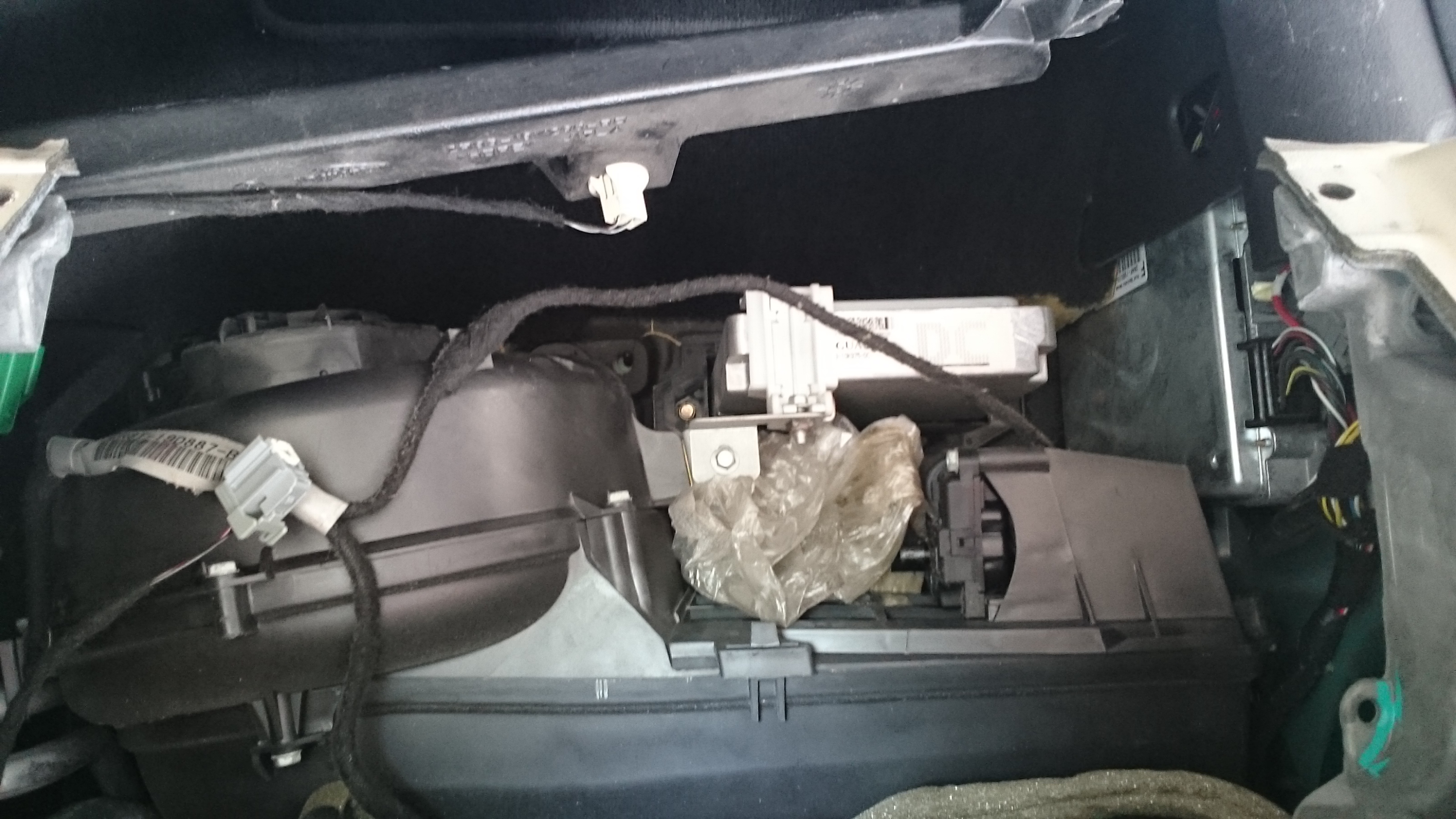

Default No obvious damage
As per photos after accessing RCCM I was disappointed that there was no apparent damage. So back to the drawing board..
Symptoms that appeared from the start of problem: long delay in reaching mid point on the gauge (engine temperature), on cold days temperature gauge actually dropping to quarter (never seen that before either) and compressor not turning on instantly despite touching the Nav screen, compressor will usually engage after 20-30 minutes driving and blows nice and cold.
So just driving with new DCCV until I work out what to do....
Note that a T6x50mm driver required to unscrew module case and if you are down there check nothing is in the duct behind module - found some nice plastic that must have been sucked through outside ducts?!
Attached Thumbnails Another hot air/cold air thread.-plasticinduct.jpg   Another hot air/cold air thread.-rccmtop.jpg   Another hot air/cold air thread.-rccmscrew.jpg   Another hot air/cold air thread.-rccmbottom.jpg

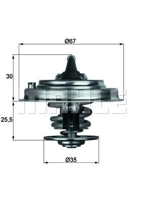

I have ordered a VW/Audi/Skoda thermostat -BEHR THERMOT-TRONIK TX 30 87D- which has the same dimensions I believe at $18. It comes with a seal as per photo but I am not sure if I can use this and if a gasket of some type is required?
Attached Thumbnails Another hot air/cold air thread.-078121113c.jpg   Another hot air/cold air thread.-334971.jpg

Well it's up to you but I bit the bullet and used a Jaguar thermostat for somewhere around the $25 price range.
Yes the thermostat has a seal that looks like an o-ring that goes around the OD. Are you aware of the "jiggle" valve and how it must be orientated?

Hi Clubairth1, around $25 in the USA but $75 here in Australia; we get screwed big time here, our cars are double the price of yours in the US..2015 XFR new was about $210,000 on road before you start ticking the options..Good STR's still pulling in about $25,000 here.
So we have to be more resourceful here, Jaguar dealers are about $190 per hour labour, slightly less than BMW, Mercedes, Porsche etc..
Changed lots of thermostats and the gaskets in my older Pommy cars but I would have no idea of the 'jiggle' valve or what to do in my STR. I assume the o ring forms the gasket?
cheers
Attached Thumbnails Another hot air/cold air thread.-tx3087d.jpg
