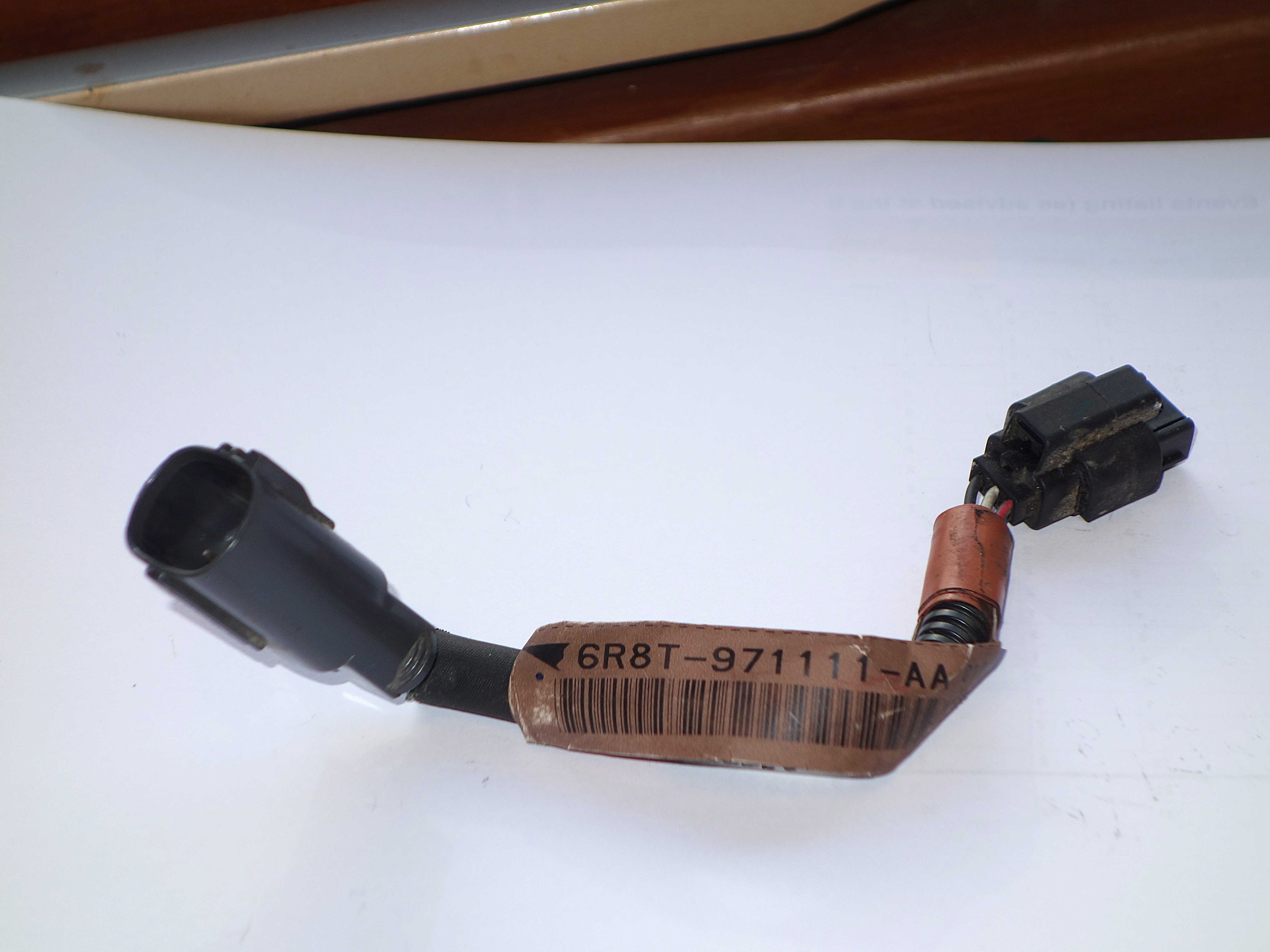

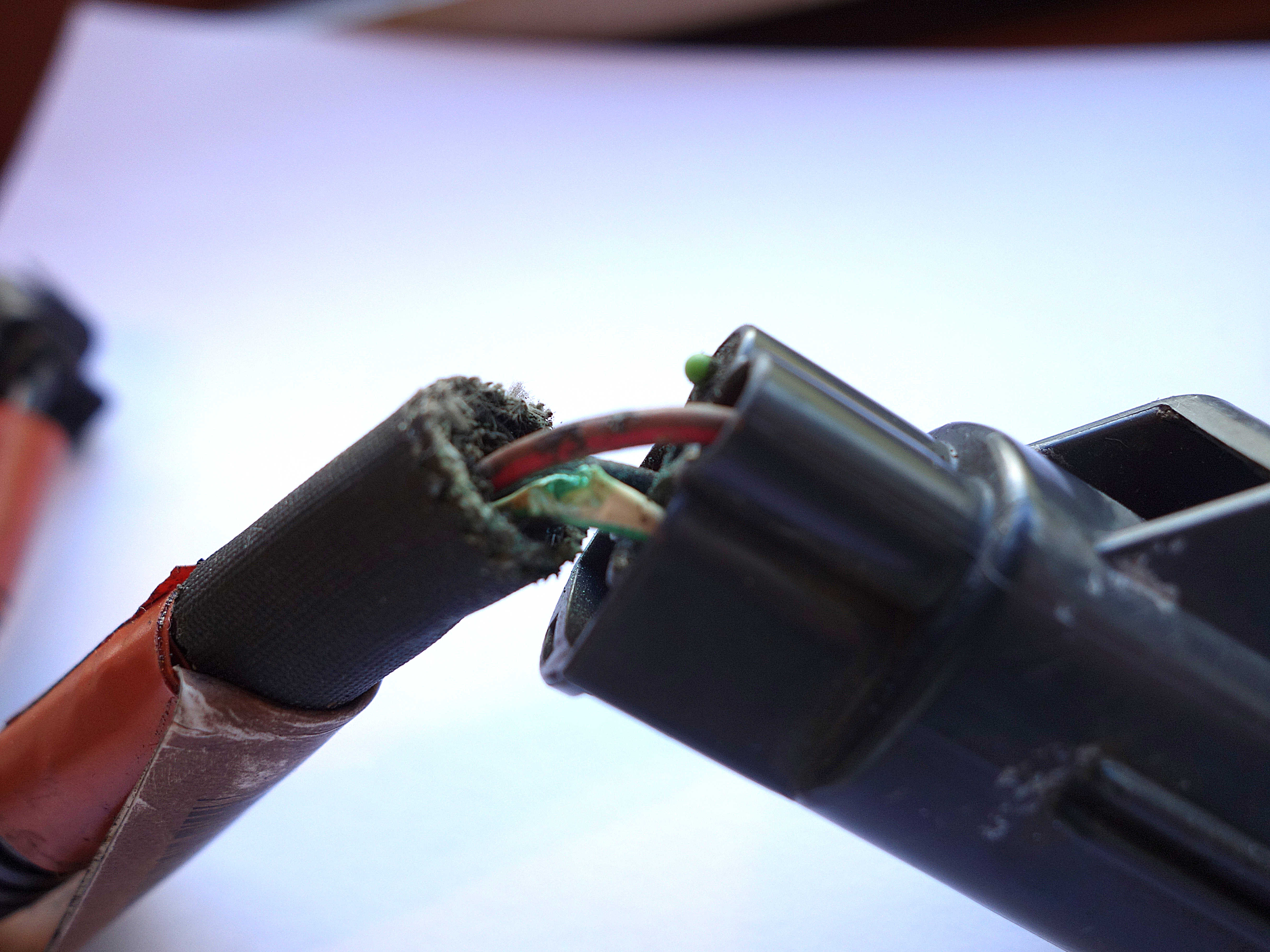

1stly to get at the alarm unit you need to partially remove the fusebox. This appears impossible at first glance, but can be done if you force up the plastic "U' shaped trunking just forward of the fusebox (it is held in place by a plastic spigot pushed into a hole in the metal bracket. Lifting the fusebox should give enough clearance to remove the 3 x 10mm bolts holding the bracket for the fusebox mounting. You can then clearly see the alarm unit and get access to it. The alarm unit has a short connecting cable, approx 6' long with a connector at each end. The cable has a part number 6R8T-9761111-AA and is available from main dealers at less than £10. In my case I found that one of the three wires had chaffed , corroded and eventually broken, causing initially a high resistance joint and eventually an open circuit. This I believe was the cause of the intermittent triggering of the alarm. I have had advise that this fault has been seen before, so it looks like a design weakness in the cable run/protection. The good news is that the alarm did not go off when disconnected. (so presumably could be safely left disconnected if you so desire). I have fitted a replacement cable and the system appears to be operating normally once again.
Hope this helps and I wish you best of luck in sorting out your problem. I will attempt to add a photo to this thread.
