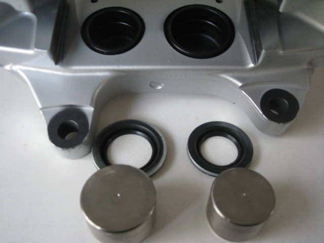

I just happen to have a front Brembo caliper apart in front of me.
The small piston measures 38mm diameter, 32.1 mm tall , the large is 44mm diameter, 32.1mm tall.
The small 32mm seal has 20487245 printed on it and the 44mm has 20487248 printed on it
