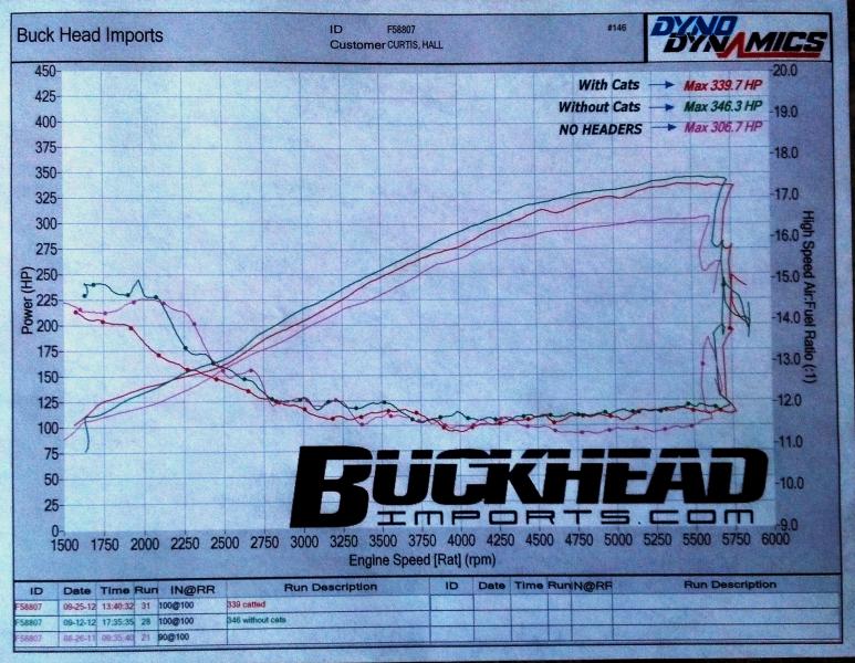

Hi Mike. I don't get how the power goes from 346 rwhp w/o cats to 306 rwhp before headers?

Sorry I probably should have put it in order. Before headers was a baseline run with stock cats (as far as I can tell) and the factory exhaust manifolds.

Originally Posted by B.I.P.
Sure thing here you go Avos!
Attachment 24004
Thanks.
I can also see now why the base run was lower, you see where the mixture got richer, and where the power dropped, the relation is clear.
Can't judge for how much HP loss that would equate, probably somewhere between 10 and 20 or so.
The headers aren’t the cause of the mixture change, I’ll guess it was more related to different circumstances between the runs, or what do you think?
So here are the results with the cats installed, not bad. Minimal loss in power at redline, lost a few in torque under 3K rpm. Any questions please ask. Not bad with 200 cell cats.
-Tony
Attachment 24003
