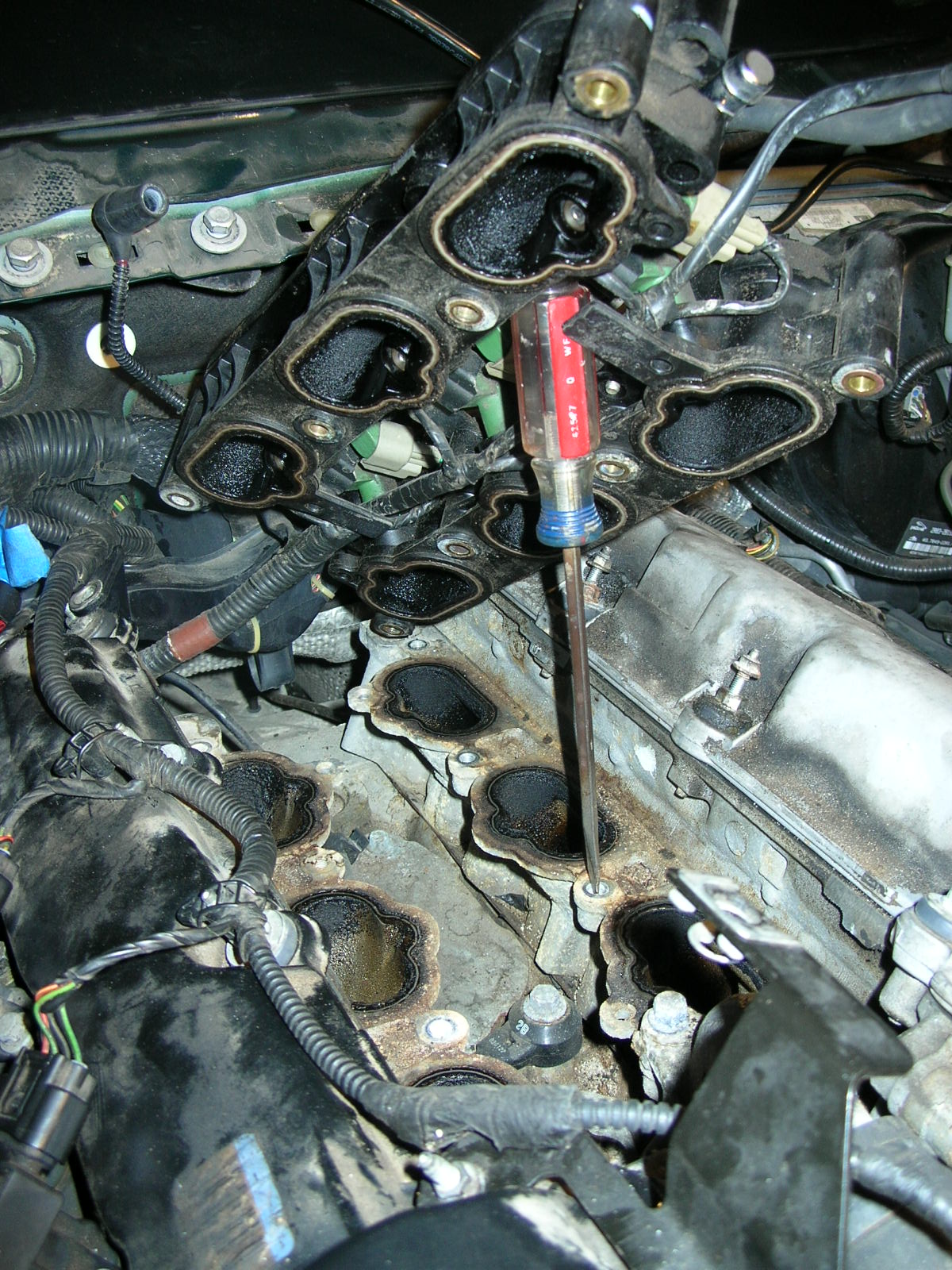

THE ANSWER and FIX
Got the car back with new Jag boxed coils from Jag, however that was not the problem actually, but they replaced due to good faith.
There is a "trigger wire" that connects between 3 and 5 and run around the ecm- it has a plastic wrapping type housing around it. He found it by common sense and moving the wire and get an error on his computer on both 3 and 5. Took off the black plastic, saw no breakage, but had a crimp in the wire- opened it up and the wire was disconnected completely with strands that had apparently been touching but were not now. He said the wire was somewhat crusty. Replaced, tested, stressed, computer diag. all good to go and drives fine.
Could have been a problem from the beginning and not the engine washing. Could have been on the edge and when replaced the first time- it came apart or most came apart- so the strands were only barely touching or not, at some point touching at all.
So there you go until the next problem.

I asked to see it and the mech. had to use a scope type camera to show it to me and you might be able to touch it barely if the manifold was not off. It is near the back of the passenger side. There were 3wires I could see on the scope. 2 appeared green and one had a black plastic protector on part of it. It was the one that had the black plastic protector on it. Possibly Joycesjag might have a picture of it from his work as he seems to have won the race for getting the plenum/manifold on and off.
Tom in Dallas/Plano
