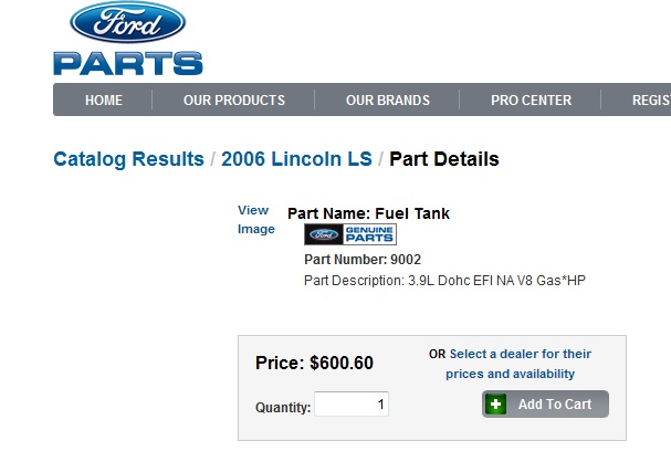

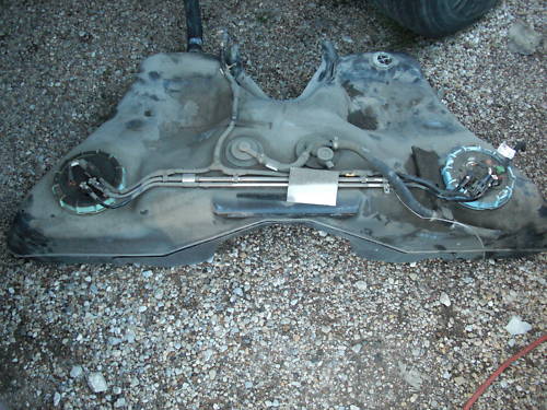

how about a fuel tank for a 06 stype since theyre no longer avail from Jag and Ive got a leaker for 4 months now........what say you andro?????
Well Brutal,
Ford EPC lists part # 1w43-AA or 9002 as fitting 03-06 LS's regardless of displacement, and 03-06 T-Birds. What are the chances of them using a separate tank in the other DEW platform sister car. Found a couple salvage yard images of LS tanks. They use the same primary - secondary fuel pump setup with the one pump to the motor and the other pump to the other side of the tank. Does this look right??
Hope this helps
Take care,
George
