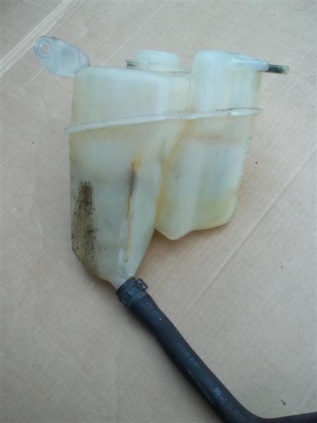

I had a coolant problem in my car last year, the level would be down and I'd top it off. This would happen maybe once every week or so. Then it got worse, but I still couldn't figure out where it was leaking. So I tried a radiator pressure tester and found the problem; which is where I'm am today. There was a leak in the radiator coolant overflow tank, in the back; which you couldn't see, but after pressurizing the system it would spit coolant out on the firewall near the power brake booster. There is a crack in the tank; which is kind of weird (at least to me) to see something like that. There isn't anything even close that would come in contact with it. Is it just maybe a bad part?

Here are a couple of pictures of the coolant tank. The first one is the old tank, with the crack in the corner above the lower hose.
Coolant overflow tank leak, where would you buy a new one?-100_0450-medium-.jpg
