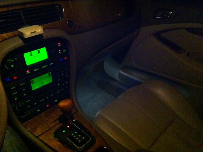

Here's a photo showing the lights with no outside light shining on the interior. The lights are slightly brighter than what they appear in this photo by the way. You can see from the passenger side how the light is perfectly pouring out, going no further than the very top of the seat. The same happens for the driver side.
![](https://www.jaguarforums.com/forum/attachments/s-type-s-type-r-supercharged-v8-15/19309d1336648636-custom-interior-floor-led-pics-2004-s-type-image-4-jpg)
![](https://www.jaguarforums.com/forum/attachments/s-type-s-type-r-supercharged-v8-15/19310d1336648645-custom-interior-floor-led-pics-2004-s-type-image-5-jpg)

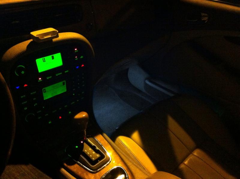

Same areas as the pic above, just taken with different lighting so show how they look. Again, these lights are pure white, but in some shots, they appear blushish white.

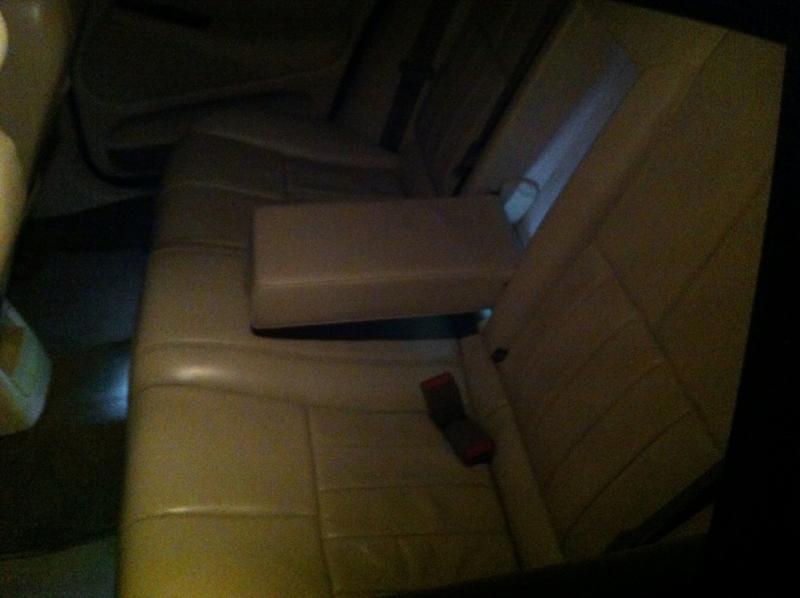

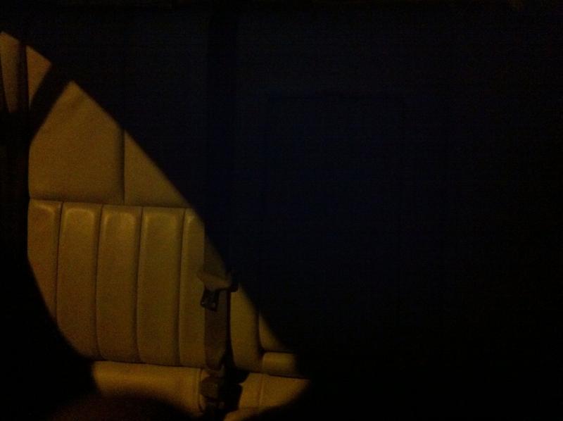

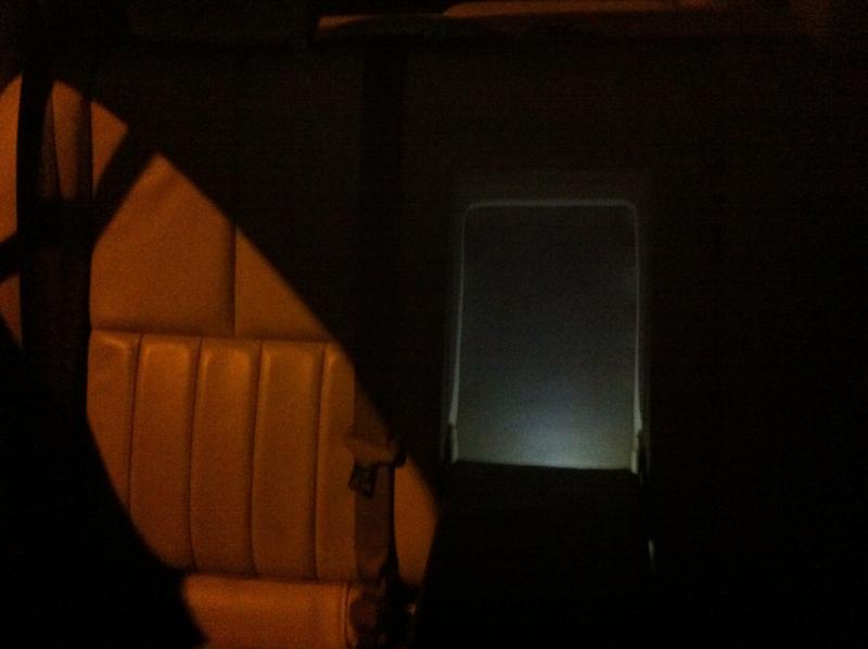

Here you can see the rear seats. The image with the interior lights off is the actual true color of the lights. I installed the lights in such a way that they're completely invisible to the naked eye, you can't see'em at all in daytime. Then, at night, you still can't, but clearly the lights are able to function and do their job perfectly. You also can't accidentally hit'em. I've had the lights in there for two months and I've had adults in the back, kids (nieces and nephews), bags or whatever on the seat floors... they can't be hit the way they're positioned in there. And now onto my favorite part, the rear center console.
![](https://www.jaguarforums.com/forum/attachments/s-type-s-type-r-supercharged-v8-15/19313d1336649058-custom-interior-floor-led-pics-2004-s-type-image-3-jpg)
![](https://www.jaguarforums.com/forum/attachments/s-type-s-type-r-supercharged-v8-15/19314d1336649077-custom-interior-floor-led-pics-2004-s-type-image-jpg)

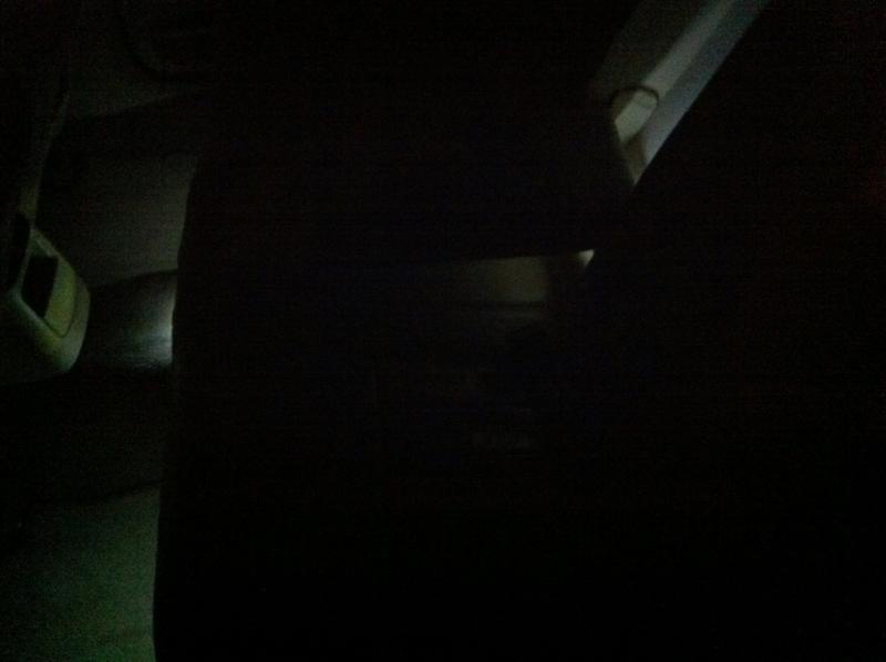

How does the rear center console LED work? *grin* Like a 'freakin' champ, baby. The LED is hidden in the center and can't be seen from any angle. The arm rest can be closed, of course... and when it's closed, no light can be seen. The seats fold down just as they always do. Oh, and every single wire is completely hidden, even when the seats are folded down.

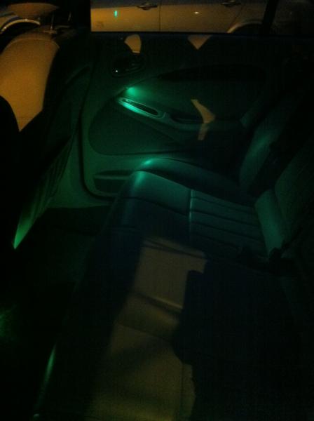

Nice work. I have done something similar but using single 5mm green LEDs (to match dash lights) one in each door pocket (pointing downwards) and above each of the door window switch packs. These are also dimmed with the dash lights.
I intend to change the little orange downlighter in the overhead console for a green LED in the next couple of weeks.

Thanks. I'd thought about doing lighting for the same switch area you mentioned, but I wasn't sure how I'd hide the lights to be invisible to the naked eye and decided against it.
So how do your green LED's look? Post up some pictures, I'd love to see'em. And include some taken in the day light, particularly the switch areas.
Ok, lets see if this works, haha.
The effect is more subtle than it appears in the photos. The glow is more spread out, not as harsh, or as bright as it looks.

All the LEDs are installed using a 6mm panel mount (5mm LED fitting)with the long outer legs cut off (panel fixings) and superglued in place. There is enough give in the padding to allow for flush fitting.
The only problem is, I have five left over and am itching to find a use for them.
