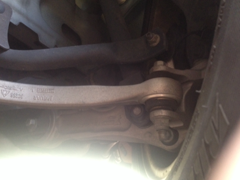

I drove a bit today and it squeaked the entire time -- I got home and pushed on the front end and it seems to be driver's side -- so, I sprayed PB Blaster on the lower wishbone part depicted as #6 in the diagram. I'll let you know if it helped.
Here's a really poor photo of the part I sprayed - it's in the lower left of the photo. That's should be #6.
![](https://www.jaguarforums.com/forum/attachments/s-type-s-type-r-supercharged-v8-x200-15/62068-front-suspension-squeak-70b0b87f3d3c593000c7088a7277408d_zps8f67e860.jpg?dateline=1384101148)
BTW As soon as I sprayed it, I pushed on the front end and didn't get any squeaking unless I pushed somewhat lightly -- i.e. heavy rocking doesn't make it squeak, but short, little pushes does.
I'll let the PB Blaster soak in and then drive it a bit and see what happens.

After spraying the lower wishbone bushing with PB Blaster, it seems to have quieted down a lot, but not gone. I might try spraying a bit more and even doing the other side.
Re the upper wishbone -- I've looked at the diagram and can't seem to find a bushing for the area where I seem to be missing one! Is it part of the bolt, maybe?
