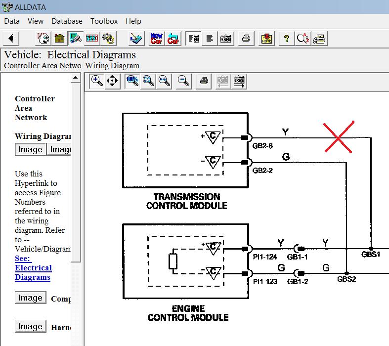

TCM not communicating with ECM (CAN problem)
I hope you like picture of "upgraded" bolt.
Old 01-27-2016, 03:04 PM
car5car's Avatar
Join Date: Sep 2008
Location: Florida
Posts: 913
Received 70 Likes on 66 Posts
Yellow wire is broken!!!!!!!!!!!!!!!!!!!!!!!!!!!!!!!!!!!!!!!!!!!! !!!!!!!!!!!!!!!!!!!!!!!!!!!!!!!!!!!!!!!!!!!!!!!!!
I hope this is the reason I bought the car so cheap.

Did that fix your problem?

It seems like problem is gone, no transmission codes. I need to check/add transmission fluid and drive it.
