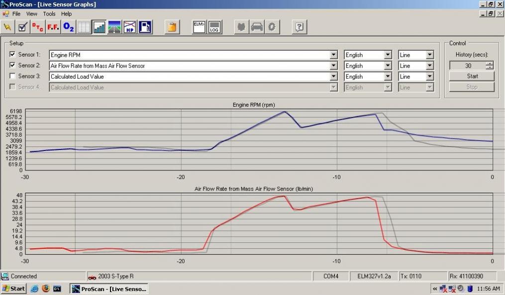

Very interesting thread. What software and reader do you use to pull out these numbers, blaksplash? It would definitely be helpful for me, and I assume many other people, if we could know what you are using so that we can all monitor our numbers.
I wonder if my car will read that it is taking in a little more air as I have a pulley. Your car has the factory pulley correct?
I've got an ELM 327 obd II reader - and i've been using ProScan to pull the stats.

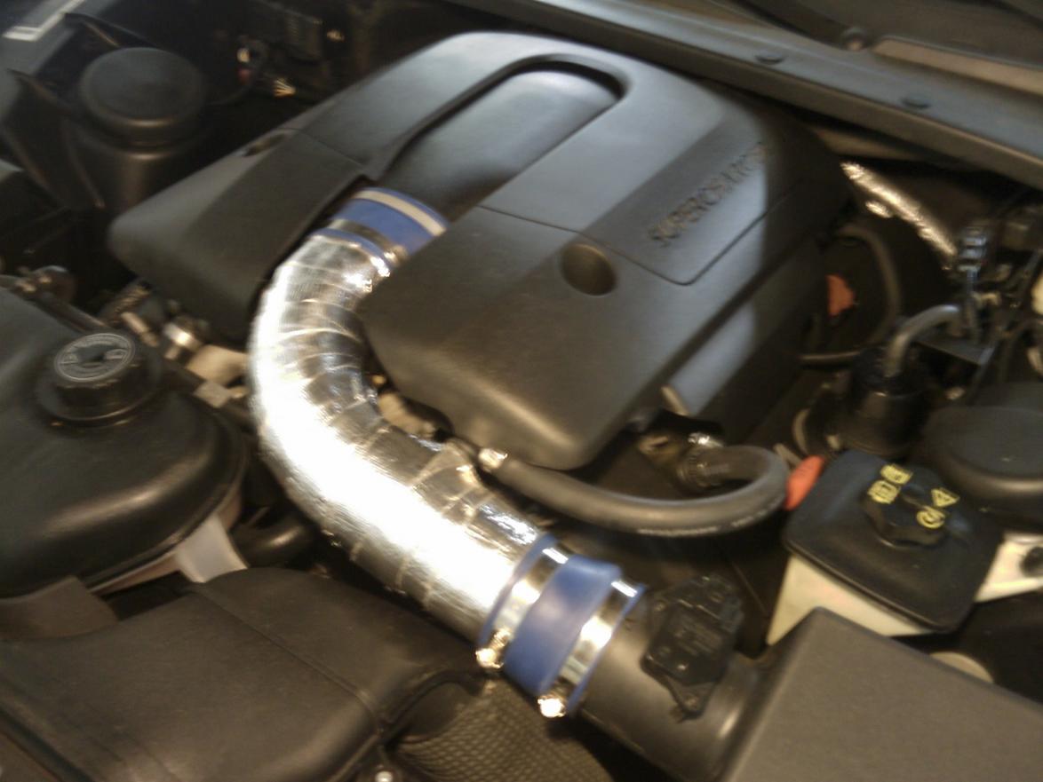

Ok, i got the breather hose connected to the intake tube, and i wrapped the aluminum pipe in heat retardant wrap. Here's a comparison SS... factory tube are the gray lines, new tube is in color.

it's been about 12 days and so far no check engine lights...
here's the finished product

Very cool. Did the heatwrap make a difference on any of your temperatures?

Looks good, just one more thing, the tube you are using as engine breather seems to have a larger ID than the original. This could cause an imbalance in the vacuum/overpressure of the engine, and could cause a higher oil consumption. Better to use the original tube, or one that offers the same amount of resistance, try blowing thru it and see if you have a difference between the current pipe/connection and the original plastic ribbed pipe.

Very good point..
to the touch it does feel cooler after driving, however in reality according to the scanner, not much difference in intake temps.
Andre.
the tube is larger, but where it is connected to the new aluminum tube is the same size

blaksplash, I was reviewing your OBD scans using the Proscan software and I have become a little unsettled. Your car seems to be boosting pretty well (14PSI). The only thing is, you have the factory pulley correct?
I have been using Proscan to monitor my car, which has the 1.5lb pulley installed, but have only managed to get 13.5psi. I have spiked at 14psi of boost but during a 0-150 run, I monitored a consistent 13.5~psi (give or take 0.2).
When you get your pulley installed, please make note of your boost increase. I was expecting to see 14+psi of boost on my car....now I think I will have to go deal with the Mina Gallery for false advertising....
Yup, i'm still currently on the factory pulley. Before i do the pulley swap, i plan to get several baseline readings- intake temperature, manifold pressure, engine coolant temp (i'll be adding a lower temp t-stat along with some water wetter), & MAF flow rate.

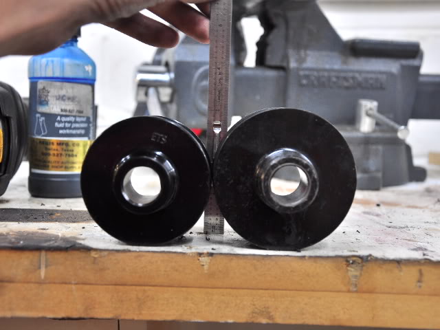

I remember you mentioned getting this upgrade and dynoing the car. Were you able to take pictures of the supercharger being shaved down? And how tough was it?

Was not the most fun of processes, shavings everywhere, this was close to being done before we smoothed it out. used an air tool to slowy grind away and also created a template that screwed into the shaft to make sure it was even all the way around and had enough clearence. When we pulled the old pulley off (with the removal tool) it got a little damaged due to the pressure so we wanted to make sure we didnt have to put the new one on and then have to pull it back off. I will post the rest later this week.
new on the left

Awesome pictures! I am definitely looking forward to your upcoming post about all your modifications.
